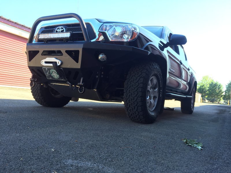

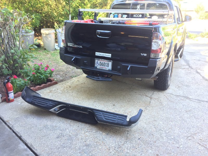

    Boy thats a good looking bumper!!!

    Thanks, I like the strength of the steel. But I kinda wish I'd dropped the extra funds on the Aluminum instead. The steel dropped the front end nearly an inch from the weight, and I can tell how it's affected my braking distances.

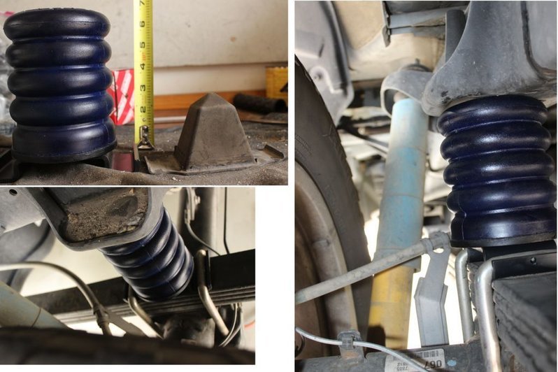

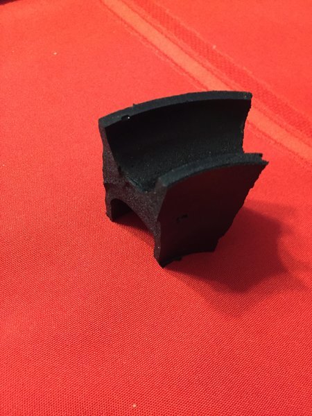

    For those with a lift looking for a taller sumo springs, the Tundra springs seems to be a bit longer from this pic. I believe these are the SSR-610-47.

    It should be noted that the tundra model has a higher weight rating and appears to be a harder durometer

    The Tundra and the Tacoma actually uses the same part number (40) though the heavy duty (47) has a higher load rating and more stiffer. Too bad they don't make a similar product for the fronts bump stops.

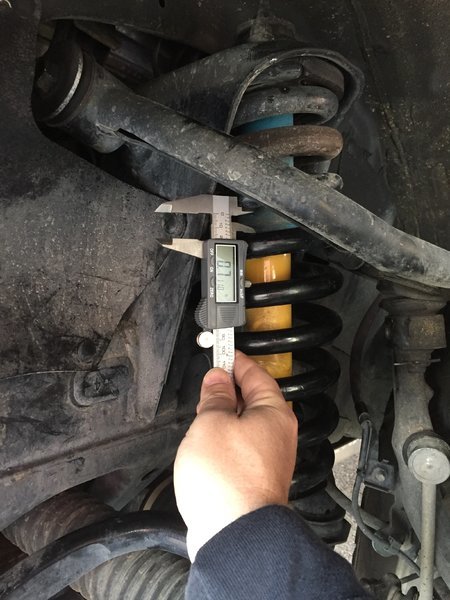

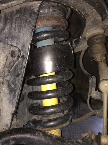

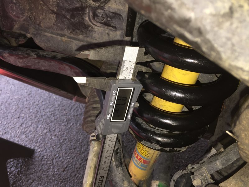

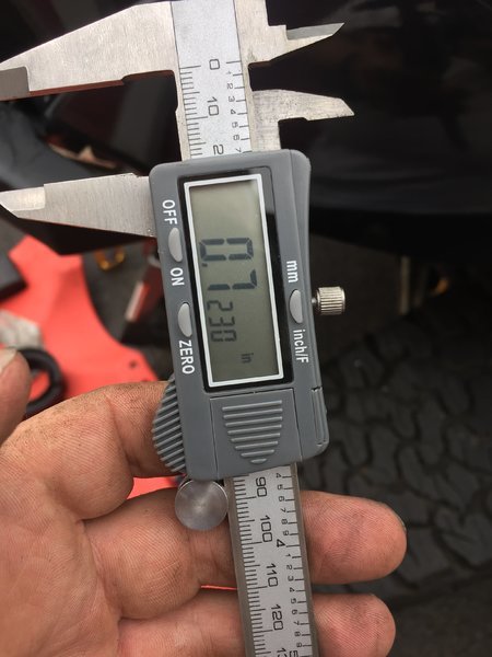

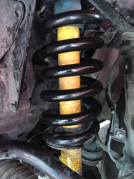

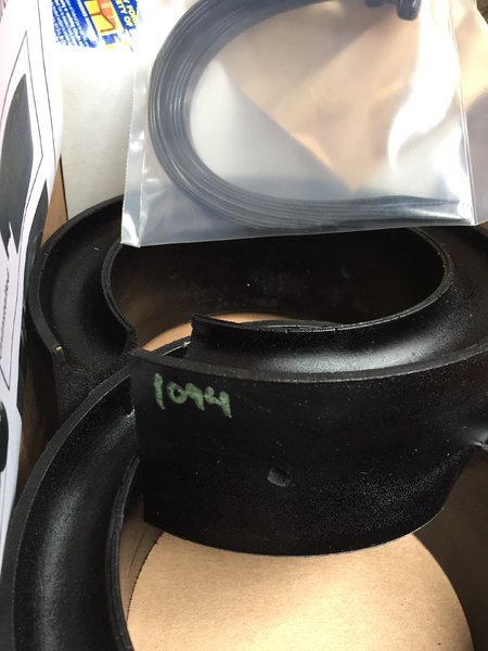

    I attempted to install the front coil spacers, but no luck. I did get a reply from supersprings. They said they had never had anyone with the issue I'm having fitting the 1094's in a Tacoma. Based on the dimensions I sent them, they say I need CSS-1069. I don't know which model the 1069's are supposed to fit, but I'm going to see if I can exchange the ones I have for the ones they say I need with autoplicity.

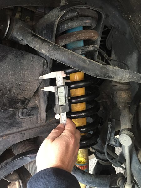

    If any of you happen to still have stock suspension up front. I would appreciate it if you could count the number of wraps you coils make and measure the 3, 4, & 5, gaps with the suspension at full drop. Mine measured .711 upper middle 3rd gap, .734 middle 4th gap, & .681 lower middle 5th gap. I'm kinda curious if I have different springs than most Tacomas or something. I did try dropping the swaybar, but that only got me anther 1 hundredth of an inch woopie...:smash::help::annoyed:

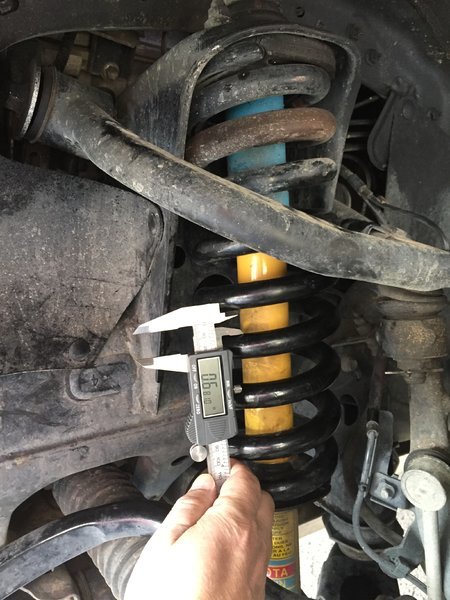

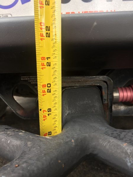

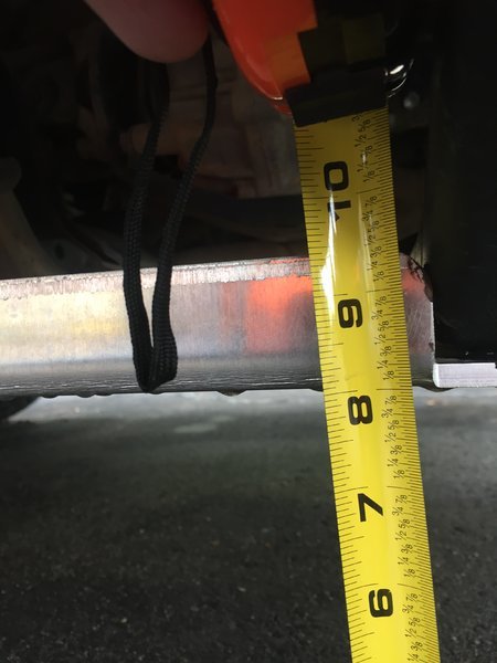

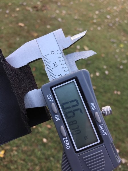

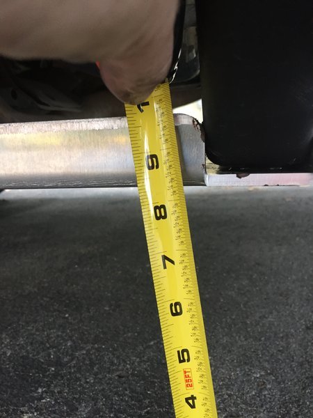

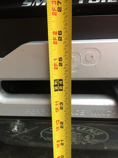

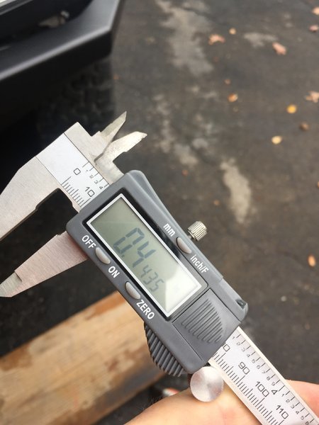

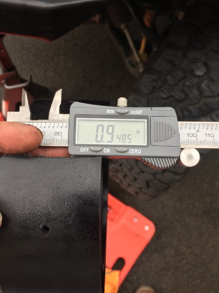

    So I got the front Sumo coils installed yesterday. The part number I ended up using is CSS-1069, which is supposed to fit the 2012 Tundra Limited. I do recommend taking your own measurements, filling out their inspection sheet, and send it to their sales folks. They can make sure you're getting the correct park before you start, based on actual measurements. There was a bit of an overlap for my springs, so I had to trim 1.5" from each side. All you need is a sharp knife to cut through the Sumo coils.
    Again, I measure the height of front, the Xfer Case skid, and rear hitch before I started. They were as follows. 25 3/8", 8", & 20 5/16".
    Compressed the space between my springs measured .4435", the Sumo measured .6870". That's a .2435" difference.
    Installed it raised the front 3/8" & the Xfer Case skid 1/4", and lowered the rear hitch 1/4"
    So far, the ride is just fine, and I think the handling is deffinately better. My headlights are projecting a little better, though I still may go ahead and adjust them up a bit, as the rear Sumo's provided much more of a lift than the front did. Since I did the rear springs I also added a rear FabFours steel bumper. That's an extra 80lbs hanging off the back, and it only dropped the rear 1/16".

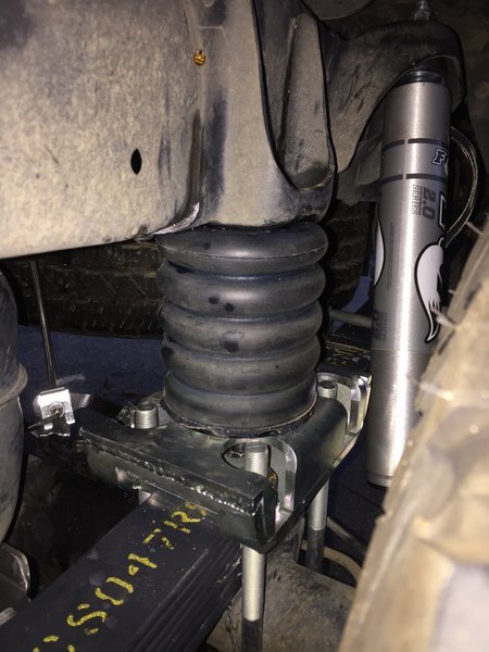

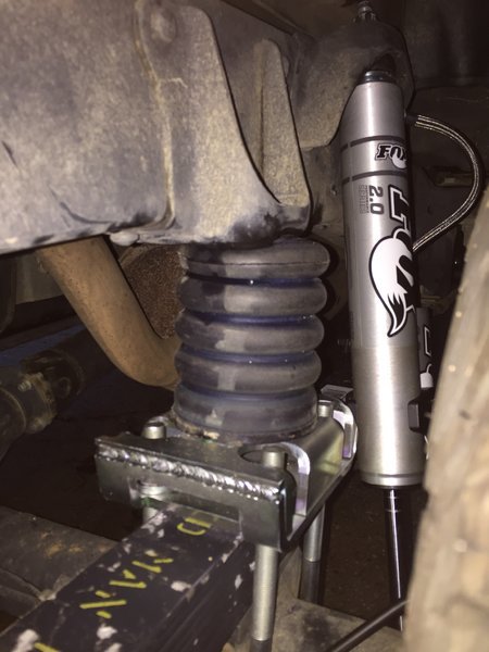

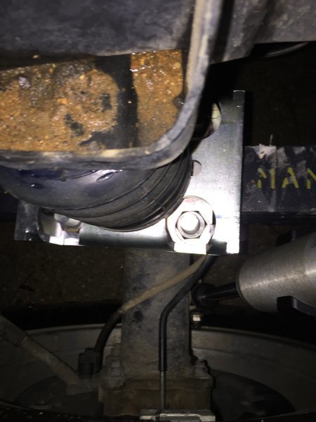

    Installed Dakars springs on the truck. Kept the Sumos for my rear bump stops. I got about 2.5 inches in lift from them. I combined the Sumos with the U-bolt flip kit from LowRangeoffroad. The top plate is about 1.5" high. The two combined just touches the upper bump frame, as it sits in my daily driver configuration. When I add my camping gear and RTT, it should carry the load fairly well.
    http://www.lowrangeoffroad.com/low-range-off-road-ubolt-flip-plate-kit-bumpstop-style-tsp-bsp.html
    Driver side
    Passengers side
    Passengers side
    Driver side

    This is exactly what I was thinking about doing without actually looking for it being already done.
    Full dakars, ubolt flip kit with sumos.
    Thank you very much. I can't think of a more beefier rear end.

    Although I noticed your sumos have 5 ribs instead of 4 which I thought was the regular size for a Tacoma. Do yours happen to be for a Tundra? Or am I going off stock images online and completely wrong.
  18. Jan 2, 2017 at 7:10 AM
    #98
    KRAMERICA
    KRAMERICA Old Man Mike
    Mar 22, 2015
    #151504
    3,882
    Middle Tenn
    '18 F250 Super Duty
    A couple of rear window decals...
    My Sumos are for the Tacoma. I haven't loaded it completely yet. Only got my basic daily load of 300-500# that's always in the truck. I've got ICON 2.5 Coil-overs with 700# springs in the front and FOX 2.0 shocks in the rear. So far the ride is pretty good, a lot smoother better than stock.

    I lifted my back with icon aal and installed sumo the problem is the same I have space between them and the frame. I'm not sure if this will be problematic. Anyone else running the same setup?

    Should be fine. As you put weight in the back thye will make contact and carry some of the load. When your Off-roading they'll work as bump stops to keep you from bottoming out.
