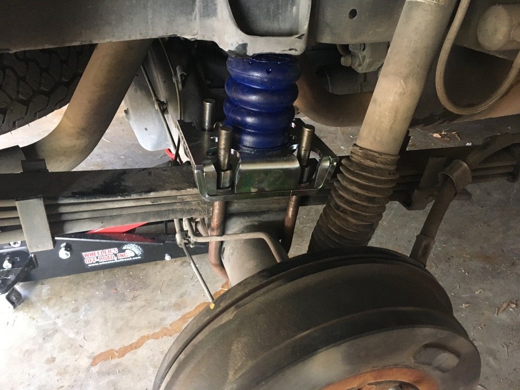

    Here is my Low range off road flip kit the Sumo's were drop shipped so not from Low Range but only 4 ribs. BTW my truck has no lift in this pic but when sitting on all 4's the Sumo's were about 1/16" from the stops....
