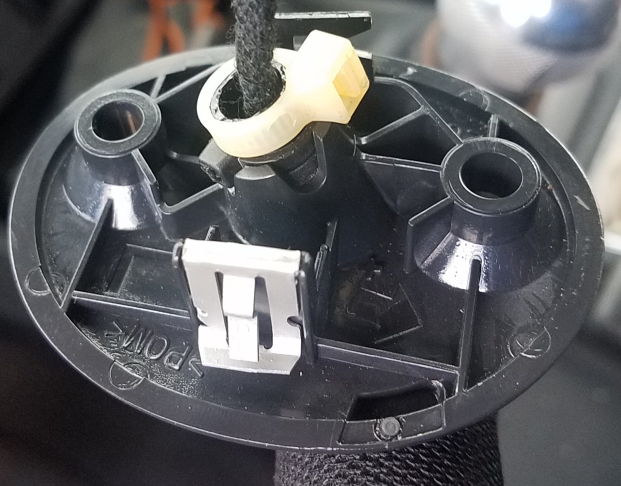

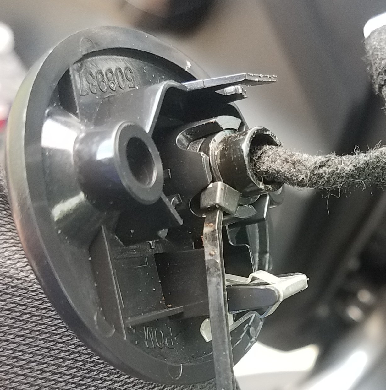

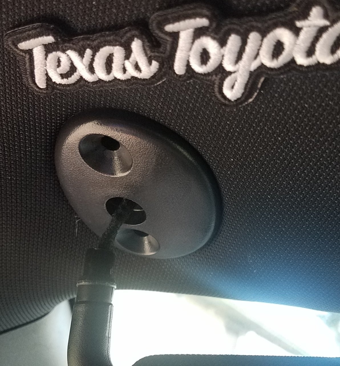

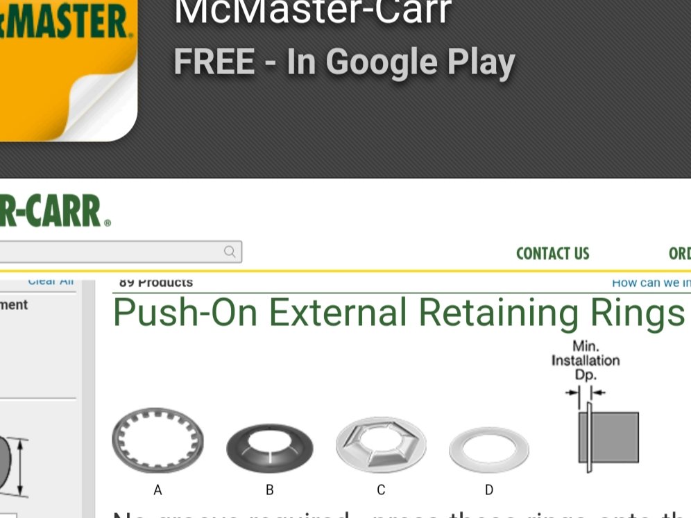

    Mine has fallen one or two times. Mostly when pivoting to cover the side window. Decided to pull it down & have a look. Like some have mentioned earlier in here, I was hoping it was just a matter of pushing it up enough to "clip"in. Ended up adding a small zip-tie around the shaft to add some resistance from it sliding down. Also added a medium size tie above the black one. Have used it every day now on purpose to see if it'll fall. Going on 2 weeks with no issues.
    Meant to add this info also.
    Someone on here also mentioned using an internal washer as a solution. If the trusty zip-ties fail, that would be my next try. Pic robbed from McMaster-Carr.

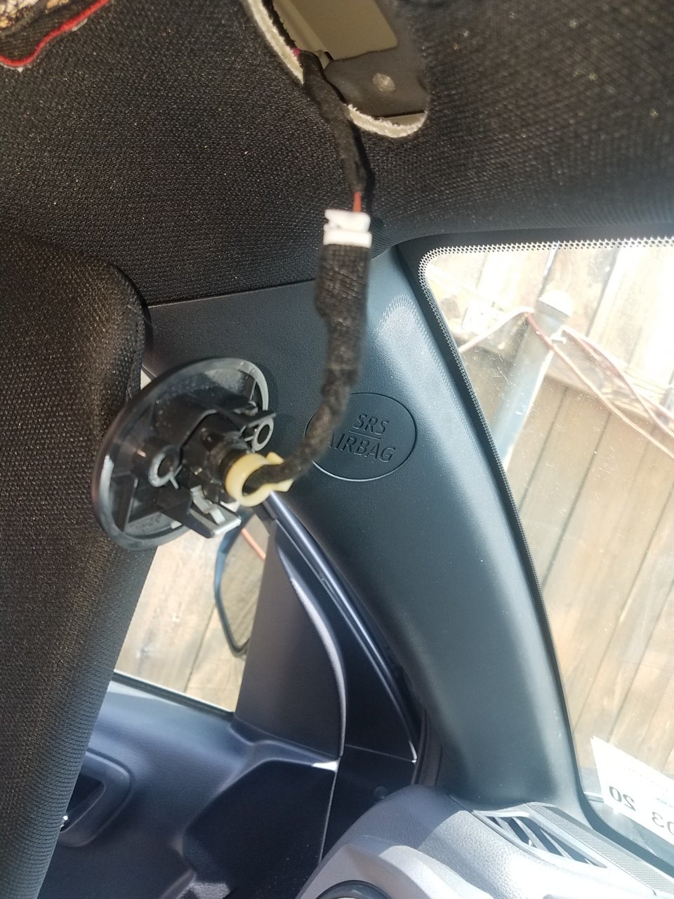

    Does that braided cable contain wiring for lights? Trying to see how difficult it would be to swap visors on my SR and there are very few pictures out there on this assembly. Thanks

    Yes on the wiring. But there is a disconnetable plug right there with it. I was able to take the whole assy. off to work on it.

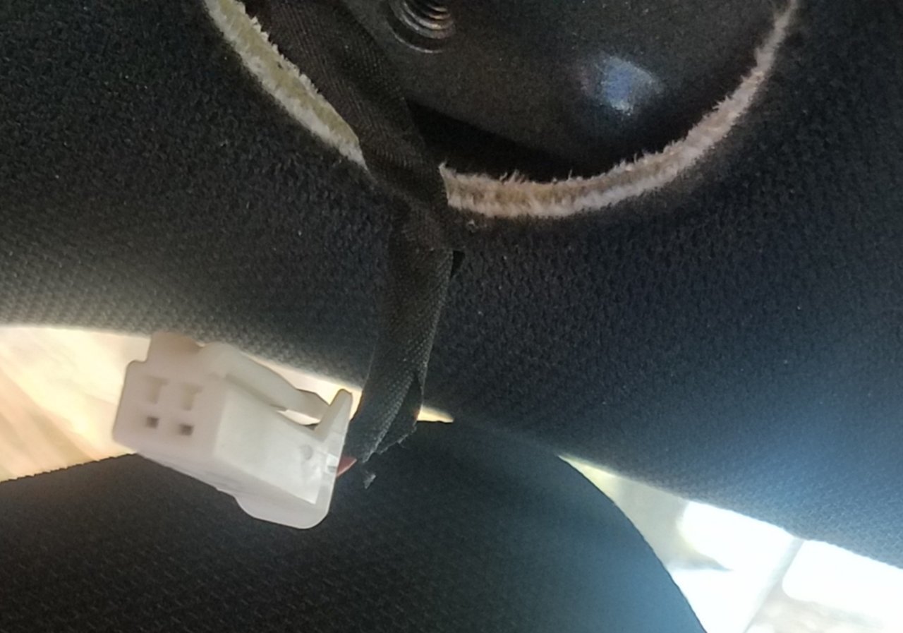

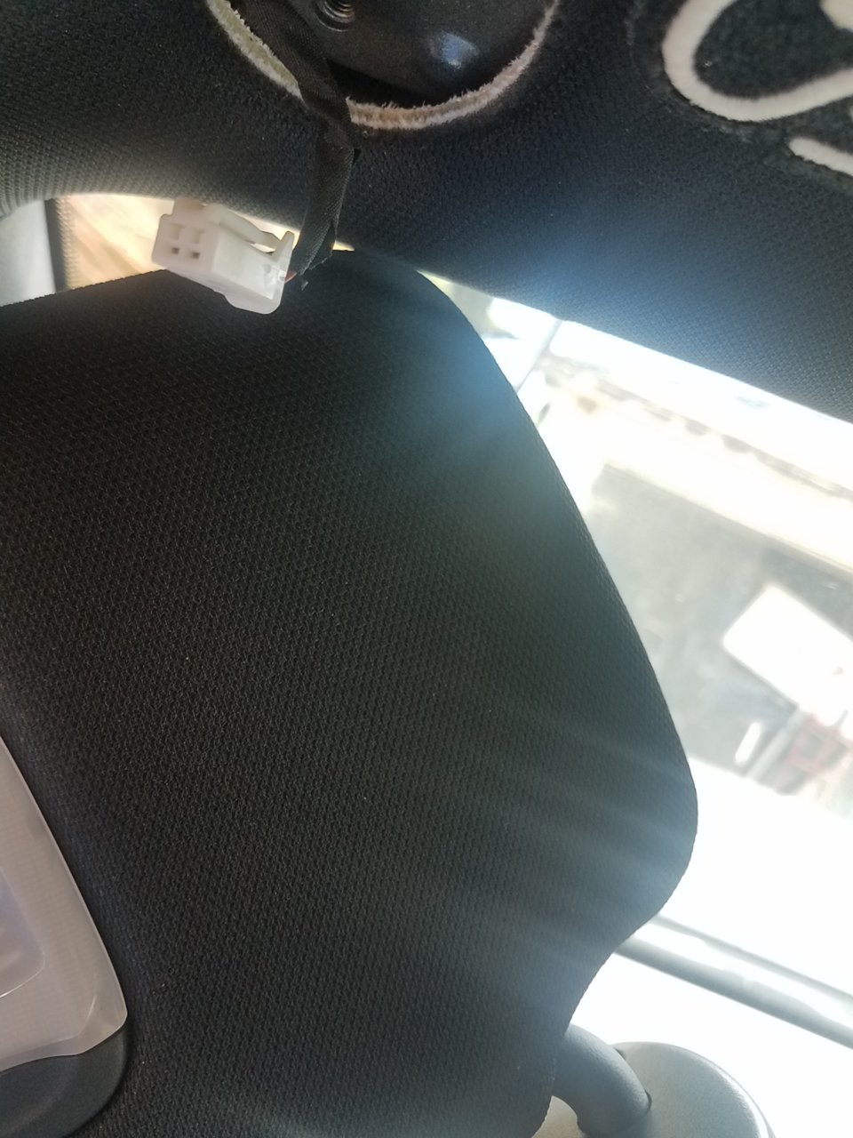

    Just went & popped it off for a pic. 2 wires on the plug.

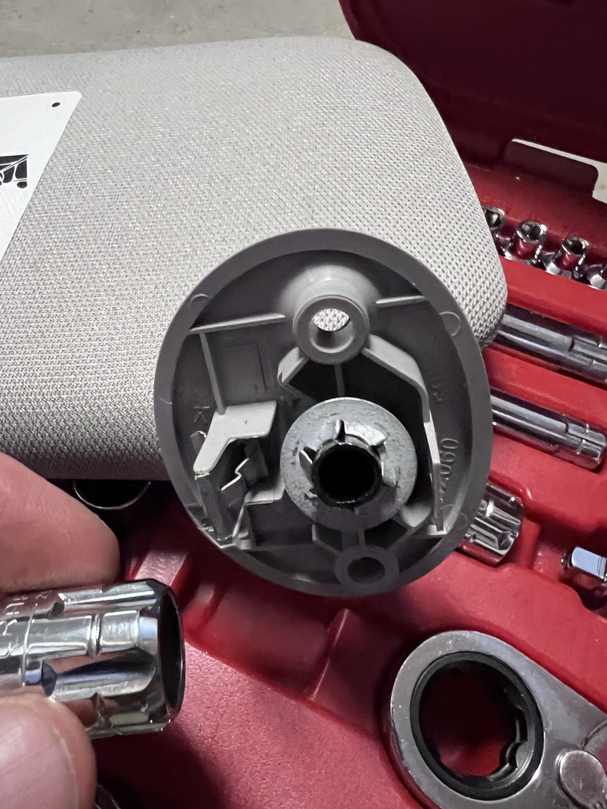

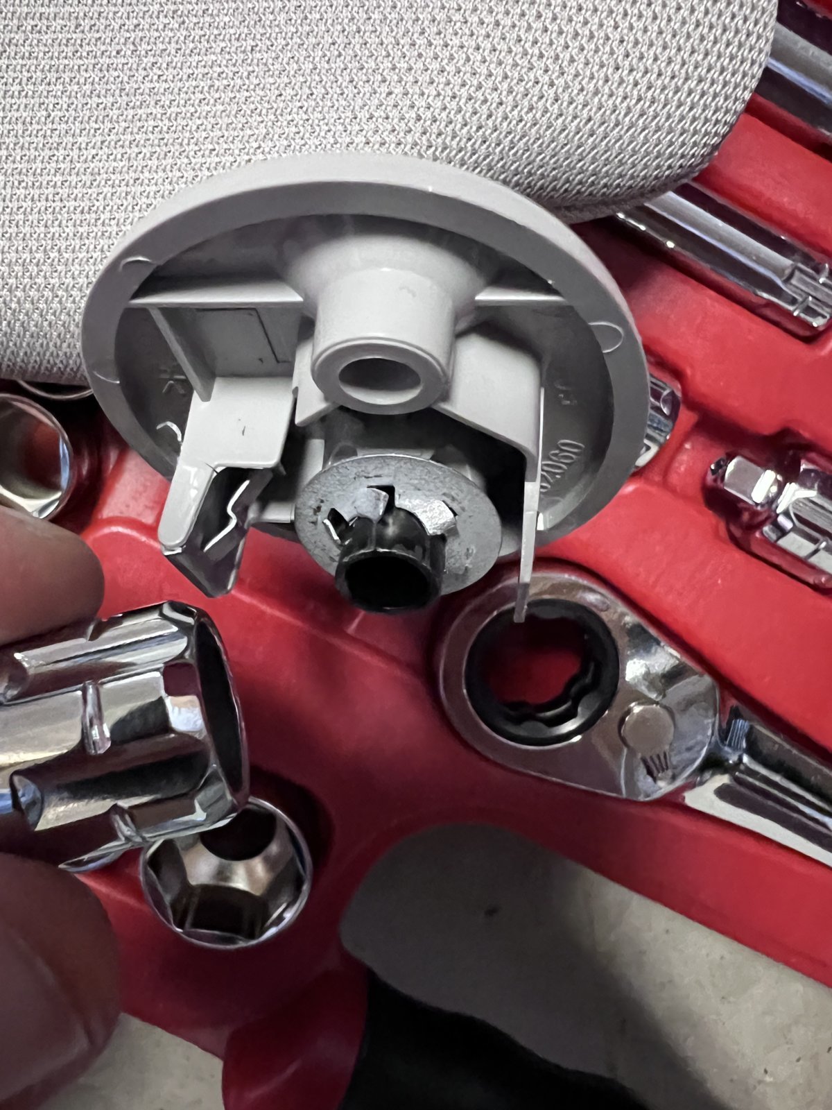

    IMG_4939.jpg IMG_4938.jpg I fixed this for 37 cents. I used a socket to press it down after a test fit in the hardware store. Whole project took under 5 minutes .
