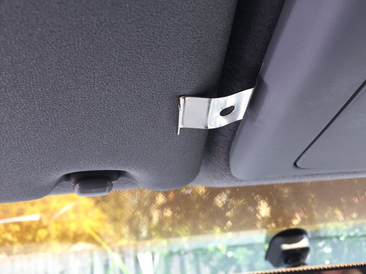

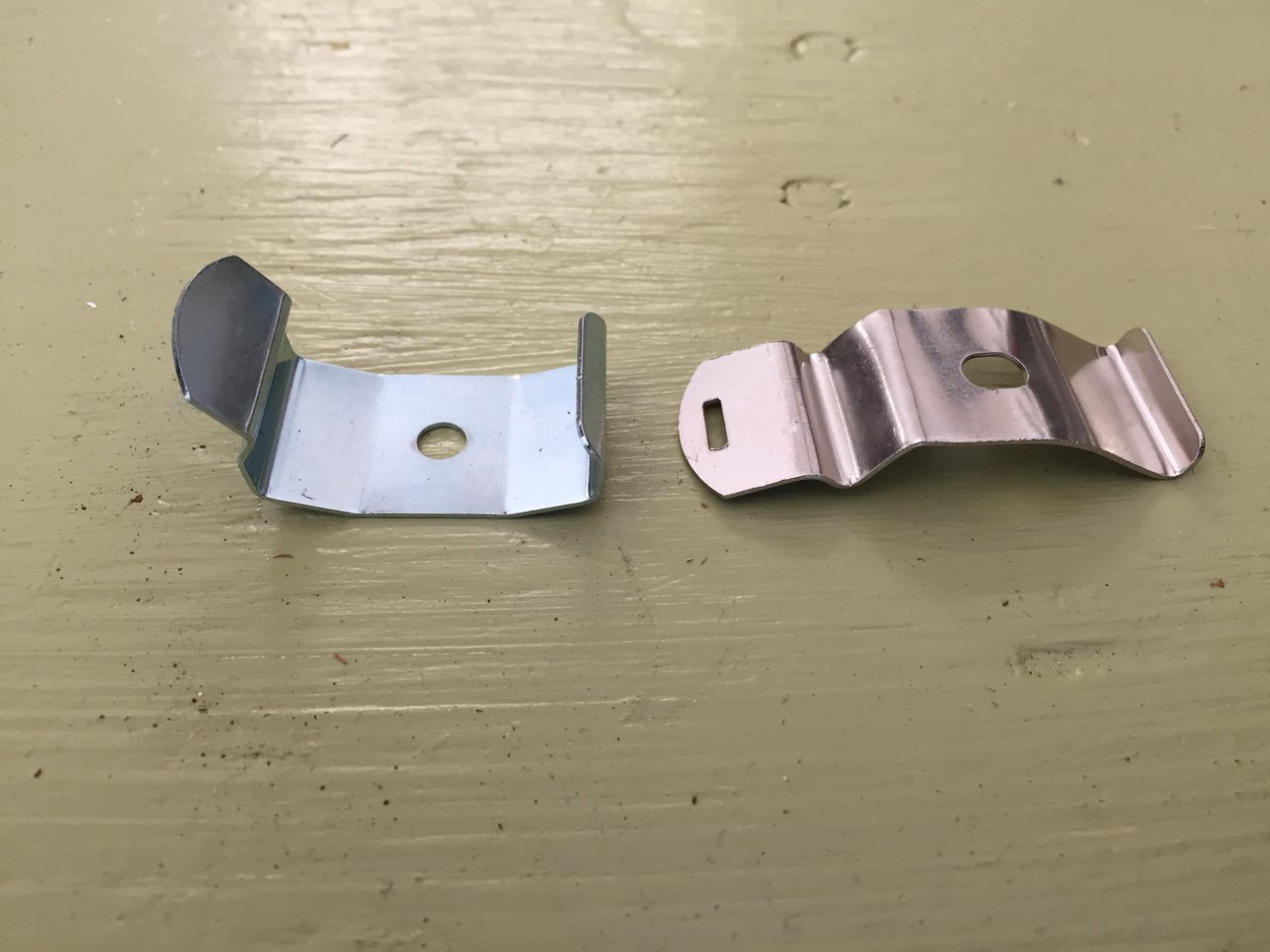

    IMG_1396.jpg IMG_1396.jpg IMG_1397.jpg Thanks for the great idea to use a stick. I tried hot glue to rejoin the broken plastic piece with no luck, so rooting around my garage I found clips used to mount vertical blinds. With the stick as inspiration I bent the clip to perform the same function. So far so good.IMG_1396.jpg

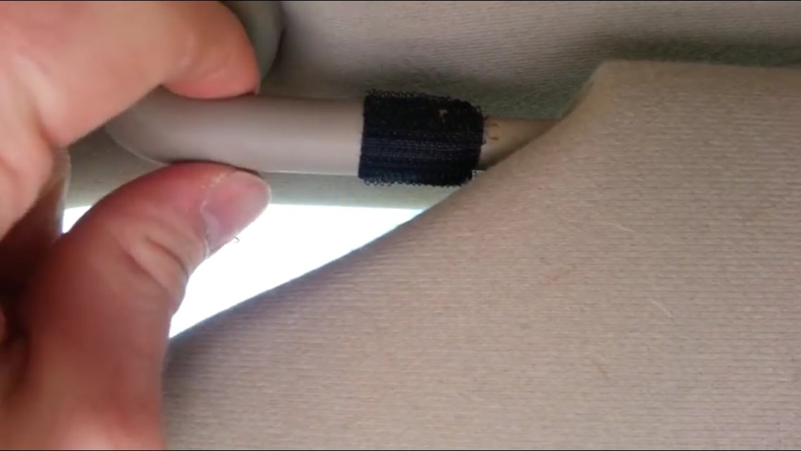

    IMG_4950.jpg If you get Velcro (sticky part)and wrap it around the shaft that goes into the visor. Shove visor back into shaft. It will hold nicely for you.
