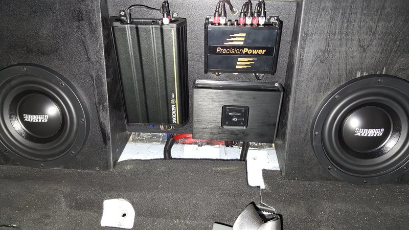

  12. Jun 2, 2016 at 8:59 PM
    #92
    Zac of all trades
    Zac of all trades [OP] FWP Fabrication Vendor
    Jun 9, 2015
    #157073
    8,877
    Zac
    fwpfab.com
    2013 4x4 Locked DCLB
    886/5100s/AAL/UCAs/360 armor/RTT/295 17s
    Haha. Installed...yes tuned... he'll no.
    I'm actually experiencingredients a problem with the sound processor. It was working amazing and then no sound from my mids, and if I go to a different preset then no sound.
    So I got that going for me..
  13. Jun 3, 2016 at 8:09 AM
    #93
    Zac of all trades
    Jun 9, 2015
    #157073
    8,877
    Zac
    fwpfab.com
    Got the sound coming out of the door speakers but nothing from my subs. I am calling precision power today to see if they can offer any help with the matter.
    I have a base line tune. Frequencies are set close but need to be tweaked a bit. They sound very good, but Im going for amazeballz!

    Installed... not working...
    I called precision power today and talked to tech support.. he said it sounded like a defective unit due to the behavior of the device. I ordered from Amazon so we will see what happens.

    Are you SOL since it was a scratch and dent unit? Have you tried switching the subs to a different output channel that was working for your speakers? or do you have the sub output channels linked to an input? I'm sure their tech support went through this but its worth a shot instead of forking out for a new one.

    No i processed a return with Amazon and they are refunding my money.
    The sound is wired correctly, however the issue is that when setting up the DSP sometimes the sub channel will play, and most of the time it does not. Im hoping that the new unit will not have this issue. Im considering un/re installing the software on my PC just to get a good clean start!

    So i figured out that my sub amp was the problem... The remote gain control wire was pulled tight and i believe that it may have messed up the port for the remote. I tested the RCA cables and they work, so that makes it the amp and thought it was the RCA inputs. Then I pulled out the remote gain wire the subs played but with very low power. If the remote wire is halfway plugged in then the subs play with full power but the remote does not work, all the way in and no power...
    Right now i have a 600w amp powering the subs. The remote wire works fine so that tells me the problem is with the amp and the remote wire port.
