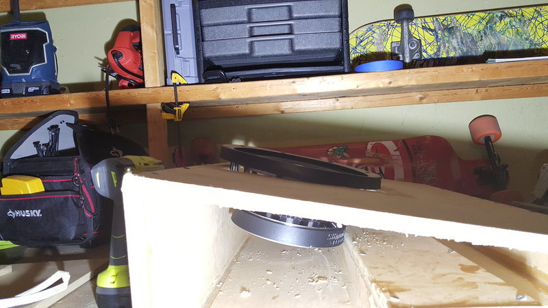

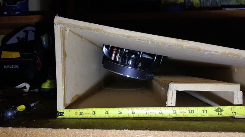

    I used birch for mine. 3/4" MDF is recommended for sub enclosures. Anything less is too weak... the real concern is will the magnet hit the back channel piece? I cut my hole pretty low because the magnet on these are very big!
    Here are a couple images from when I had a solo baric l5. I cut a circle to see how it would fit. It did not fit because of how big i made the channel in the box. Obviously this was a terrible box...

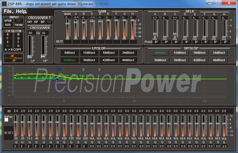

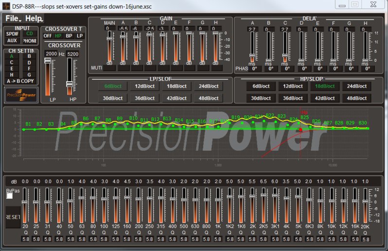

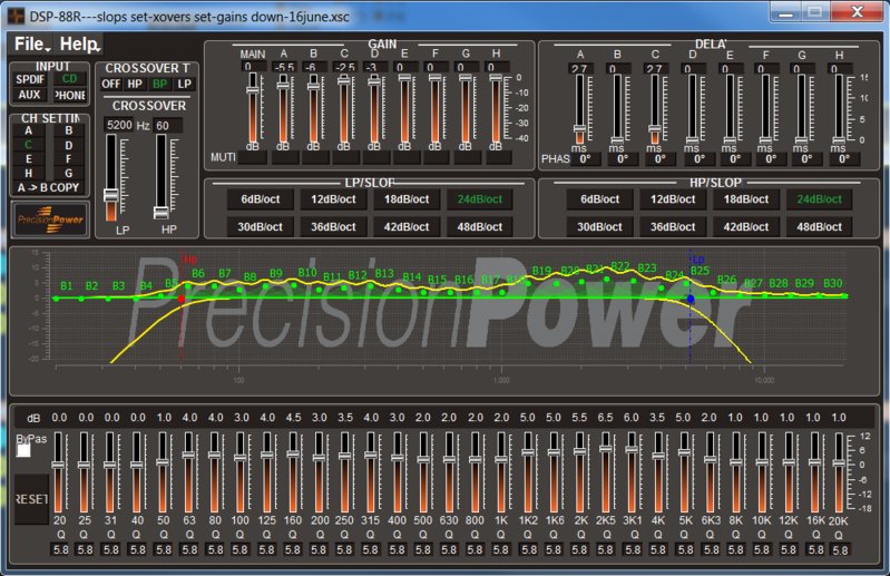

    Ok so more tuning has been done. The gains for the highs have been dropped alot, the crossovers & slopes are set where they need to be, but still needs some more love. I will get a new video up with the same some to compare the difference to.
    Here is a pic of what my settings are at now...
    Tweeter settings...
    Mids settings
    Sub settings
