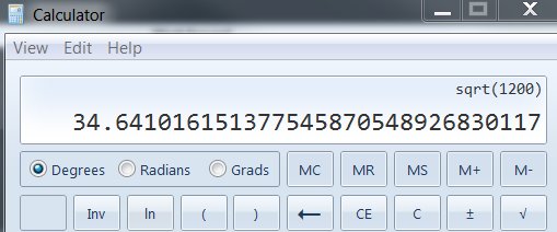

    Setting the gains is really all i have done to the amps. I used the ohms law equation to find the amount of volts to set the gains at. For the subs amp i did 600w rms x 2 ohm load = 1200, then you take the square root and that gives you volts, in this case its... 34.64 volts. I did the same for my front stage amp also.

    Doesn't that amp make 1200W@2 ohms? 1200x2=2400. Sq root of that is 48.99v.
