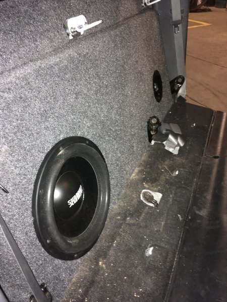

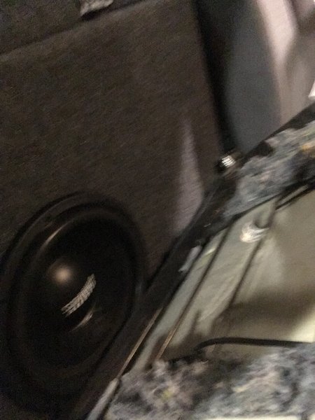

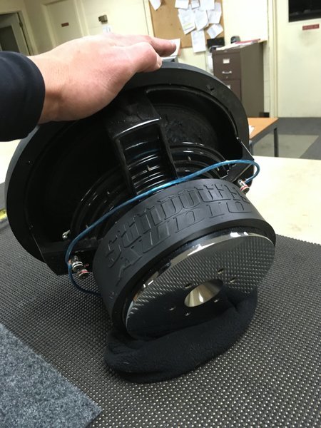

    Mounted the SA-12 wired at 1 ohm on a Fosgate 1200. Stock head unit with a recurve, JL on the doors. Loving it. Best $200 ever spent.

    The three subs have been replaced with one 2.25 cubes with a three inch flared port.

    what is the mounting depth of that sub?
    Also how close does that get to hitting the back of the seat at full excursion?

    My hell do your ears bleed? o_O Those subs are monsters. :eek:

    Mounting depth is 6.5 and no contact with the seats. The seat plastic has been removed.

    Sealed box or ported? Ive been thinking about stepping up to some 12s

    There is 4.55" of three inch port. It is flared so the overall port depth is deeper.

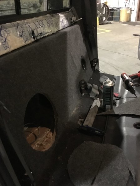

    Wow that is a massive box. Did you remove the rear cross support bar to make that fit?

    No, just used fiberglass to form around the support

    3 inch port is not near enough surface area for a 12 mate, thats only 7 Sqin of port
    I wouldn't recommend being under 20 Sq in of port area for that 12.

    Could that port be feasibly made in that enclosure? I'm still skeptical on the idea of putting an SA-12 back there. Never thought it could be done until I saw this honestly.

    Just for you bro, did it this morning. 30 inches of port tuned at 35. Fricking huge pain. Gained 5 db's
