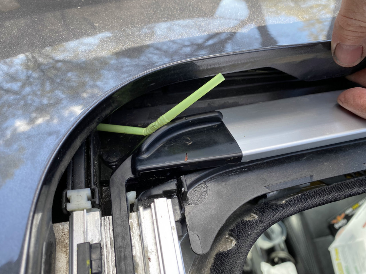

    My 2017 Tacoma has drain holes in the forward corners. These probably drain through the A-pillar and out the bottom of the truck.
    Parking under trees allows debris to collect over time and clog these holes. My driver side is clogged. Carpet is wet, and heavy rain makes it worse. Right now, there is a pool of water in the driver side forward corner of the sunroof gutter.
    I will try to unclog it with a coat hanger or such.
    I've had this problem on a Saab 900, and if you let it go long enough it will spill over into the car's interior.
    Also try compressed air to blow out the tubes.
    Good luck.

    Follow up: clog cleared using weed eater trimmer line. About 4-5 inches in and water drained quickly.
    I then inserted a plastic straw to blow it out. See photos for driver side drain hole location. Passenger side has similar drain.IMG_0148.HEIC.jpg IMG_0147.HEIC.jpg
    I poured a large cup of water into sunroof gutter, and water quickly drained behind left front wheel right under the edge of the truck.

    Be Very careful using compressed air to "unclog". If the drains have any rubber hoses, you can blow them off and may never get them back on.
    Smart tip for the weed trimmer line @PigeonF16 You WIN Tacoma World today!
