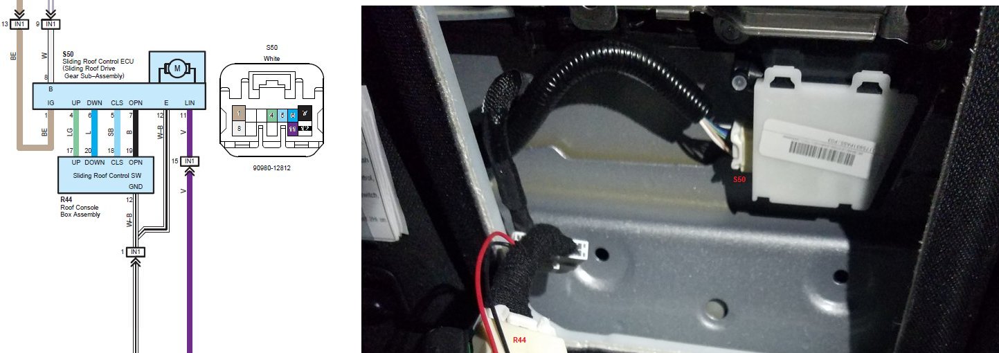

    You could lower the console, find the control connector to the motor and, with a wire, jump the closing switch to ground.

    Jiggle the button or connector plug.
    Just grab the overhead console and pull straight down. Don't yank too far down because you'll be pulling on wires within an inch or so...
    Ensure there is a proper connection.
    The wires there are barely long enough and they stress the connector plugs.
    I've ocassionaly had a connection issue.
