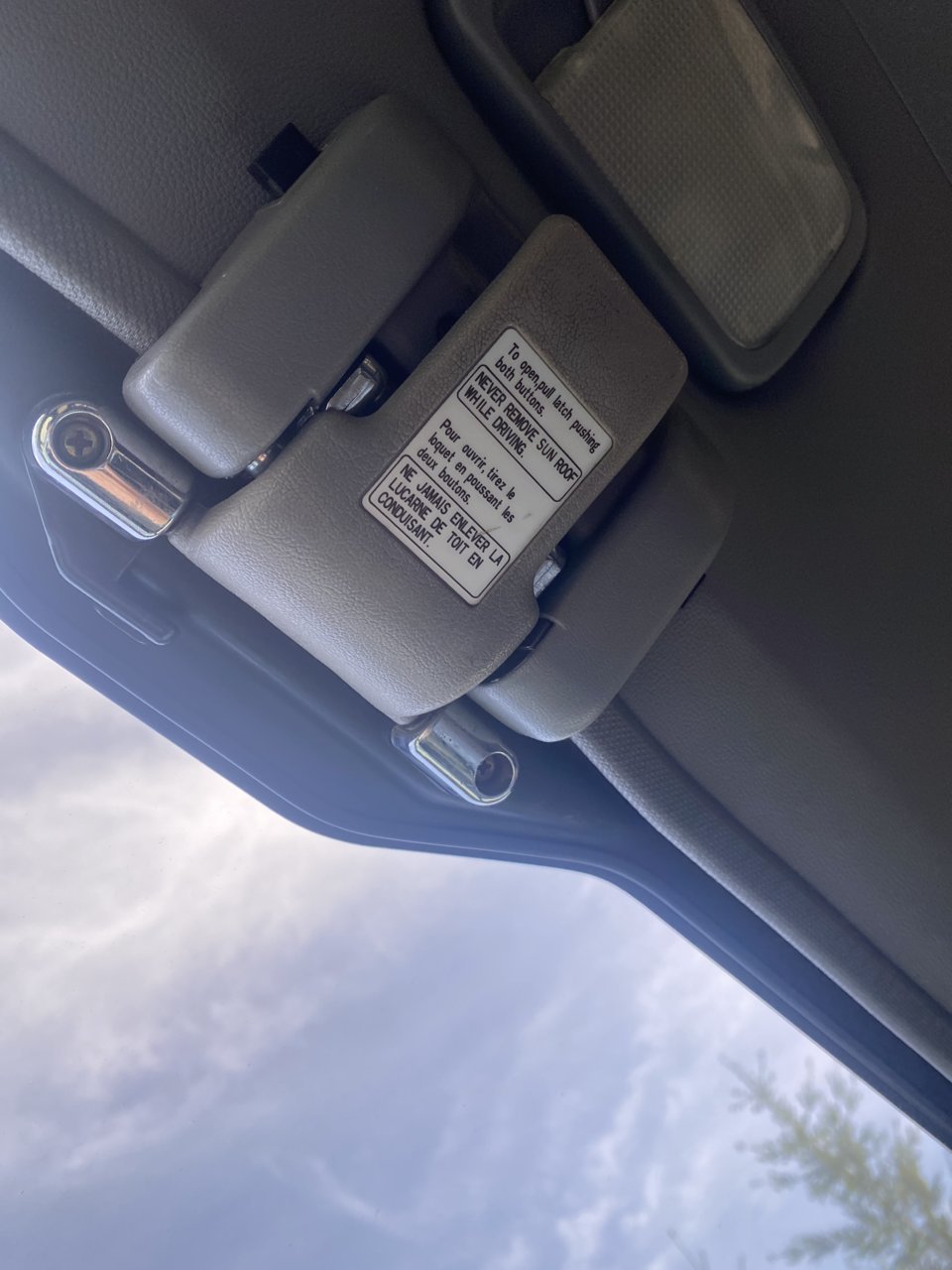

    Here’s what my latch mechanism looks like. Sorry for the delay. Didn’t get any notifications.
    Thankfully it doesn’t leak! Just annoying rattles. Only stops when I apply pressure to the glass!
    Thanks.

    In your pic, the latch doesn't look fully seated/clicked-in. To release and open the latch, you have to press both black side buttons, yes?
  7. May 25, 2023 at 7:45 AM
    Akeela1995
    Akeela1995 [OP] Active Member
    Dec 12, 2022
    #412903
    39
    1995 Tacoma
    It wasn’t fully clicked in! Had my sunroof open and just “closed” it for the photo! Was just taking the photo to show the mechanism! My apologies about that!
    When I do close it, it’s fully closed. With buttons pushed in and closed!

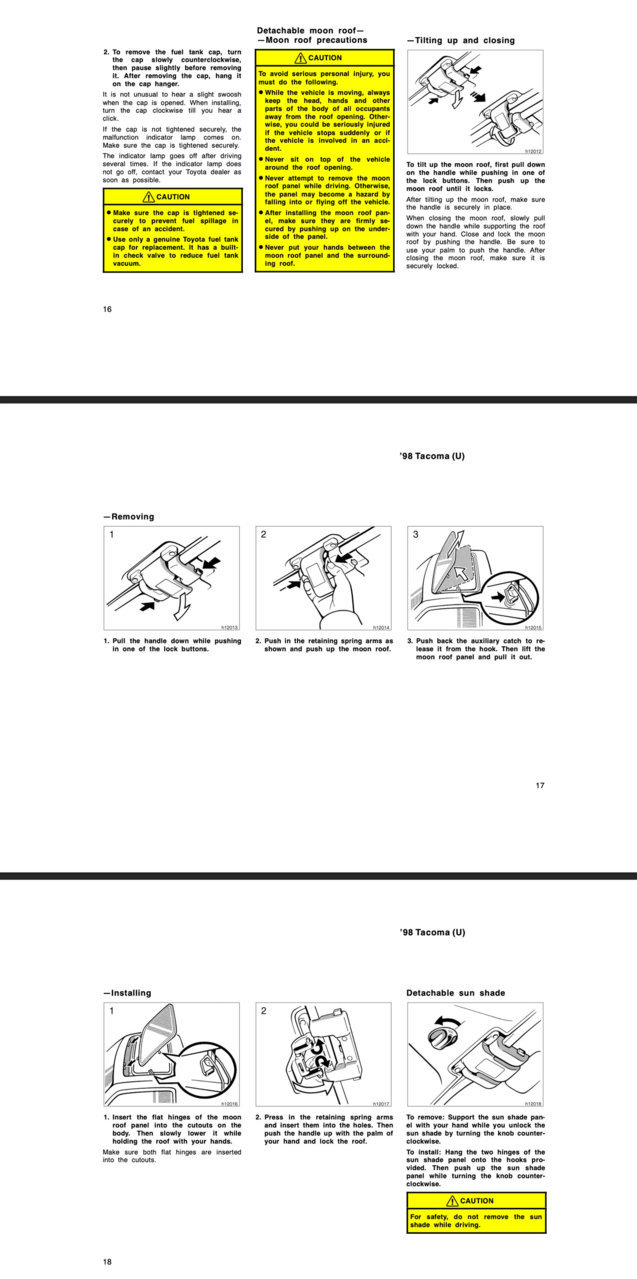

    Mine is a 98, maybe matches ... I've attached instructions from my Owner's Manual.

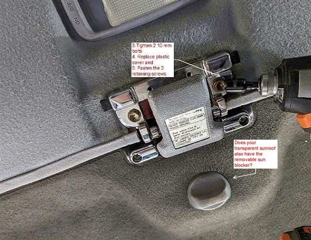

    Maybe you have already tried this, but, here goes:
    Check the latching mechanism for the removable sun shield, it may be the source of the rattle.
    Interesting that the instruction sticker says to press BOTH buttons to operate the latch; mine opens/operates with EITHER button pushed [EDIT] as stated in the Owner's Manual
    Good luck.
    EDIT- And, thanks, @Portlander, I never noticed that the moon roof can be completely REMOVED!
