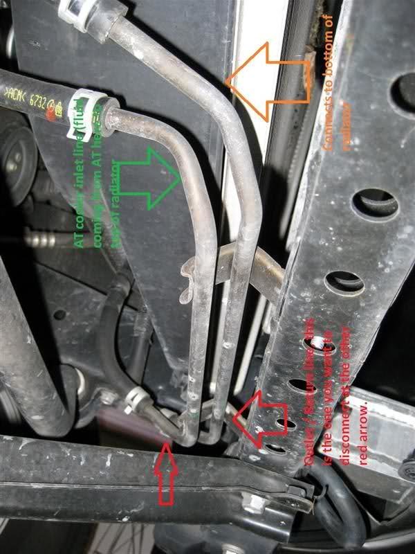

    I see. So i need to find this return line from the cooler you speak of....
    Is it the "oil cooler pipe" on this schematic?

    the return line is on the radiator. The bottom part of the radiator had a small cooler inside of it that cools transmission fluid.

    Cool. I can't see it right now because one of my skid bolts is stripped. I'm gonna have to get a cutting wheel tomorrow and cut it off. On the 2nd gen link the return line is the bottom of the two. Is that the case with the 1st gen? 2yoo02x_6bdfc4dc4f135180aef264b1e8f48a5ae9b5761a.jpg
    So if im understanding this right. the hot ATF travels through the inlet line to the rad, where it is cooled and then travels through the outlet line back to the pan. If i disconnect the outlet line i'll intercept the milky fluid on it's way back to the pan? But if that's the case, why do both lines run to the pan, adjacent to one another?

    Passage inside the case on the feed line leading from the valve body.

    The return line is the bottom of the two steel lines, connects at the middle/rear of tranny directly above the pan and on drivers side of radiator.
