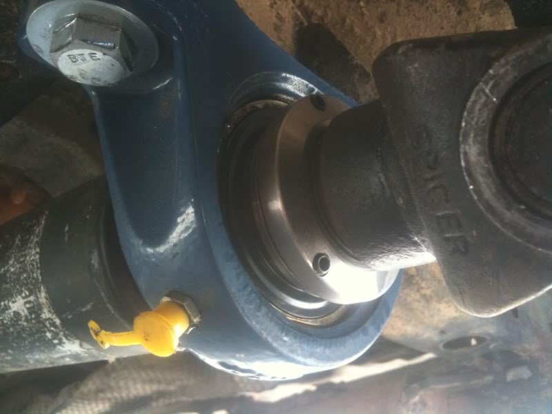

    I've looked around and have seen that it's been done. I did the wookie mod and don't like it, I've had a lot of vibration that i haven't been able to balance out so I'm either going to go back to stock, which sucks for a couple reasons one being it's spendy for a bearing that's not very strong. I have a couple of questions tho. does anyone know which year of super duty bearing guys have used? is it worth the hassle? i plan on being in moab in a few weeks and don't wanna stuck with what i have, it's way too annoying. I'll either order a stock replacement or try the super duty setup, just wanted a lil feedback if theres any. thanks

    Nevermind put in a chev 1 ton

    Nice install, did it improve your vibration issue??

    Yes no vibes whatsoever, smooth as can be

    Thanks, it's a lil bit ghetto, I used some scrap metal I had layin around. It's ugly but solid.

    I heard a couple of dudes had issues with the "wookie" mod. I am the originator of that mod, and have about 25K on it without issue. I wonder if some drivelines are out of balance and the solid bearing amplifies it or something?
    (pics of what I did for those who don't know wtf we're talking about)

    I'm not sure what the problem was, I had the driveline rebalanced when I installed the wookie and it helped but didn't cure it completely.
