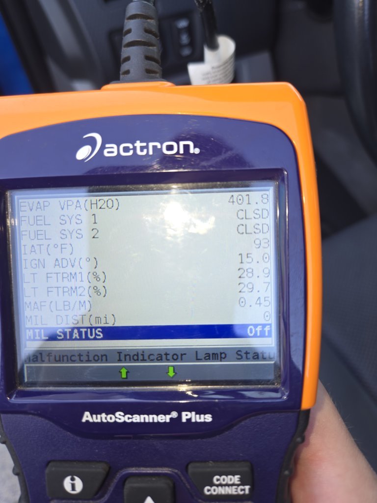

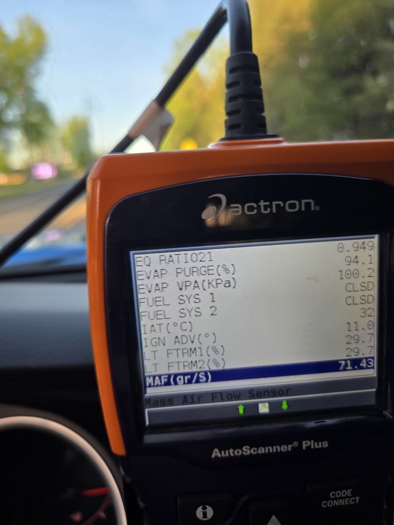

    Now to the issue. As mentioned above it had a weird hesitation, I hoped fixing the dash and p0500 would maybe fix this.
    It did not. In fact, 30-50 miles after installing the fixed gauge cluster, it did the weird hesitstion, and then i get a check engine light.... I think, F#&$ ME i was wrong it's a wire or the ecm causing the P0500. So I pull out the code scanner and to my surprise I have both the p0171 and 0174 codes bank 1 and 2 lean.
    Stupidly I reset them without looking at the freeze data. However I decided to look at my fuel trims and boy oh boy are they acting weird.
    IDLE: BOTH BANKS 25% 30%
    DRIVING: 25-34%
    WOT (BUT ONLY AFTER 3.5K RPM): hooyah!!!! They drop to 4!!!!
    Maybe I just need to drive faster and it's a me problem.
    What i tried so far is check for vaccumm leaks, inspect and clean maf, replace intake filter.
    At this point im leaning towards my fuel pump starting to go, anything else I can look at while I try to get my hands on a fuel pressure gauge? Anything else easy to check?
    Anyways I hope I gave good info. All above poor maintenence things were fixed for about a month or 2 before I sent the dash out. To my and my uncle's knowledge the only code it's ever throw until today was the p0500. And it has not come back since the fix although only 50 miles ago.
    Thanks fellas.

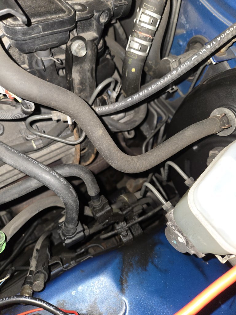

    In the mean time, any thoughts it could be a vacuum leak I'm missing? like the intake runner gasket or something? i was thinking smoke test or try the classic spritz starter fluid around hoses Etc..

    Yea too many people (and may "professionals") fire the parts cannon instead of testing and finding the actual problem. I'm the opposite, I wana prove something is bad before I replace it.
    Typically with a vacuum leak you would have high positive trims at idle and they would improve as RPM and load increase, your trims appear to be pretty flat throughout the RPM and load range which would suggest a base fuel/engine issue.

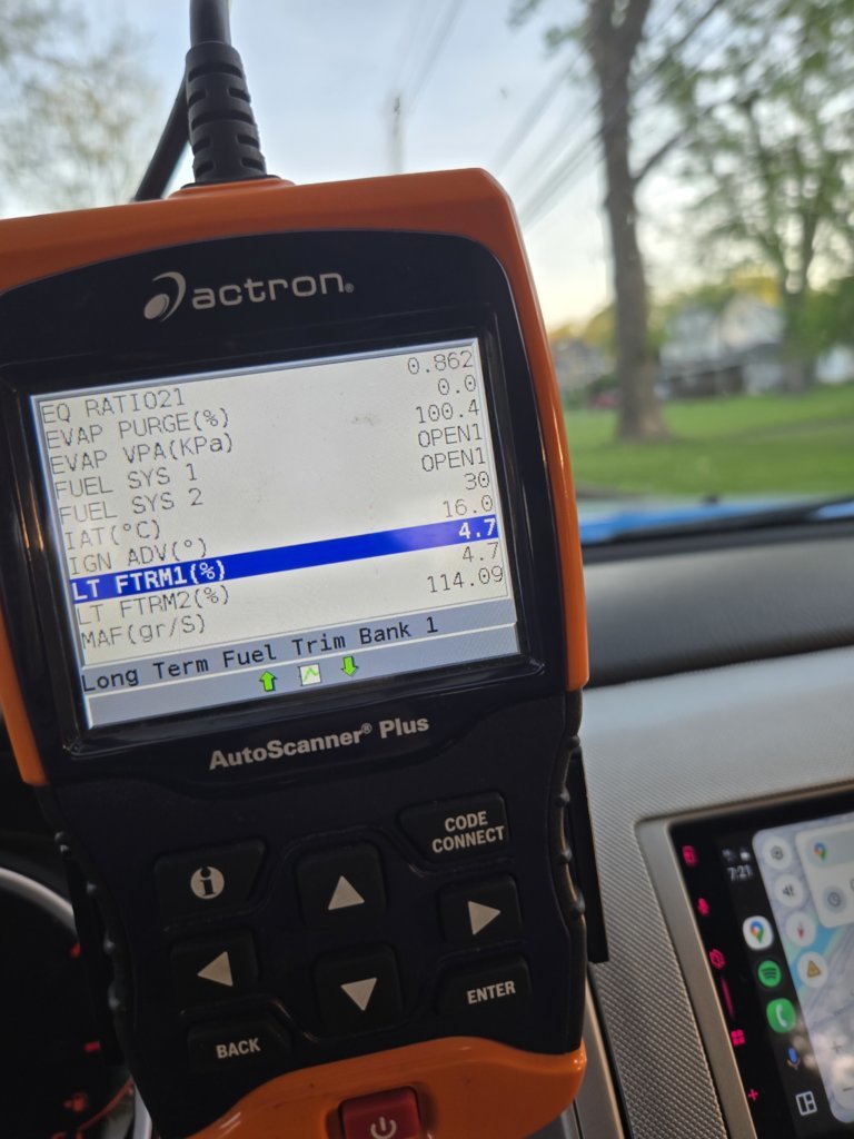

    i also want to add a piece of random possibly useful info. sometimes, while at cruise, i feel the truck "come alive" like my foots been in the same spot at ~65mph then all of sudden its accelerating to 75 plus. this sensation quickly fades, and i never thought much of it. as it goes back to normally pretty quick. maybe that points towards fuel pump going out as well? final food for thought before bed. i will report back with new info after work tomorrow

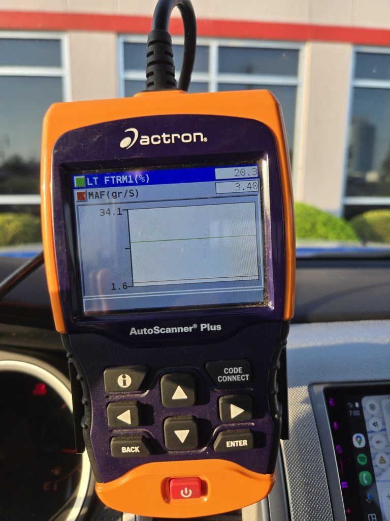

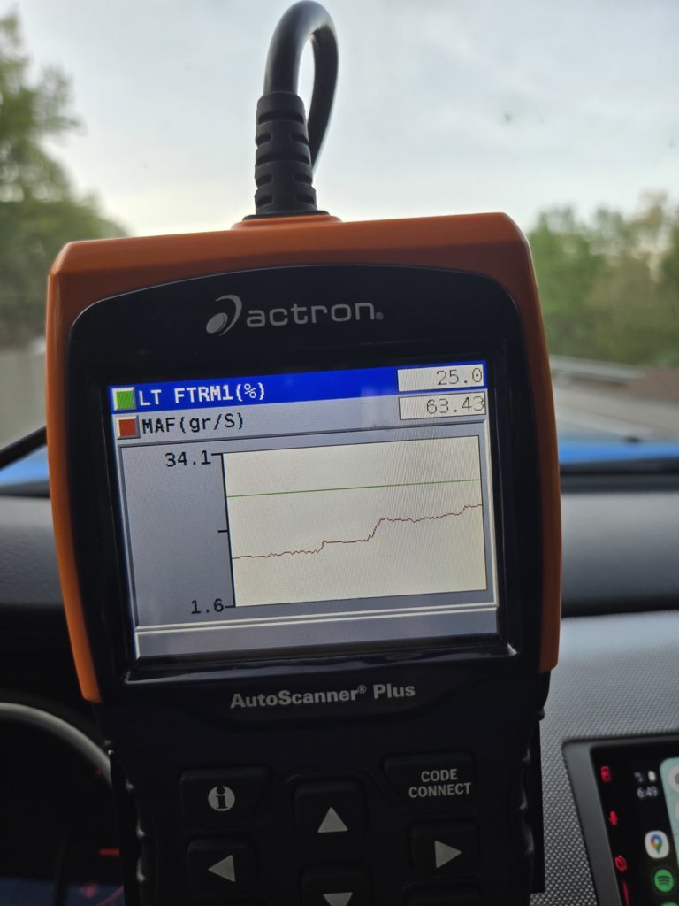

    MAF accuracy can really only be effectively checked at idle and and on a WOT pull.
    At hot idle MAF Grams per Second (g/S) should be about equal to engine displacement in liters so for a 4.0L engine it should be right at 4 g/S.
    For the WOT reading we want to do what's called a VE (Volumetric Efficiency) test, do a WOT pull through 1st gear and record peak RPM, peak MAF, IAT, and the barometric pressure then enter them in one of the calculators below.
    You want to be above 85%, ideally closer to 100%

    Here is my idle when I got to work ~30 min drive on highway. Sitting for about 1 minute. Seems a little low on the GRAMS/s
    And then here's one going up hill at speed.
