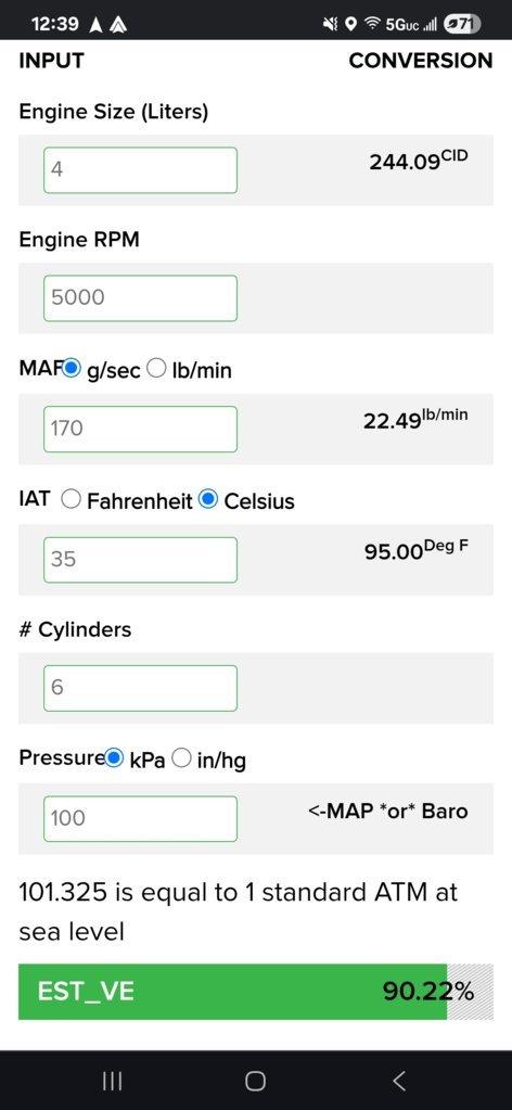

    I got close to 85, took a drive on lunch.

    So it isn't a MAF or breathability issue.

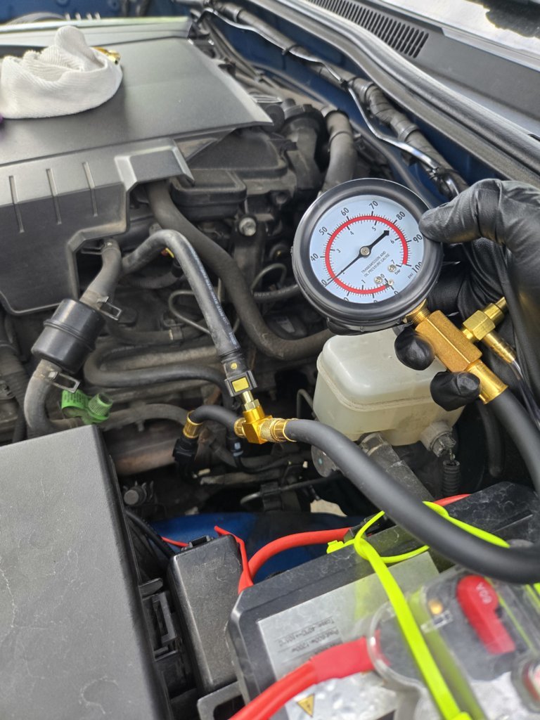

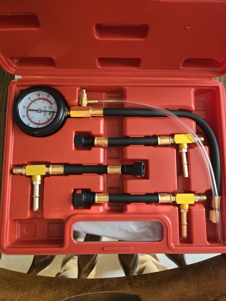

    You would have to access the fuel pump connector and load check the circuit with a high amp test light or other suitable load unless you had an oscilloscope and amp clamp to look at current ramps of the pump.

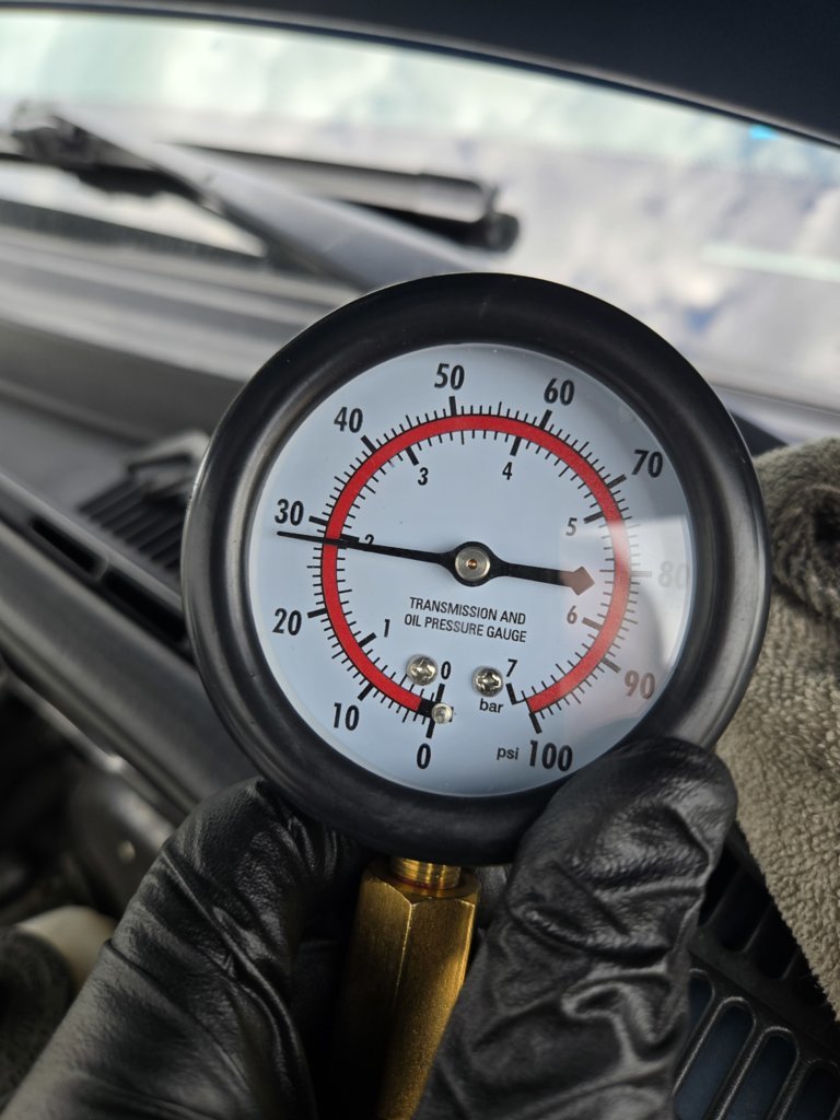

    Pressure is already low, no need to drive it.
    You could jump out the fuel pump resistor and see if it impoves but in all likelihood it's the pump.
    Only other verification test you can do is access the fuel pump connector and load test the circuit with a headlight bulb but that's likely gonna involve dropping the tank anyway.

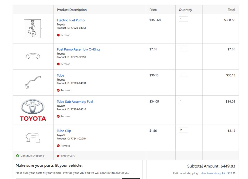

    Yupp, that's what I figured. Any advice on what route to go? I'm thinking suck it up and get one of the oem ones that are the full unit for like 380. Thought about the urd kit but being 20 years old I feel like I shoukd just put a whole new unit.

    this is what I'm looking at grabbing, place is an hour from my house.

    I'd go OEM, they typically last 200-300k. Unusual that yours failed at 75k but you said it had poor maintenance so maybe it got some crap in the tank.
