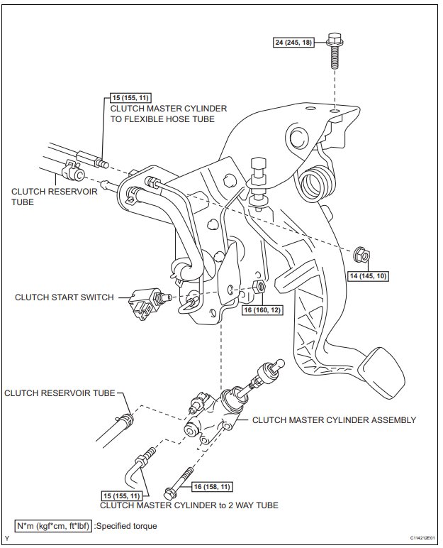

  6. May 2, 2025 at 7:34 PM
    #46
    Dm93
    Dm93 Test Don't Guess
    Mar 3, 2015
    #150066
    13,717
    Texas
    2014 DC OR 6spd 4x4
    Predator tube steps, Ranch Hand grill guard, Magnaflow CatBack exhaust, Toyota tool box & bed mat, 2LO Module by @Up2NoGood, Rearview Compass/Temp Mirror, Tune by @JustDSM.
    My master cylinder is starting to go on mine (97k) or at least I'm thinking that's what it is, it's like it doesn't quite return all the way until it warms up. Still works ok but I'm not sure how much longer it will so I'm just gona go ahead and fix it.
    Got all the parts ordered for it, gotta get all the updated parts per TSB 0112-19 Rev1 because the original is discontinued. $467 for that stuff and the slave cylinder.
  7. May 2, 2025 at 7:50 PM
    #47
    Taco-Engineering
    Taco-Engineering [OP] Well-Known Member
    Mar 27, 2025
    #468470
    50
    Joshua
    2005 TRD OR
    i did the Master on my second Subaru, not sure if its the same for Tacoma's but if you don't bench bleed it you're in for a multiple hour bleed. don't ask me how i know.
    aside from sticking to the floor when i was bleeding the clutch, which i heard can be normal for these trucks, mines felt pretty okay.
  8. May 2, 2025 at 7:54 PM
    #48
    Taco-Engineering
    Mar 27, 2025
    #468470
    50
    Joshua
    2005 TRD OR
    i read the TSB mine has the squeak for sure. i will definitely use this in the future if the master goes.
  9. May 2, 2025 at 8:01 PM
    #49
    Dm93
    Mar 3, 2015
    #150066
    13,717
    Texas
    2014 DC OR 6spd 4x4
    It's possible to bench bleed these because they are under the dash fed by a hose from the reservoir and you have to remove the whole pedal bracket assembly to change it, not fun.
    Mine has always been right at the top, last Monday when I got it it to go to work it went down like 1/4 travel before it had anything but not leaks or change in fluid level. It's been better lately but it's still not right except when it good and hot.

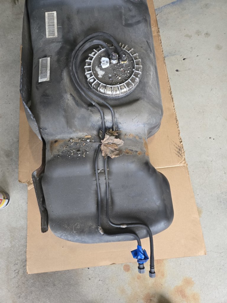

  12. May 8, 2025 at 4:43 PM
    #52
    Taco-Engineering
    Mar 27, 2025
    #468470
    50
    Joshua
    2005 TRD OR
    Always gotta be something haha. This damn lock ring won't budge. Tanks out though!
    winkel likes this.
  13. May 8, 2025 at 5:01 PM
    #53
    Dm93
    Mar 3, 2015
    #150066
    13,717
    Texas
    2014 DC OR 6spd 4x4
    Yea they are usually pretty tight.
    Typically you can knock them loose with a hammer and a wide blunt flat screwdriver.
  14. May 8, 2025 at 8:12 PM
    #54
    Taco-Engineering
    Mar 27, 2025
    #468470
    50
    Joshua
    2005 TRD OR
    Well she's back in and running like a champ. I'll double check fuel trims tomorrow but all seems good.
    I had to bite the bullet for a pump wrench, 40 bucks at autozone. Other wise it really wasn't bad. Tank was super clean. Gonna look at the old pump tomorrow as well and see if the filter clogged or pump was just dying.
    Side note, it was missing the pump cap!!! My guess is. It was forgot in the frame swap. Soooooo it's back on there with no cap. We'll see if this bites me in the ass someday.
    Thanks again for all the help.
    winkel, SR-71A and Dm93 like this.
  15. May 8, 2025 at 8:14 PM
    #55
    Dm93
    Mar 3, 2015
    #150066
    13,717
    Texas
    2014 DC OR 6spd 4x4
    Not gona hurt anything without the cap, the cap is just an annoyance when you have to drop the tank.
    winkel likes this.
  16. May 8, 2025 at 8:18 PM
    #56
    Taco-Engineering
    Mar 27, 2025
    #468470
    50
    Joshua
    2005 TRD OR
    Hell yeah. Love to hear that.
