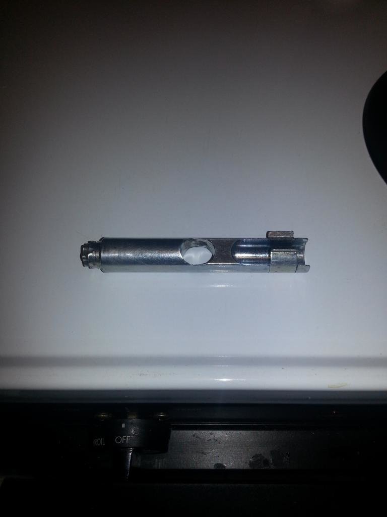

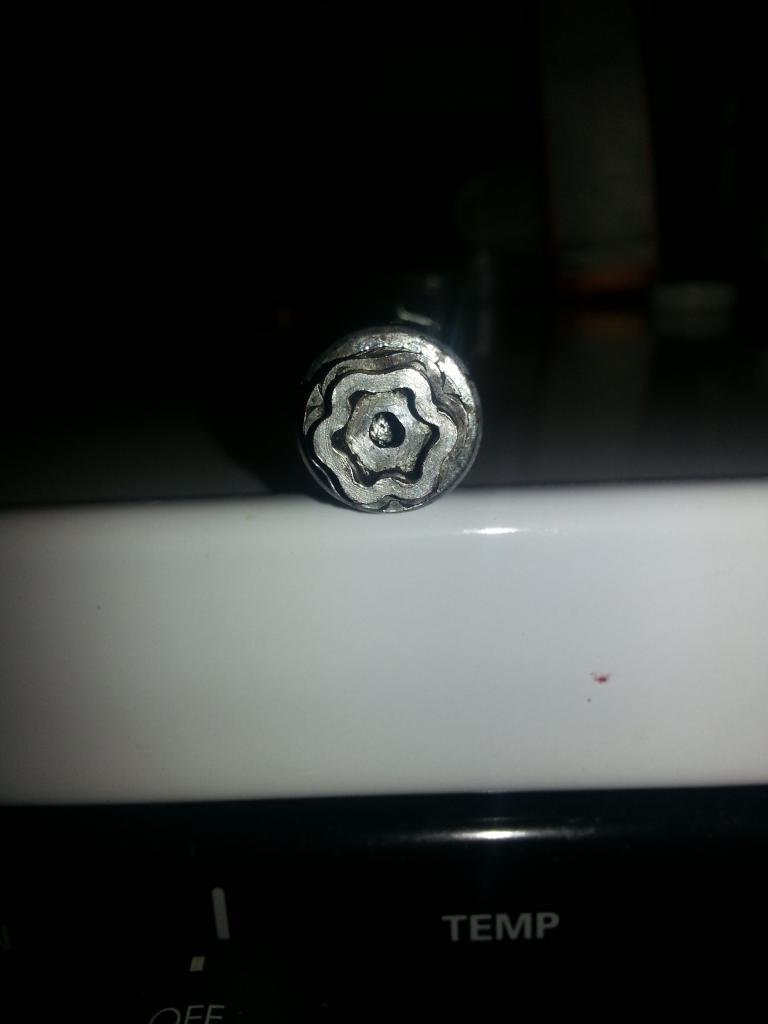

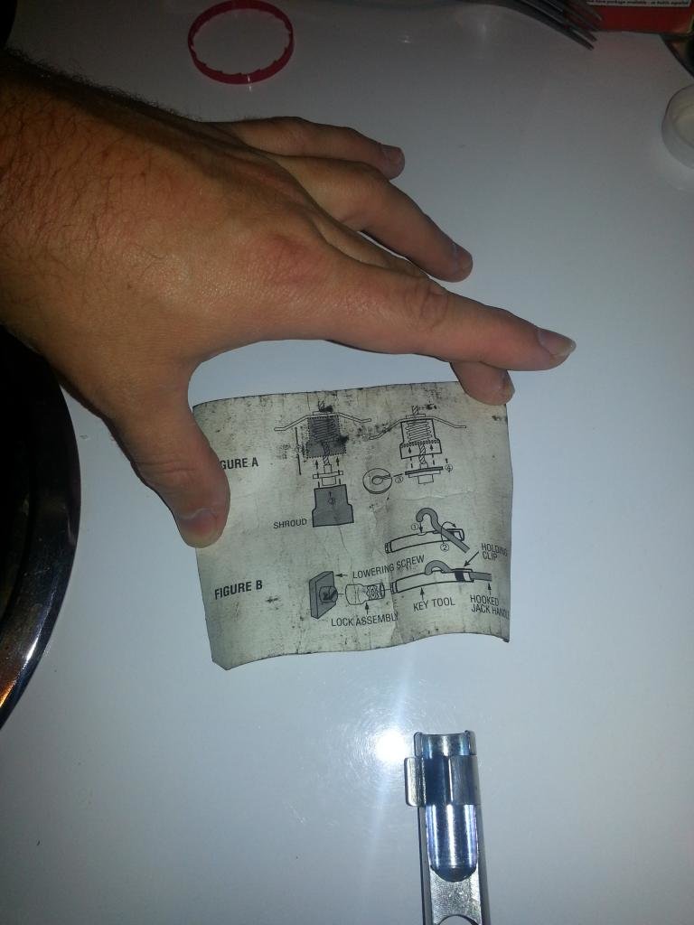

    when I got my spare tire holder replaced they never put the cylinder back on with the keyed piece, and then i read it was easier to remove with a strong enough screwdriver. but for reference here ya go. There's also somewhere I saw where you can file off 80% of the key part and it becomes universal for all Toyota spare tires with the lock, apparently they follow a pattern but these two spots will always be there.

    Thankfully I got it off. Filing it probably would have worked but taken forever with the tire still up. If it came down to it on the roadside, I would have cut cable.
    A screwdriver into that star pattern, with a ratchet on the end is how I got it off. Then I used a screwdriver (it broke) and then the tire iron to pry the lock off. I'll never have to deal with it again.
    Now that I see you pictures, I have recently seen that key and never knew what it was. I took everything out of my toolbox last night looking for it just in case I put it in there. I'm way to redneck to throw it out, so I'm sure I'll stumble across it again someday now that it's useless.
