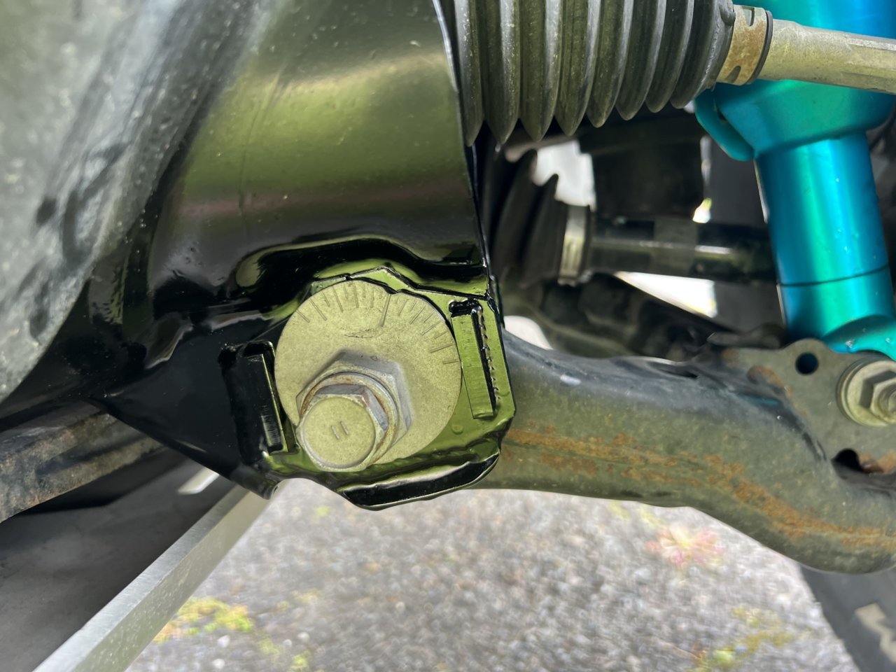

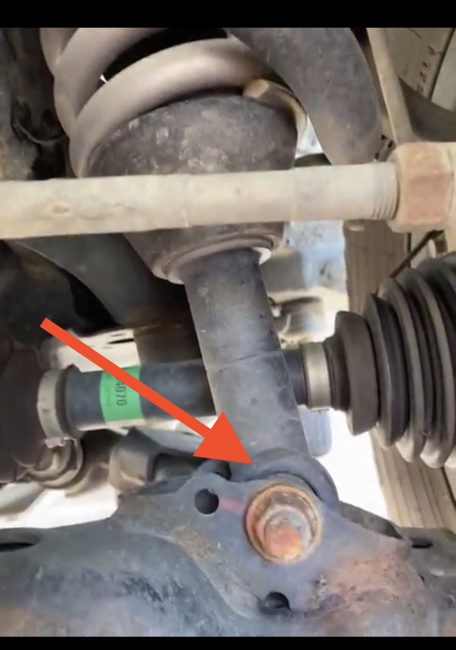

    Grab the tie rod in the middle and try to move it in and out laterally. Check your LCA alignment cams to see if they are folding the factory tabs.

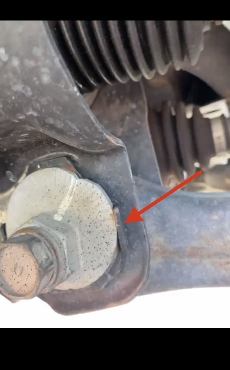

    I watched your video a few more times:
    1. Sway bar - torque the 2 clam shell bushings to the frame. Torque all 4 end link bolts. A lot of folks install the sway bar at an angle after a lift kit which binds it. With the truck on the ground loosen the 4 clam shell bolts slightly and re-seat it. Then go to the end links.
    2. Spray lube your Radflo shock lower heim joints. I have had binding and creaking from many a lower heim, they dry out, get packed with dirt and and stop rotating correctly. Spray both sides of each lower shock mount, then rotate the steering back and forth to work it in.
    3. Your cam tabs are starting to fold. I don’t think that’s your sound but they are failing.
    EFF22C04-70FC-4842-993B-2DEE64D63023.jpg 5F1C47EC-BBA7-41D4-A171-ACB394B88764.jpg 13AD794B-92BD-4267-9059-C77DB98C697C.jpg

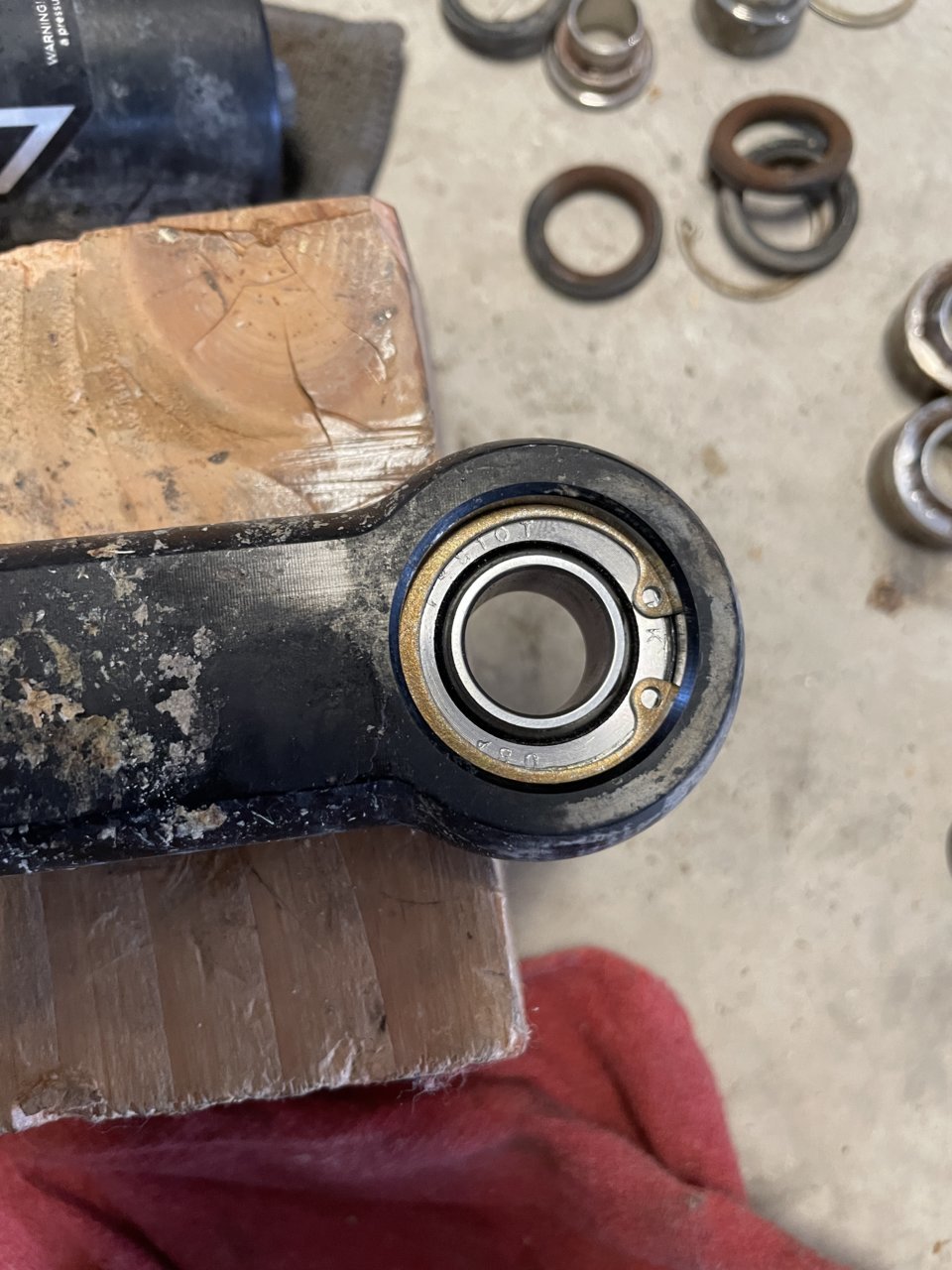

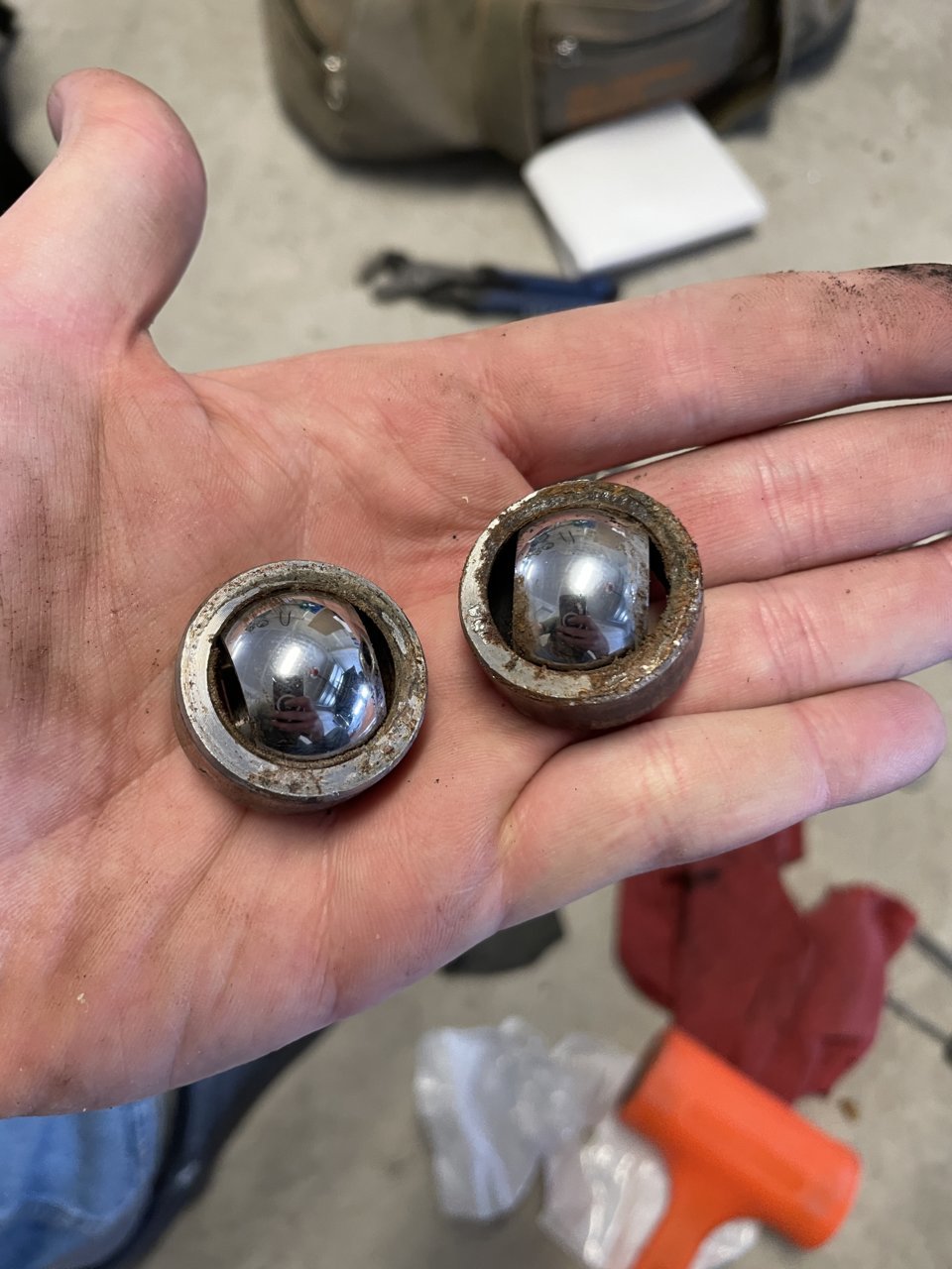

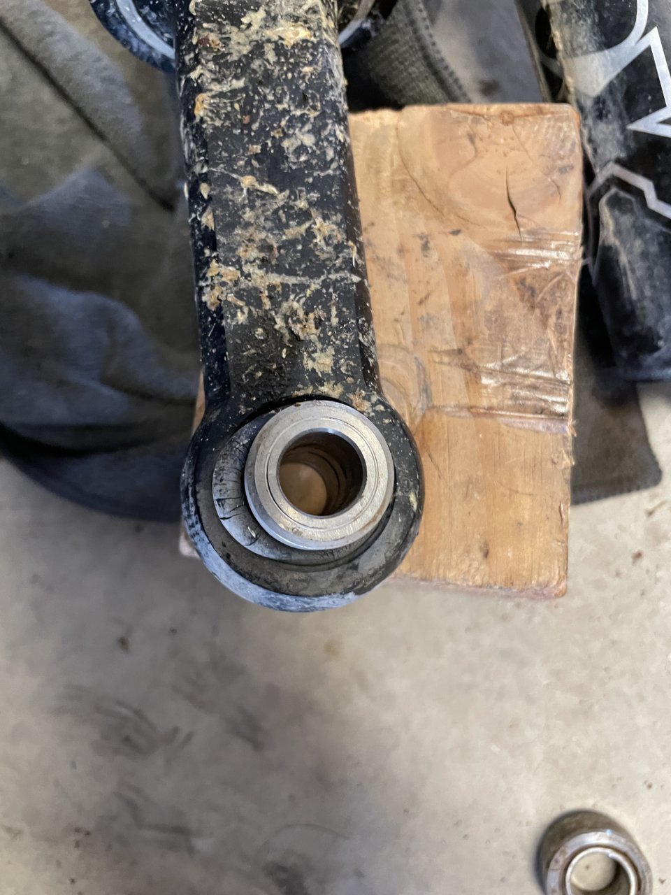

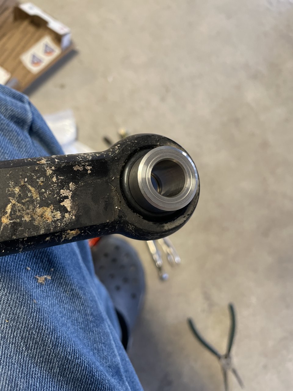

    Check the lower shock bearings. Mine made a similar noise, it just wasn't quite as bad sounding as the videos here. If you can, unbolt the coilovers from the LCA and see if there's any play in the bearings. I was able to grab the misalignment spacers and easily wiggle around the bearings with no resistance indicating they were indeed shot. After I replaced them all noises went away and the ride quality went up.

    Had a simular noise and for me it was the alignment cam tabs were slightly bent out. This allowed the LCA to move slightly in the slots even though bolts were to proper torque.
