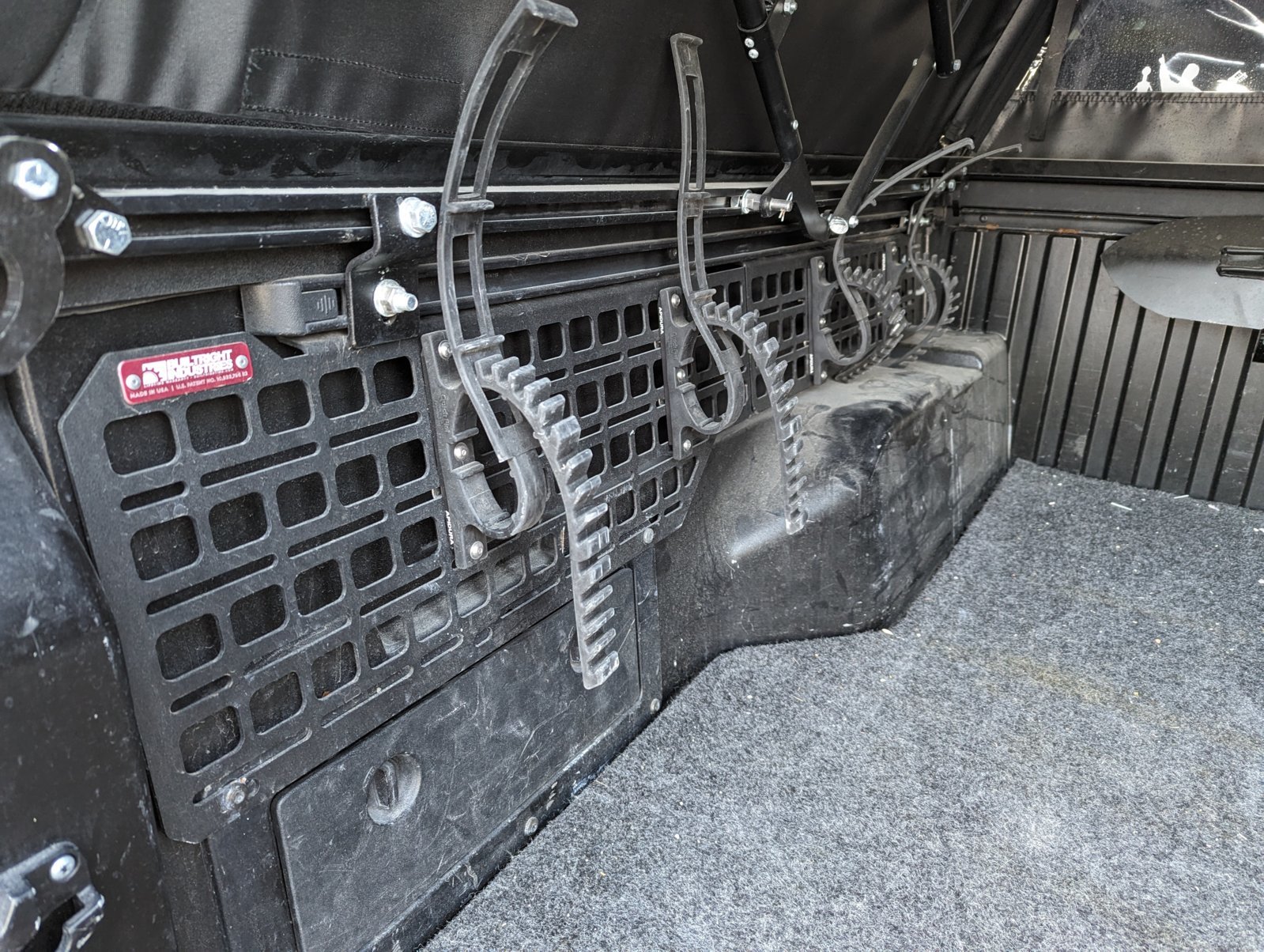

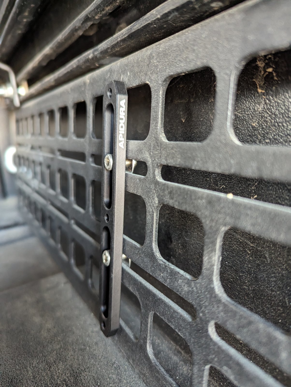

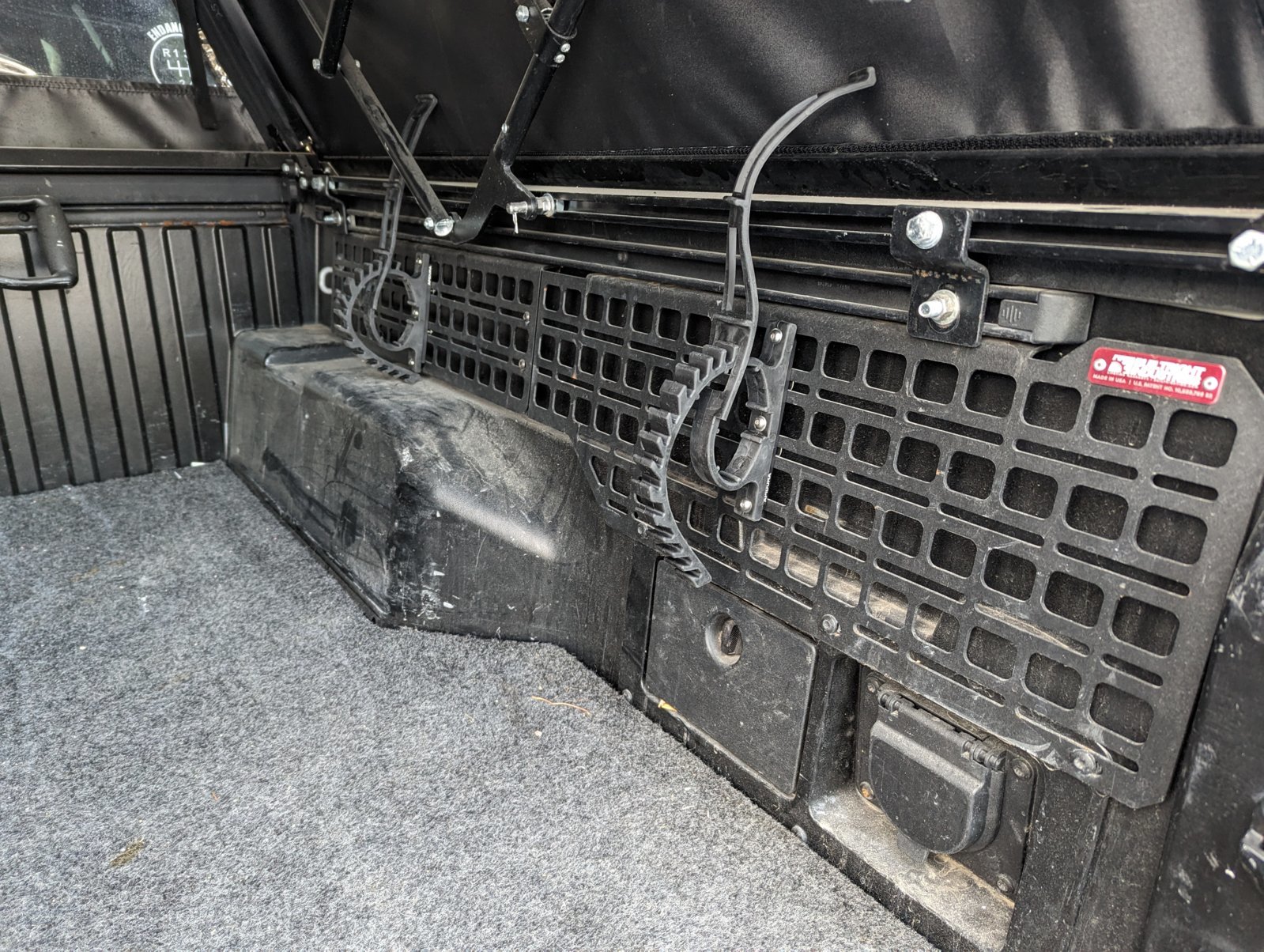

    I posted my mounting solution in the "What Have You Done Today" thread and got quite a few likes so I figured I would share a more in depth how to do it.
    I did it this way because I wanted a lower profile mounting solution compared the bracket they offer.
    The BuiltRightIndustries molle panels have narrow cutouts that allow for this solution.
    I use them to hold 2 camping chairs on my drivers side and my bug net shelter on the passenger side.
    Part list:
    -Super Quick Fist 20020
    -Apidura Bottle Cage Adapter or Wolf Tooth B-Rad or any cheap one off Amazon
    -M5 pan head 16mm bolts
    -M5 lock nut
    -Fender washers
    I picked the Apidura adapters because they were 3 holes like the quick fist and my local bike shop had them in stock at the time.

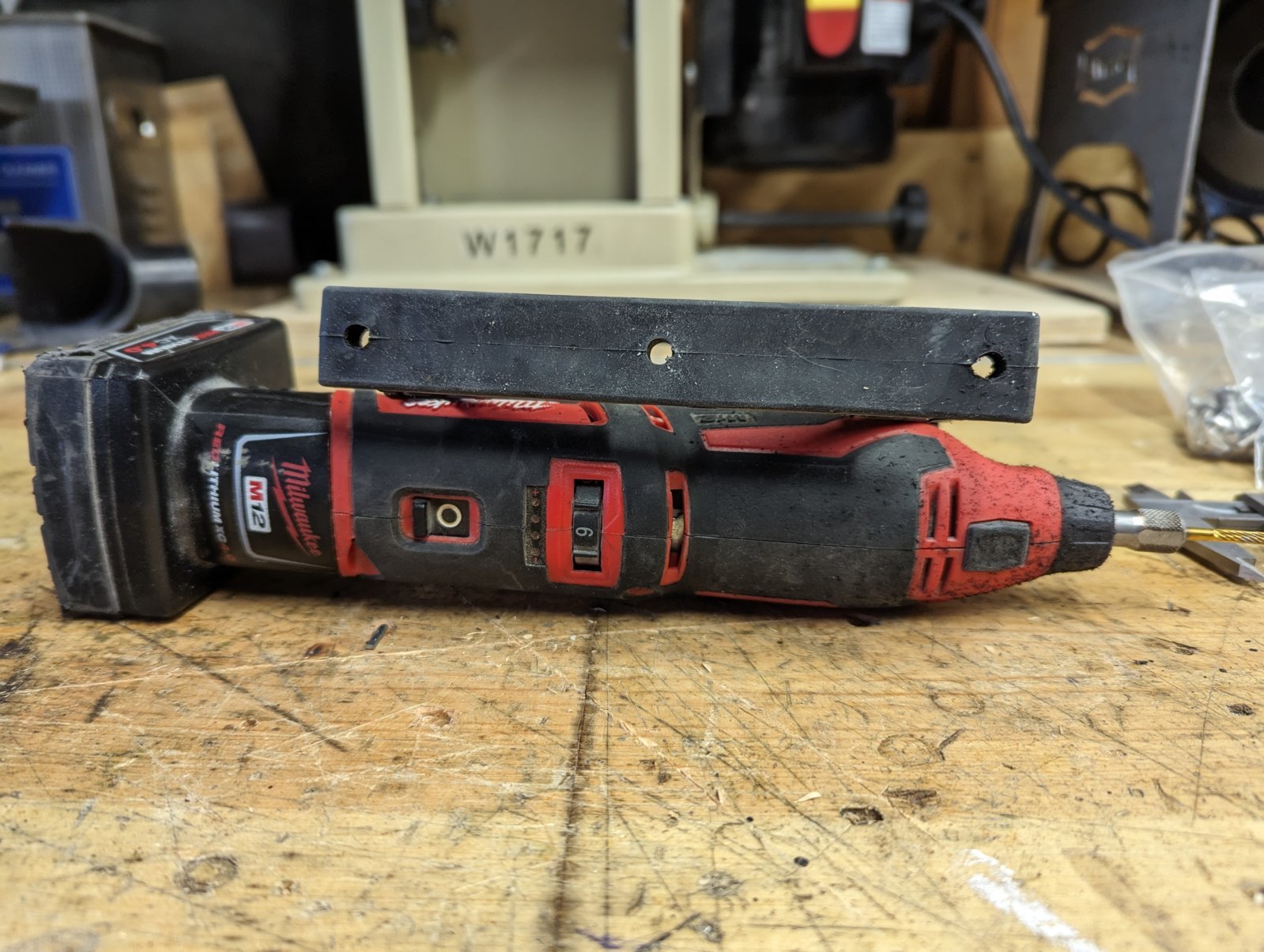

    The Quick Fist top and bottom bolt holes will need some trimming. I used my rotary tool to elongate the holes by a few mm.
    Putting some tape on a box wrench allows you to hold the nut easier when installing the mounts with the molle panels already in the truck.
