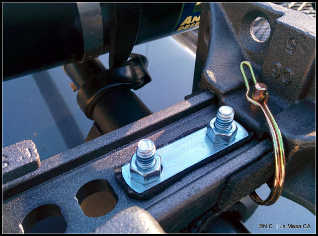

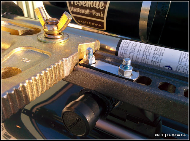

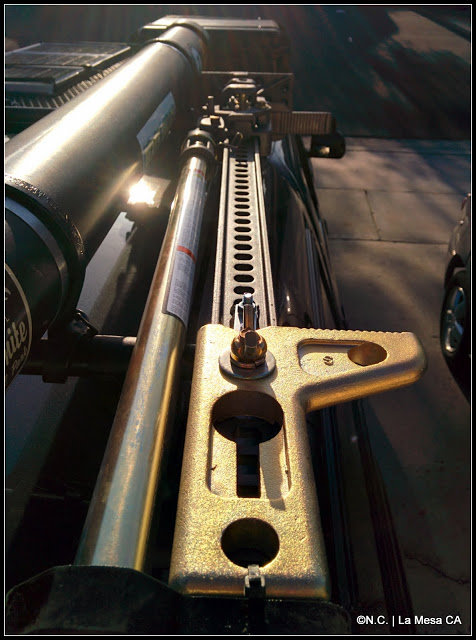

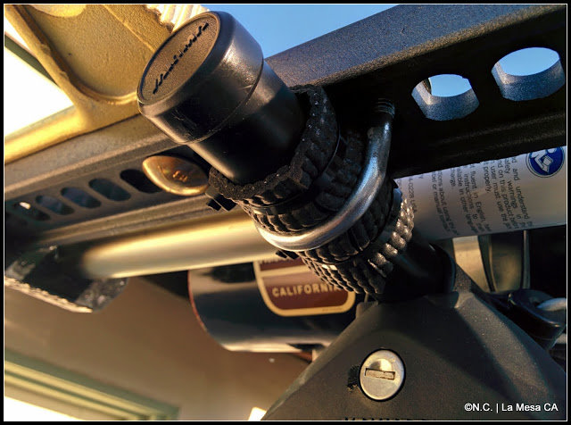

    I needed a good-fast-cheap way to mount the Hi-Lift directly to the Yakima load bars on my truck. I made this thread to help others.
    Items needed:
    1. Size 1" Pipe U-Bolts ($2.50?)
    2. Nyloc nuts, or thread lock ($?)
    3. Cut up some random black exercise mat (Free)
    Nyloc nuts would be ideal for this... I had none, so used a little thread lock. In the event I need the lift, I don't mind using a hand ratchet. it's four nuts and I have easy access. And it gives me time to make a plan for the recovery. :D
    As a side note. The cut up exercise mat is perfect for stopping the foot from rattling. Insert a couple strips on front and back side of the beam and it's good! (pictured below.)
    I hope this helps someone.

    Looks great. You may want some wing nuts though so you can get it off quick when you need it.

    Thanks guys.
    Before doing this i searched for a lot of mounting examples. And all of them were costly or required access to skill with a welder.
    Wing nuts may work though I'd be concerned about getting enough torque.
    Cable lock works for security, if i was going to select one i'd get a beefy one. I'm undecided right now.

    i did a similar thing on my thule square bars, drilled a whole through it and stuck and eye bolt with a wing nut and lock washer on it.
