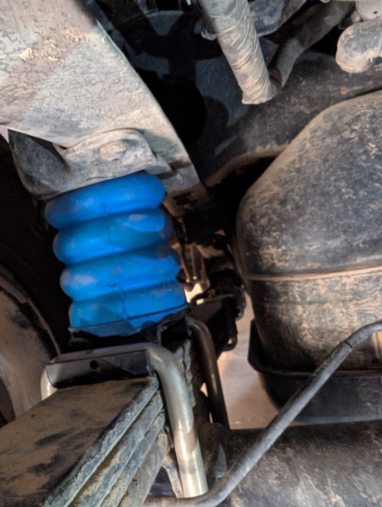

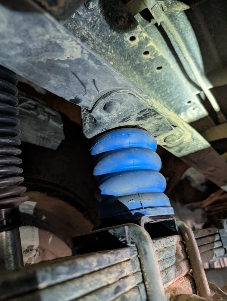

    The two sides don't appear to sit exactly the same on the springs. The passenger side, 1st pic, seems off center from where it should hit on the frame. Is this normal or did that filthy animal who installed it mess something up?passenger.jpg Driver.jpg [​IMG]

    You can't really misalign the bump stops or the leaf springs, but it's not uncommon for these trucks to have a rear axle that is slightly misaligned from the factory. It's not ideal, but it looks within Toyota's tolerance and should functionally work fine. Can reach out to Toyota to see if they can get you a better axle but they'll probably tell you the same as I just posted.
