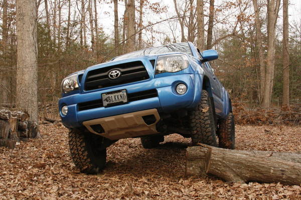

    I usually run straight up Swampers on my past vehicles, when I put tires on this time, I went with some 285/75/16 TRXUS. I couldn't be happier, not real loud but you know they are there and they ride pretty damn good for a fairly aggressive tire, road force balanced and I am good to go. We will see what kinda mileage I get and wear. I am a tire maintenance fool and cross rotate evry oil change and constantly check air pressure. So what is it with the VA dudes and Swampers. The secret lies within Bodacious.

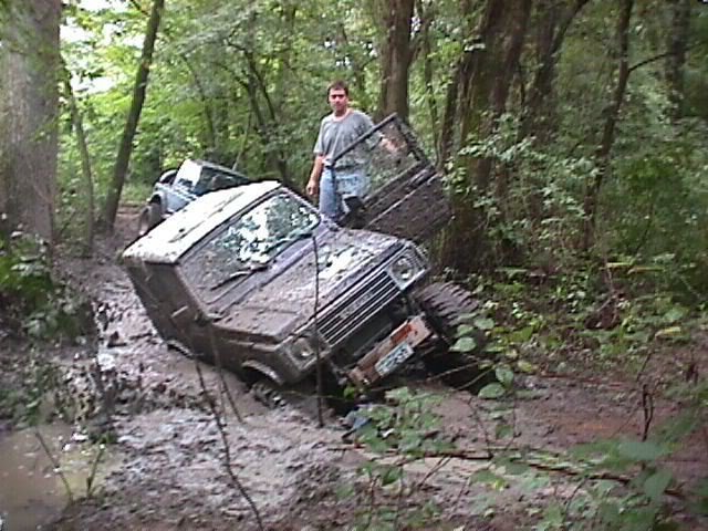

    Va & Swampers ???
    All (4) are stuck
    This was the bypass and those are 35x16-15 Boggers (Locked)

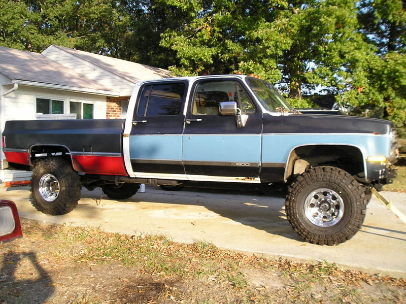

    Thanks guys :eek:

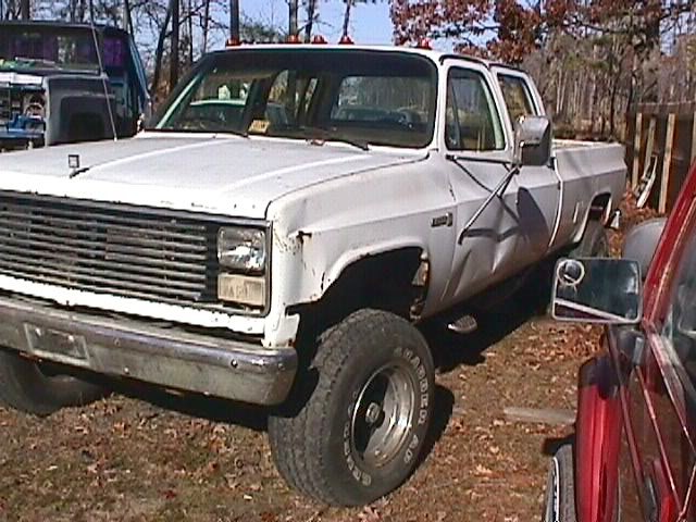

    The 1-ton is a long term project built Big Block 1976 Caddy 500cid engine.
    Before pic ~

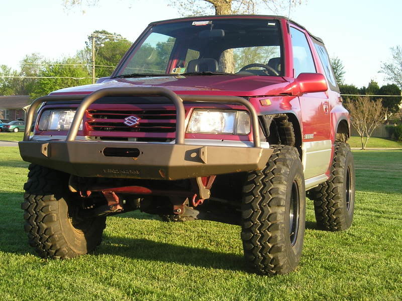

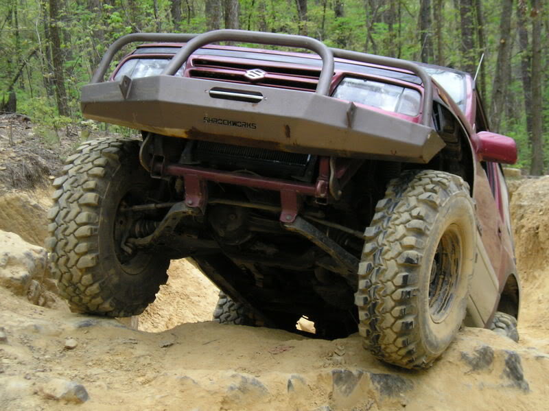

    Lrgrnr ~ I raced that Sidekick on 31" swampers at the 1st Uwharrie 4xcross event (Racing Rky Mtn Loop ~ WFO 7min ). Placed 7th or 8th in A class (many of the other race trucks were disposable) ~ Local Mud Devils JT beat me in a stockish Sammy on 235's.
    I've got a few built 4-dr Sidekicks too... + sammys and a buggy.

    What did it cost ya to build that little beast?
    What are the specs on the lift and whatnot?

    I'm probally just under $3500 ~~ Not exactly sure.
    The 98 2-dr Truck with 89K miles was $1400 (small front end collision) bought from used dealer who repairs auction cars) I bought it before he made the repair.
    Radiator support $20 Used
    New Radiatior $170
    2" coil spacers F&R $80
    2" Body lift $100
    body mods $free
    New top $400
    Tires and Wheels off of my other Skidekick
    Shrock bumper off my other Sidekick
    Fender trim (free) front is trimmed straight forward out of necessity to remove the crash crumpled damaged sheet metal.
    I've also added a gear swap to 5.13's (stock Kick 4-dr gears) and changed out the aluminium front diff center section to a Samurai steel unit. Also mods to the idle arm to make it double shear (race prep).
    Now it just needs Strut brace / Skid plate / Rear bumper.
