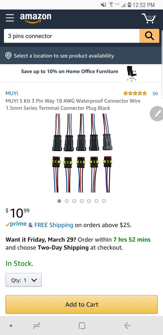

    I'm thinking of using this(see picture below), but want to see if there is a better way.Screenshot_20190327-125212_Samsung Internet.jpg

    That would work too. It’s all up to the end user. The connectors with pre-crimped pigtails will require cutting your old connector off and crimping or soldering to the existing wires.
    I think better is relative. I’m very particular about my wiring and prefer to utilize existing pins or crimp pins on myself. It also allows me to use whatever wire I want. Most if not all the China connectors utilize Copper coated aluminum or straight aluminum wire, which for the low amp application that are the KC cyclones or Baja lights is fine and inconsequential, but aluminum wire doesn’t support as much amperage. That sort of thing is more important for running bigger amp draw accessories.
