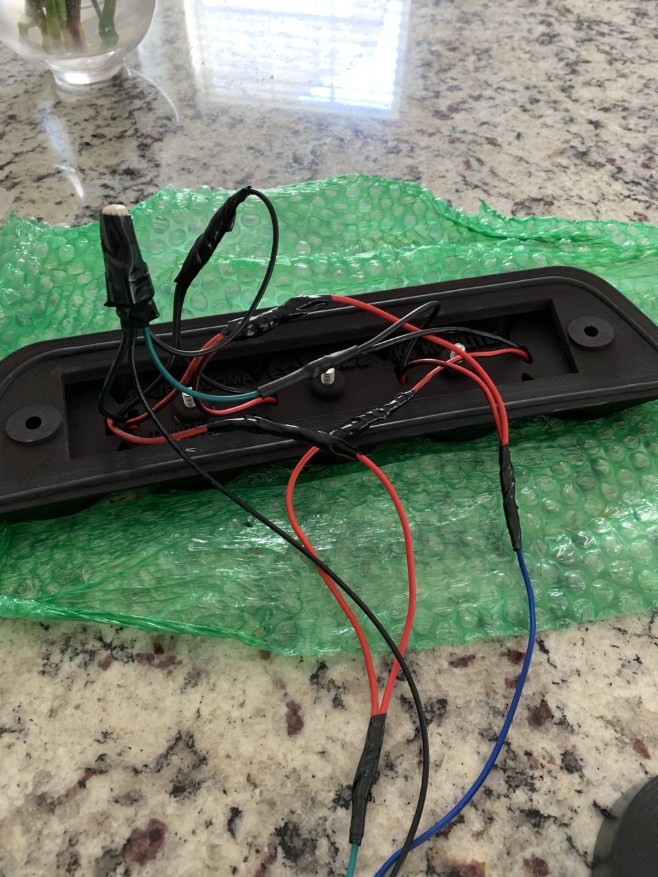

    Debating on dropping the headliner or just going in from the outside. Guys, if I decide to drop the headliner and I have a @mesojdm dome, do I need to remove the whole thing or just the hooks in the back, the oh shit handles, and the trim pieces on the sides?9DB249DE-C5AF-4BCC-A12A-9EF458602932.jpg

    Step one is to re-do that wiring job. Electrical tape is not a permanent solution. Either solder and shrink wrap, or use the crimp style connectors and a heat gun to melt the glue.

    I’m no dummy haha. They’re all crimped and heated. Just tossed on some super 33+ as well.

    Oh wow, ok. Sorry for assuming you didn't have all of that goodness under the tape. Looks great

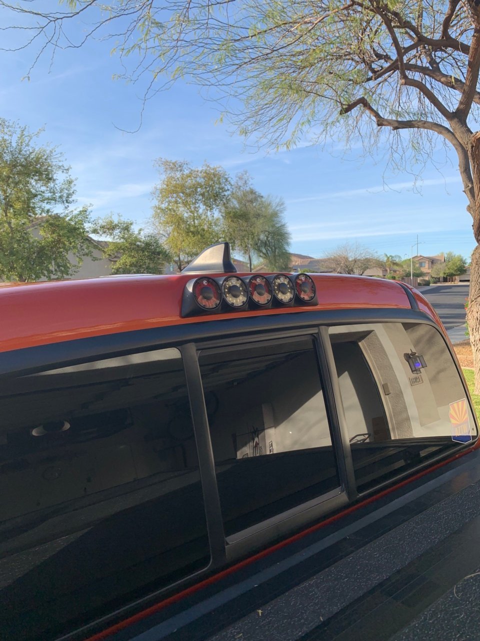

    157
    Juice
    Arizona
    16 Taco DCLB Sport 4x4
    When I did mine, I dropped the headliner.
    In the back seat area -behind the SRS badge is a 10mm bolt.
    Oh Shit handles have 2 Squeeze Clips
    Laundry hooks have the same squeeze clips
    Rear light has 2 squeeze clips
    Rear pillar has the standard white panel clips
    I actually opened the rear slide window then dropped the headliner - went in to the truck bed and removed the 2 10mm nuts through the slide window that hold the 3rd break light with a deep socket - LOL
    Love my 3rd Brake light set up now!
