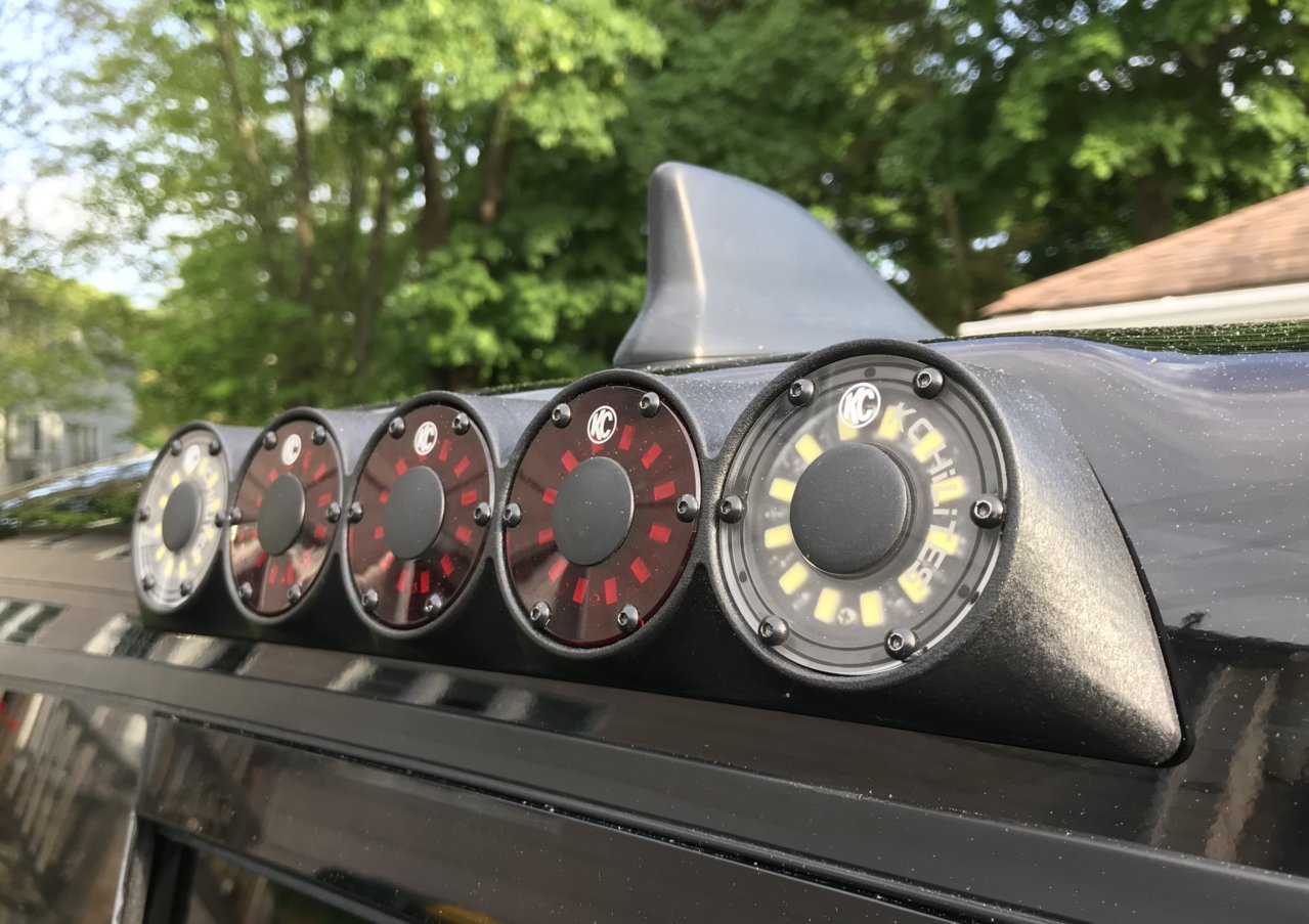

    Very sweet but the bolt patterns do not line up you need to rotate some of the lights :)

    Looks like if the lights are rotated, the KC logo would not be up top.

    Only for one... You remove and rotate the lens on that one. You can do that if/when you do the blackout mod.

    I gotta say, I was skeptical when you posted pics of the light on its own.
    Looks really great mounted on the truck though. :thumbsup:

    They just need to be rotated so the KC logo is at 12 o’clock:
