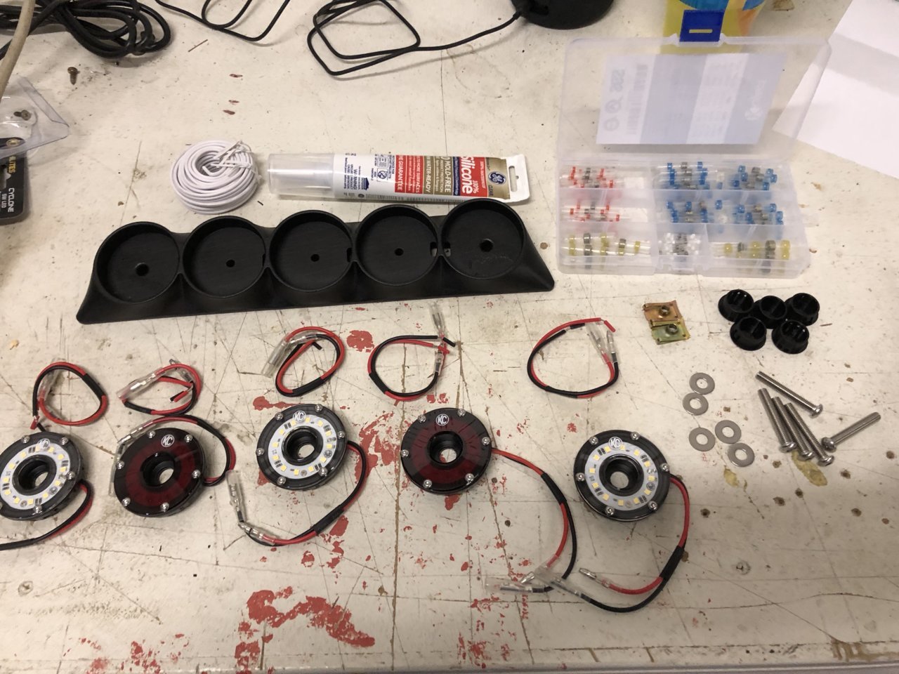

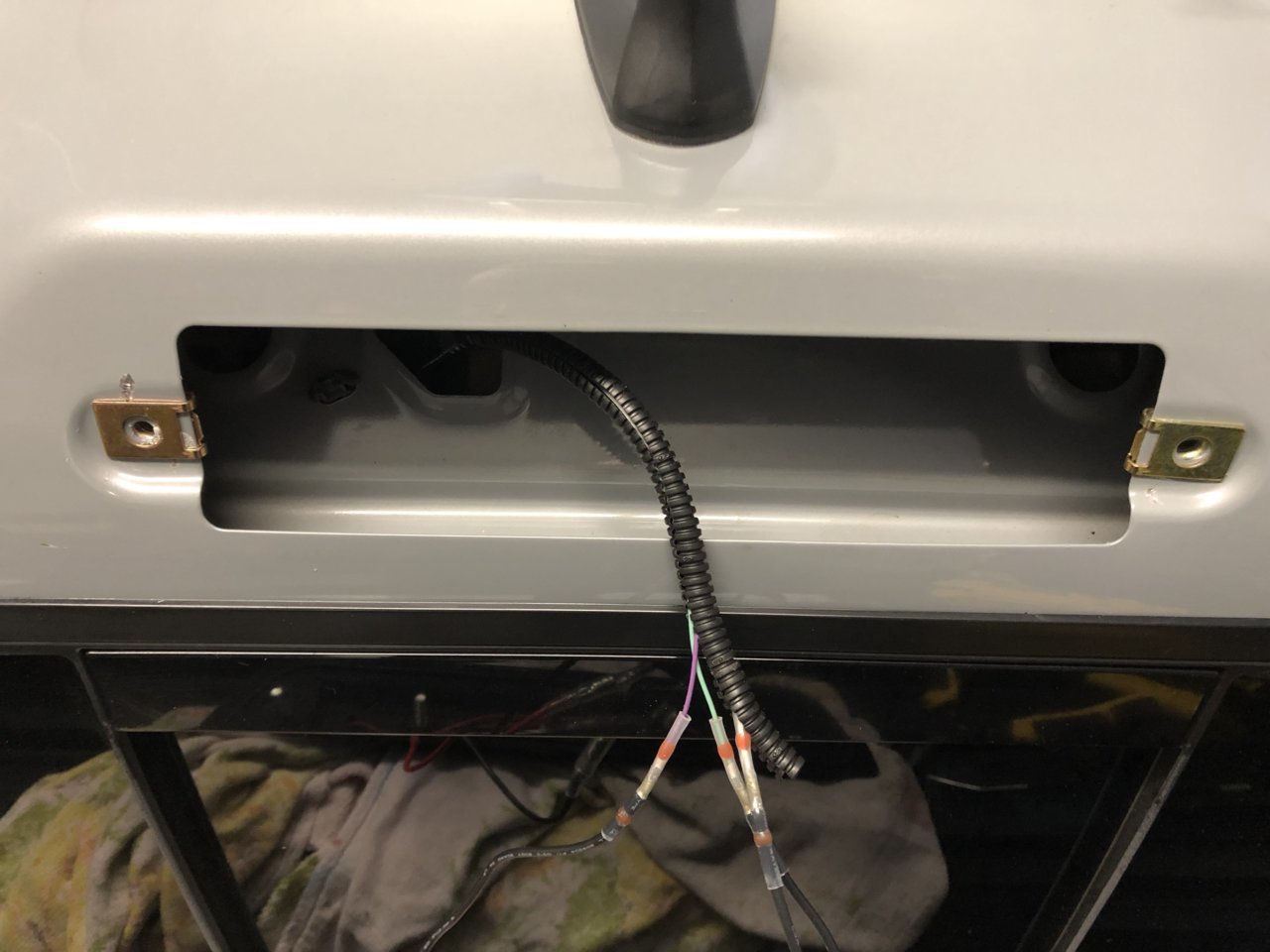

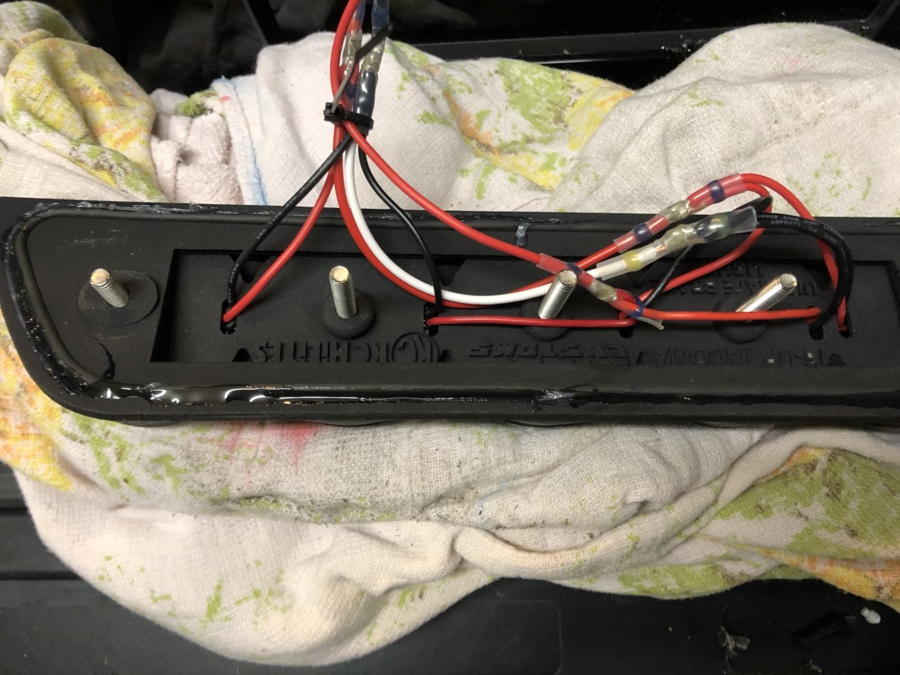

    Got mine installed. I will be ordering a 3/8 NMO at a future date. I also did not wire up the white LEDs yet either, as I don’t have time to pull the headliner and run wires this weekend/too lazy to go through pulling all the interior panels to do it right. So I’ll just tackle it all at one time later. Anyway, pics:
    Installed a new DIY gasket (EPDM rubber)
    KC connections crimped and added to male connector:
    New female OEM connector after cutting off old:
    I couldn’t find plain 3/4” hole caps at local Ace hardware so I went with 3/4” diameter snapping bolt caps which I think look really good and clean.
    Will also be getting some anodized aluminum M3 bolts for the KC’s.
    Personal feedback on the install:
    The KC lights don’t have much in regards to wire length, and soldering in a new length of wire is in my eyes adding another potential failure point, and same goes for their included connectors, so I just worked with what I had. This meant it took a little bit of tugging either way to move the white end KC’s to get to the OEM mounting screws with a screwdriver when it came time to mount to the truck.
