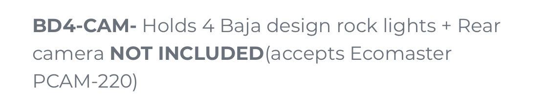

    Well you aren't the only one that learned something today. I never noticed that either because I thought it was just a randomly generated ad.

    @destin_meeks how do you go about buying that ecomaster pcam-fmbr180 bed cam? I've been looking all over and cant seem to find anywhere that sells them, just keep running into the ecomaster product catalog with no buy button lol

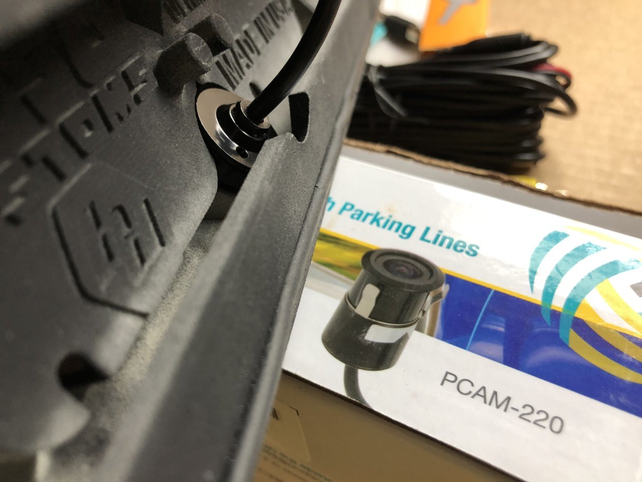

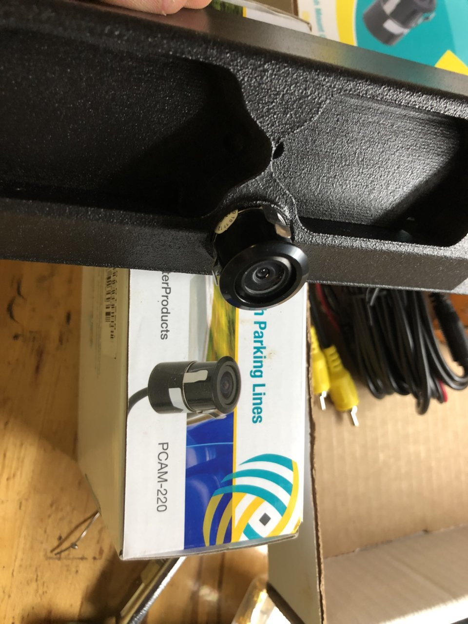

    You having trouble getting it past those tabs? Usually you could push it past and once they're behind the bezel they spring back out and hold it in place

    Not exactly. It’s the back of the enclosure that is stopping the camera from getting all the way through... I mean, I could grind it out, but based on the camera recommendation, I would rather not. I just want to make sure I got the right camera...

    P220 Cam fits perfect. It was the model I designed around. It's not the back clearance... it's the little silver clip -which you will have to remove(really easy, camera just unscrews apart). The silver clip has a larger diameter, and it was such a tight squeeze as it to fit the camera body in. Here's some pics;

    Thanks @MESO! I knew you'd be able to answer my question. \m/ \m/
