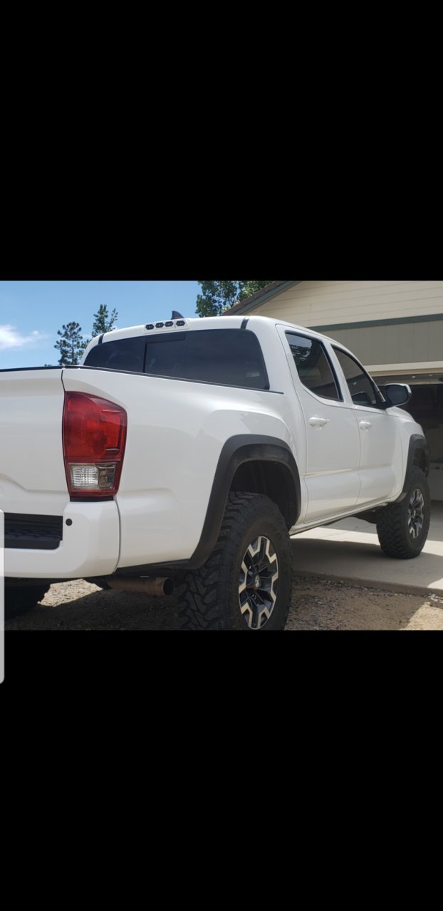

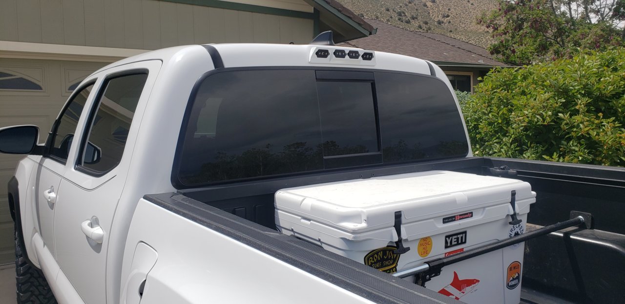

    Hey friends, thanks to @MESO and everyone on this thread, I was able to finally get my light installed today! My wife and kids won't look at it anymore and are tired of hearing about it, so figured I'd move this way lol.
    Thanks so much for the wiring details, painting idea, install method, and of course this site! Can't wait to install puddle pods when they arrive!
    Cheers and thanks again!:bananadance:

    dude the color matched looks rad! It almost looks like the lights are floating until you look closely.

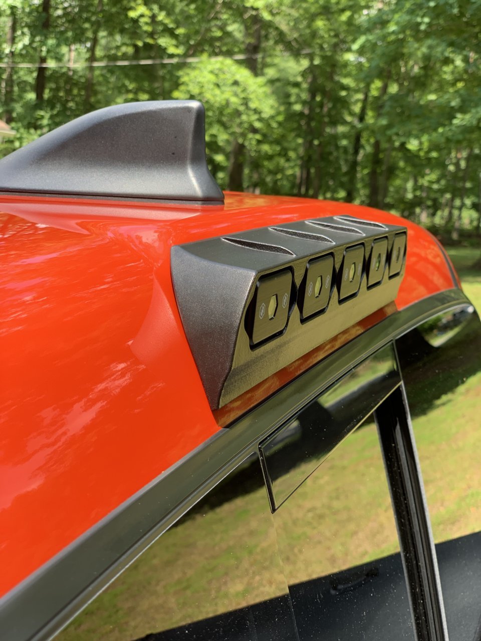

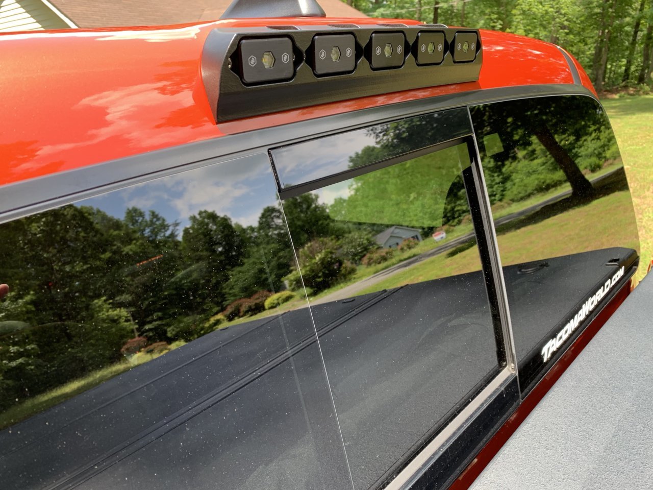

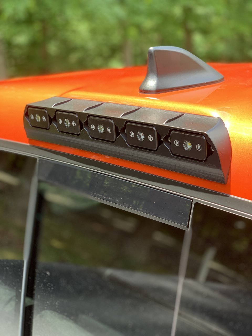

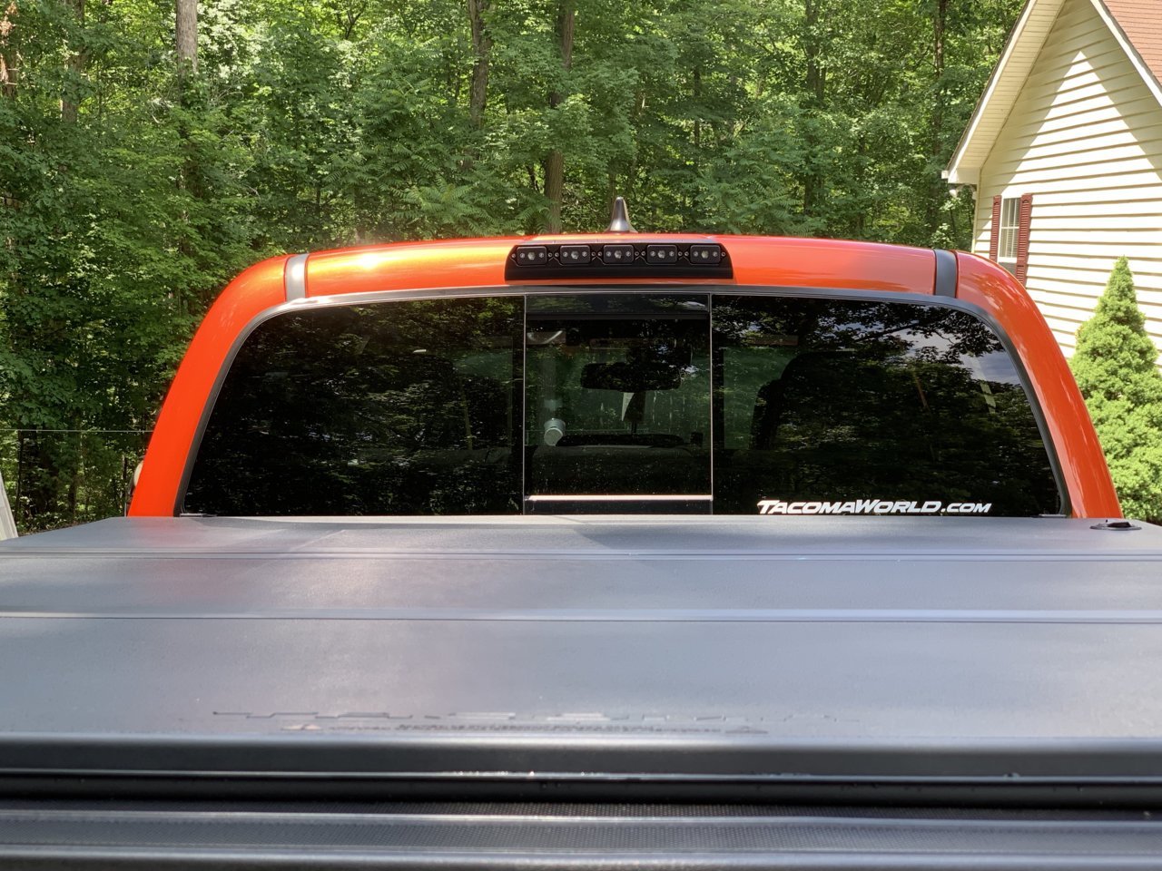

    Finally had time this weekend to install the ultimate 3rd brake light.
    MA%CASzSTf6S7J+bzXOdWQ.jpg c1y5H4miR3+yPVtMN2h2SQ.jpg fullsizeoutput_13da.jpg pPeEWEhXSjuDKmQvsY63Rw.jpg

    Love it!!!

    Thanks Meso, so am I it changes the whole look of the truck.

    Looks awesome! This is the design I want when they are available again.
