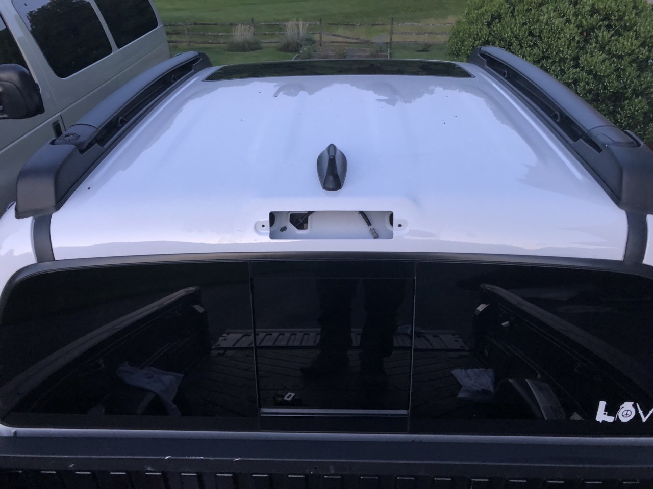

    Yup I used a 1/2 drill bit here...it was just big enough to free the metal bolts from the plastic...came right off and cleaned up nice. No need to drop the headliner and disturb the wires that are glued into it if you have a powered sunroof.

    Yeah, you're not drilling through the bolt. Just enough to weaken the plastic around it.

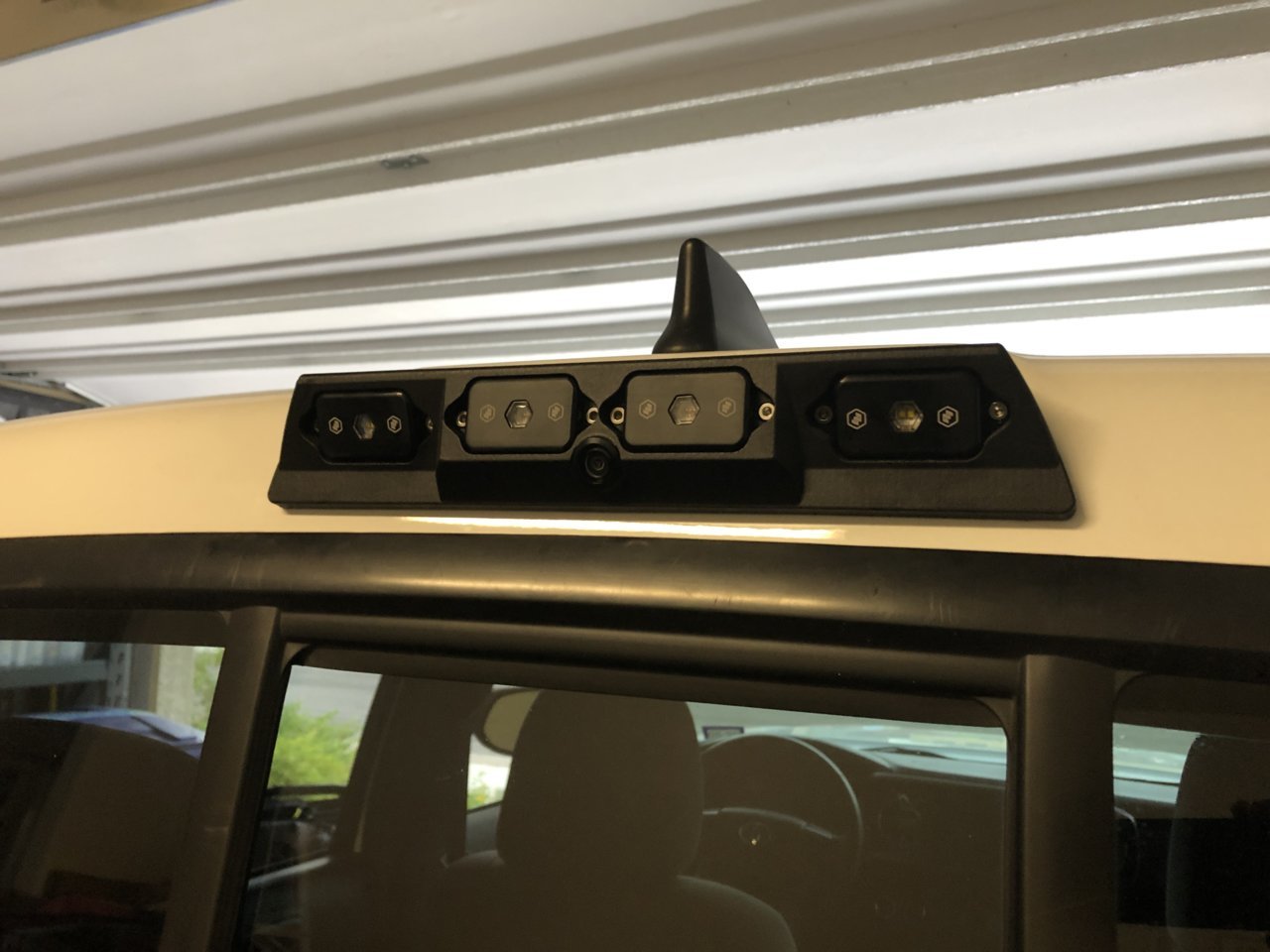

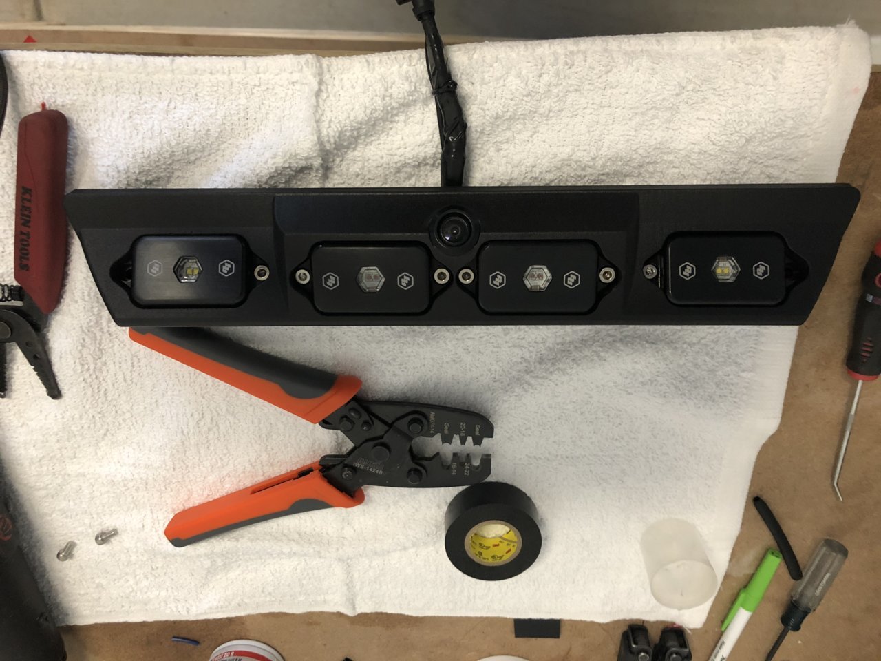

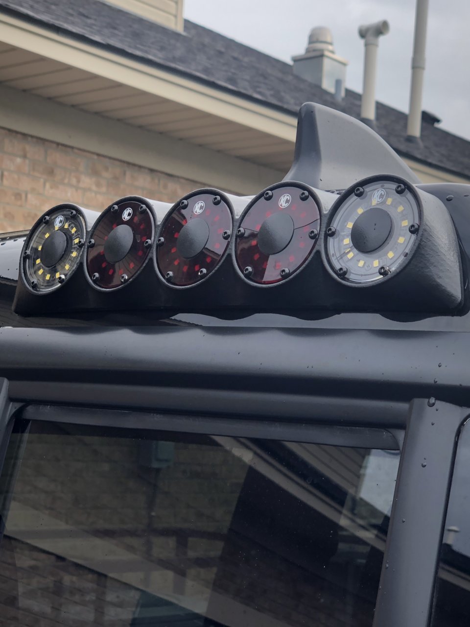

    Finally, she’s done! BD4 Cam, 2 red at center, 2 white cargo lights on the outside. Ran the cam to the head unit and will be using the Car Solutions TTG2 to interface with the OEM steering wheel controls and retain factory use of the tailgate cam under normal operation. I went ahead and used some Delphi connectors to connect the factory wiring with the third brake light.
    UPDATE: TTG2 has been installed and all works as intended. Overall, everything was straight forward to install. I did take my time wiring and removing panels as I’m a little OCD about that kind of stuff. Plan on a couple hrs for the BD4 Cam and you’ll be good. The most time consuming part is running the camera wire from the third brake light, down the rear pillar and back up to the head unit (I ran it and on the passenger side as I already had the glove box dropped.)

    That looks great. The cam is really hidden in there.

    It really is. You can’t hardly notice it unless you’re really paying attention, and even then, it’s subtle and does not look out of place. The cam is a very snug fit as well, so water penetration or rotation of the cam itself will be a non-issue.
    Great job on the housing. You put some serious time and thought into the build!
