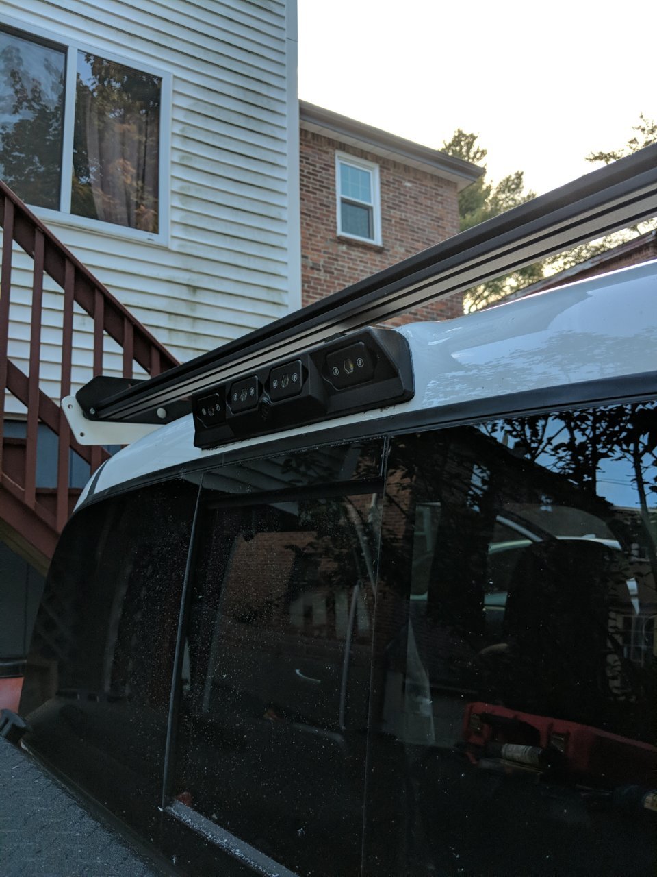

    Finally took the time to get this installed. Haven't set up the camera yet, but eventually...15710818016582587974419822364106.jpgYeah, it's not clean or anything, but it does what it needs to

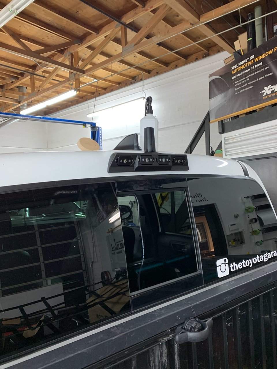

    BD4 NMO! Super easy install!

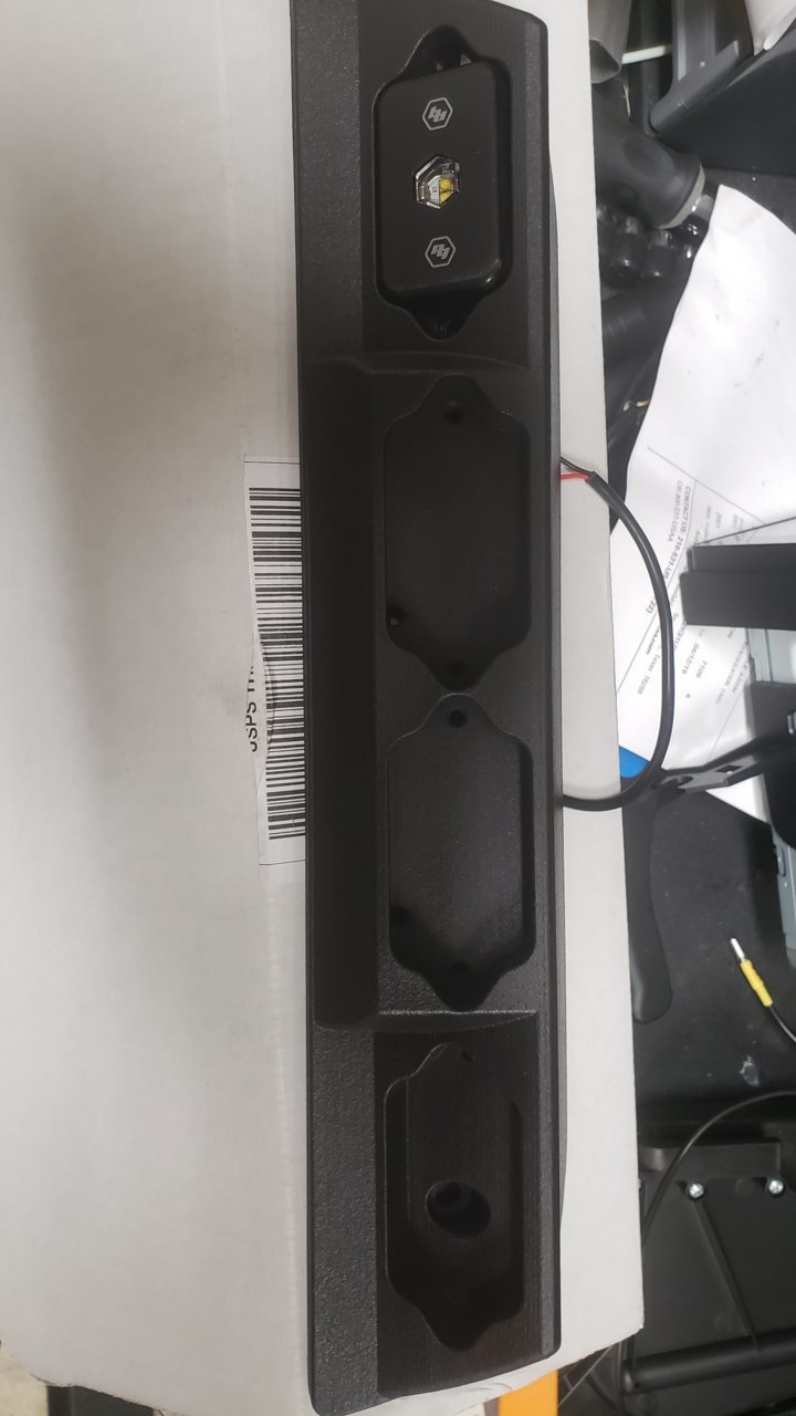

    Is there a threaded insert for the Baja Designs lights? I'm looking at mine real quick wondering how I'm going to attach the last two lights after attaching the housing to the truck.

    It should go in exactly like the others do, just after it gets mounted to the truck. If you could post up a pic, we can get a better look at it.

    The outside lights cover the holes for the bolts that mount the light to the truck. So unless there are threaded inserts for the lights, I'd have to use self-tapping screws. Although any pictures I could find on here looks like they used the cap screws the lights come with.

    It’s plastic and you can cut the thread with the supplied Allen bolt. So, pre cut the threads in the plastic on your bench, remove the two outside lights, bolt up the housing to the truck with lights hanging by the wires, put the light back.
