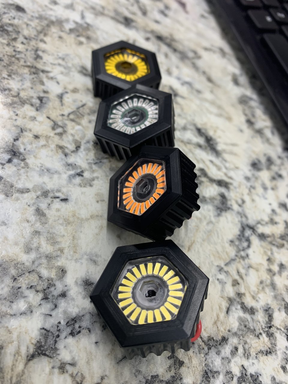

    This is true. The hurdle has not been the housings/brake light enclosures(those are easy and molding has started) but rather the led pods that will be part of the kit (HEX PODS)
    We’ve been through many prototypes and testing and almost there! Here’s some pics of the most recent versions.
    There will be RED, WHITE, AMBER, and BD YELLOW(closest to match Baja designs)

    Dude you've outdone yourself man. It will definitely be worth the wait for one of these. Is there any chance there will be sort of a blank insert/adaptor for a brake light camera?
