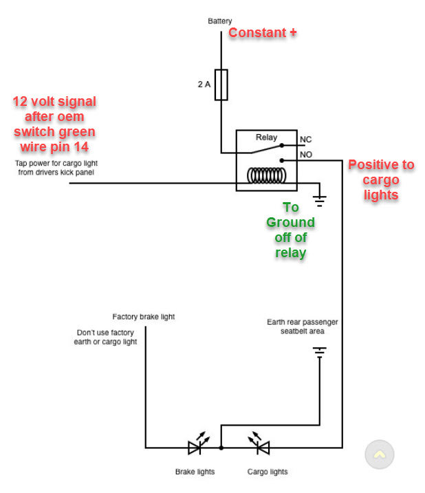

    Like this ? Where did you locate the relay ?

    Yes, just like that, but (constant + is very different to battery + in a wiring diagram). I located relay next to interior fuse box.
    I don’t know where the interference was coming from, so to remove as many variable as possible I went direct to the battery. If you pick up and constant + from the fuse box, you could well pickup the same + the OEM switch uses, in which case, you’ve just done a lot of work for probably no effect. (Unless the interference comes from where the power wire is running in the harness to the cargo light).

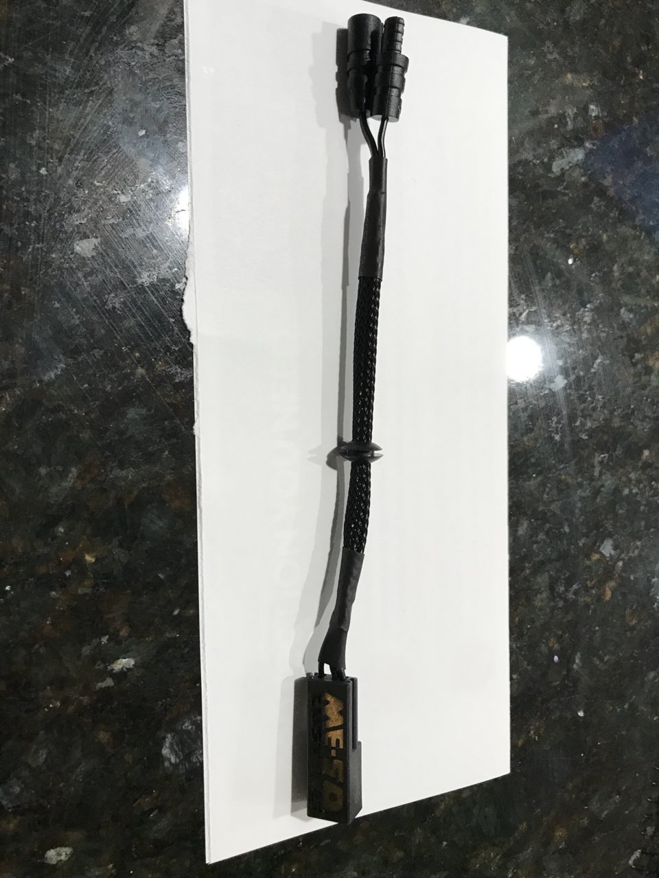

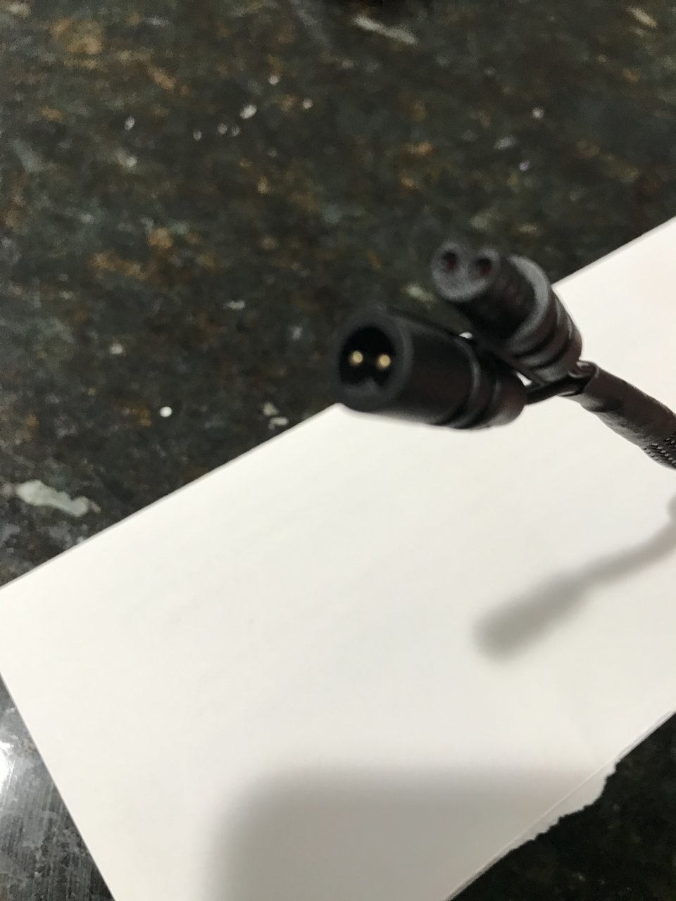

    E4E05483-268B-4079-B278-EE27BA7F4141.jpg 7780995F-B9C3-46E5-BF45-E1BC980275D6.jpg Haven’t taken the light off yet and just want to make sure I have everything when I go to do it. I got this adapter from MESO. Do I need to purchase the matching connections to attach to the bd lights wiring? If so anyone have a link to them?
