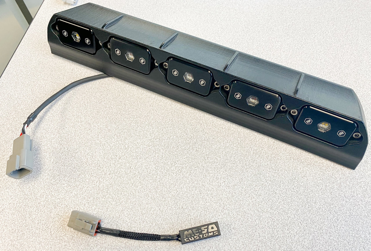

    so thats a first verson 3rd brake plug that isn't really released yet. The 2 small black plugs coming off are BRAKE and CAB LIGHT. They are made to plug into my HEXPODS. IF adapting it to BAJA, KC, etc. You just cut them off and solder directly to the lights of your choice. This way it's still plug and play...and not altering the vehicles wiring:D

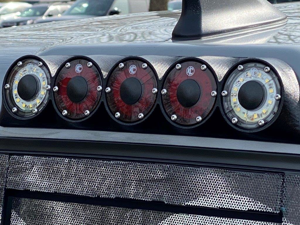

    I finally replaced my KC Cyclone lenses with solid plexiglass I bought on eBay. The seller cut them to 2.2” diameter (just have to tell him in the comments). I drilled the bolt holes. We shall see if these last. I bought 8 of each, so I have spares now.
    I put the black caps under the plexiglass (had to trim them down to fit).
    Here’s the eBay link if anyone is interested.
    https://www.ebay.com/itm/152095930500
    I changed out all the screws too while I was at it. Bought them on Amazon a while back. Black, Phillips head plastic.

    I used black silicone on the rubber gaskets to seal them. They shouldn’t be any water getting in! I also ran another bead around the entire light.

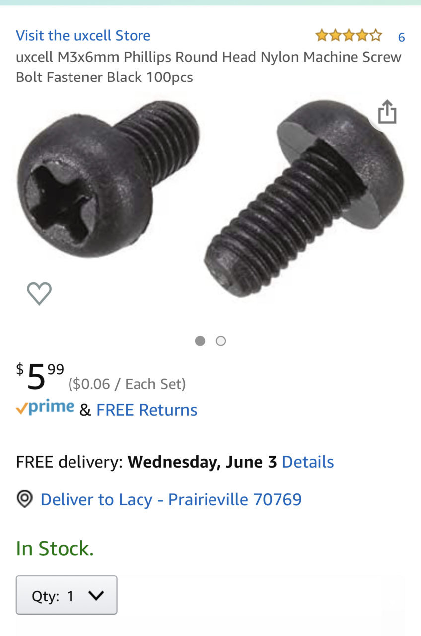

    Awesome job bro. Mine are on order. Do you have the screw size you used?

    M3x6mm

    I got plenty of everything. And for another $22, I can double my supply of lenses and screws. Better than paying another $140-150 for new KC lights just to get new lenses. I really think these are gonna work without cracking. But shit, I never figured out why the KC’s all cracked.
