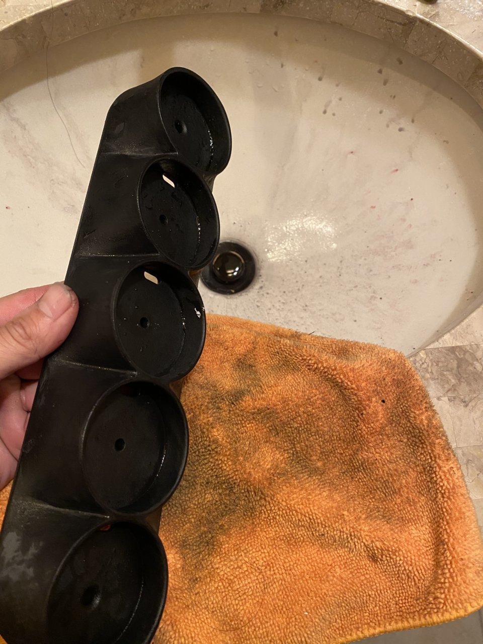

    Question, will this black residue ever stop coming off? Prepping to spray paint, washed it pretty good and the black ink won’t stop running off of it. Will this be a long term issue? 97779975-1CC9-42A6-8C16-6E568124E696.jpg

    @MESO I think my BD4 that I just got seems to have this issue too. I had black all over my hands when I unwrapped it.

    There may be some residual powder and or dye, but let me explain the process which my help. The way these are made is they are 3d printed from a powder into to solid. Once done, the part gets excavated from the loose material. They get sandblasted and most of the power is removed. At this time the parts are raw and grey in color. It then goes into a dye tank where it’s stained black(just for cosmetics). The final step is the exterior of the part is primered and then painted in a black durable coating(to hold up to the outside elements, UV, etc)
    Due to the complex shape and all the nooks and crannys, there can be some leftover powder that gets knocked loose from shipping, handling, etc.
    As for the black stain, any excess dye would be be coming from the backside of the part which does not get sealed/painted. Once installed the interior of the part is not exposed so you would never know. If yours has either, don’t worry it will not affect function, fitment, or longevity of the part. Again, it is not the exterior coating that you are seeing(that stuff is very strong and you would have to chip it off). But any excess from the backside. Hope this helps:)

    Make sense to me . Thanks for the explanation
