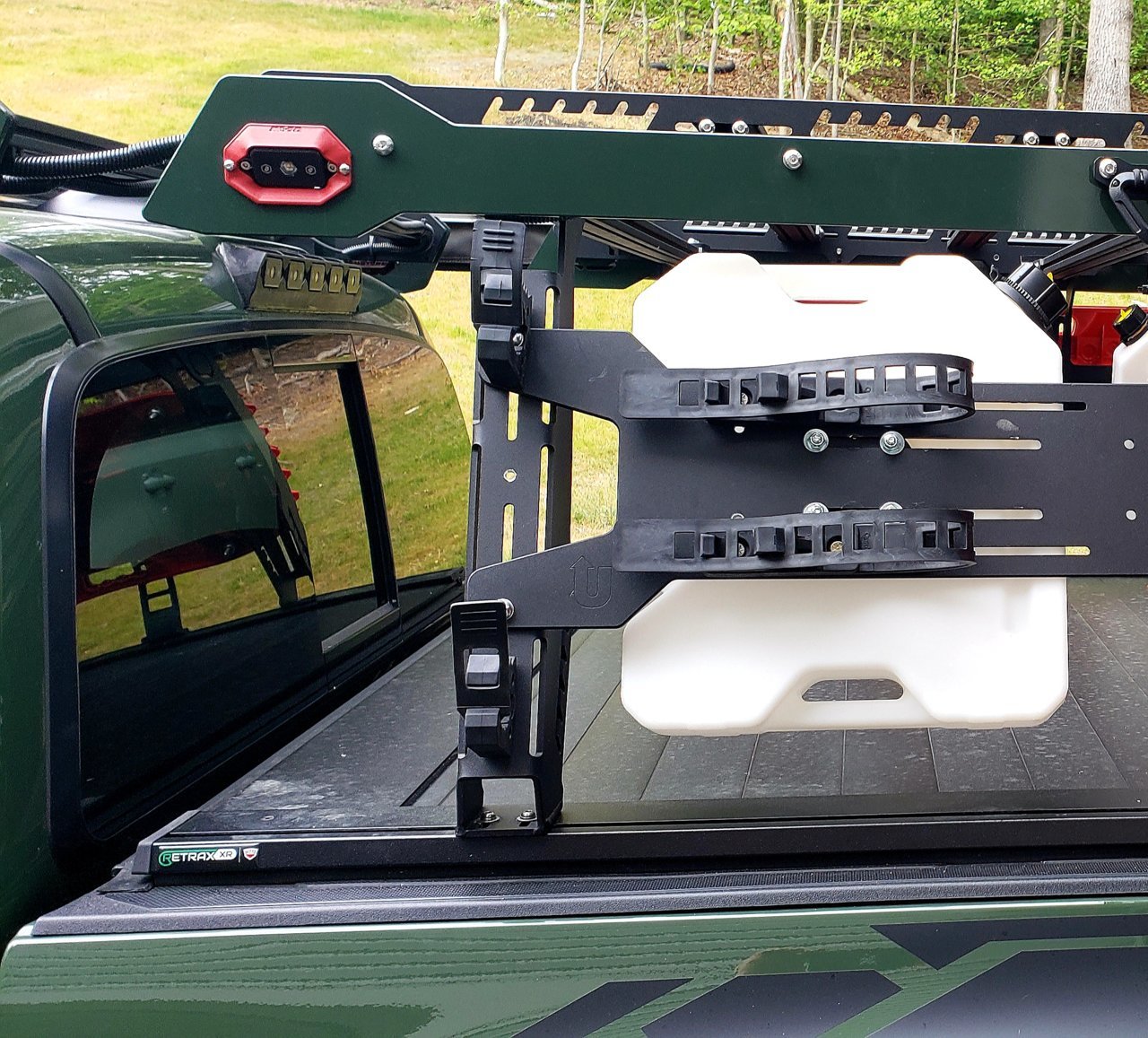

    So I'm going to jump in here for fun! I have the BD5 and I would like to briefly discuss reasons, install, product, etc..
    -I want a bright 3rd brake light! I'm in Virginia and I've had inspections done by very critical inspectors and I've passed with this setup. I've had state and local troopers right behind me day and night and no issues.
    -My setup is 3 red and 2 white
    -Cost was very expensive because the lights are so damn expensive
    -Install was a PITA!!! because as much as I love MESO products, they have pieces that generally are not easy to install (under headlight trim for instance). Had to drop headliner to access bolts, rewire and add extra ground.
    -Product was nice, but I have to admit they can do better. The holes for a BD are clearly off and too small. I had to dremmel and customize my own wire access and because these are 3d printed have a tendency to crack easily, so be really careful and use a lot of gasket sealant.
    -I further my lighting by having two water containers on each side of my truss so when I hit the brakes the whole back interior lights up (technically diffusing the lights). lol
    -Finally, the other year, I lost my beloved FJ that I spent so much money on making it awesome. I was rear ended by a semi truck at a dead stop on the highway. It saved my life and the truck wasn't that bad compared to the vehicles in front of me that I crushed. When I hit the brakes, I want people behind me to know to hit their brakes....no doubts about that. I don't give a fug about how bright you think it is....if it gets you to slow down...job done!

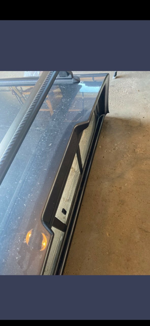

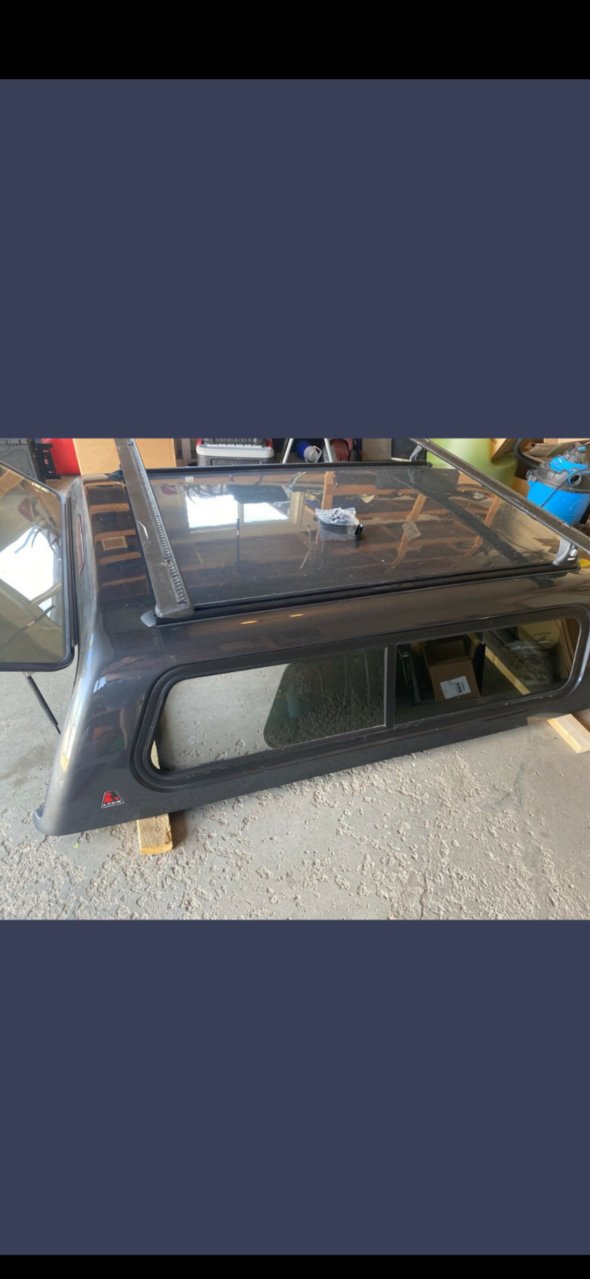

    So what do you think the chances are that my new Leer canopy/topper will fit with my MESO third brake? What I really want to do is sell it now and put the factory back on buy not sure if I can get it off in time.

    7,473
    David
    PNW
    2016 Tacoma OR DCSB 6MT, 2005 RC 5MT PreRunner, 2002 Tundra SR5 RCLB 4x4
    If it were me, I'd remove it and sell since it'll no longer be of any value with the shell on. I've been hoping that @Grossomotto might build us a blank plate cap for those of us with a shell where any light is a waste but he can most likely provide a gasket if you still have your OEM light and you're able to get it re-mounted properly after having removed it?

    925
    I was hoping to get a gasket from a Toyota dealer. My factory one is in perfect shape just need the gasket
