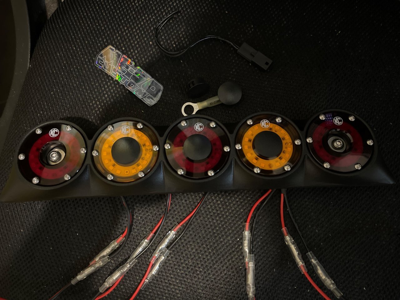

    Could you link the guy that made your lenses and the black bolt replacements. looks good on your truck!
  17. Jul 22, 2021 at 4:55 PM
    #3357
    ChrisIz
    ChrisIz Well-Known Member
    Apr 12, 2020
    #324524
    580
    2023 TRD Off-road
    This is how my KC5's turned out, I am wanting to at least get the some black bolt replacements for the lenses.
