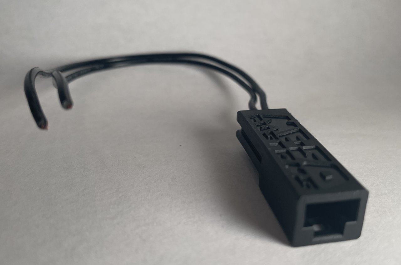

    Any chance you have a photo?
  15. Jul 23, 2021 at 7:36 PM
    #3375
    ChrisIz
    ChrisIz Well-Known Member
    Apr 12, 2020
    #324524
    580
    Texas
    2023 TRD Off-road
    I did not take a picture of it unfortunately. Best way to explain the way it's currently grounded is the ring connector is being held in between the nut clip and the bolt threaded in holds it in place.
  16. Jul 23, 2021 at 7:38 PM
    #3376
    daveeasa
    daveeasa FBC Harness Solutions
    May 14, 2020
    #328079
    7,470
    David
    PNW
    2016 Tacoma OR DCSB 6MT, 2005 RC 5MT PreRunner, 2002 Tundra SR5 RCLB 4x4
    Yeah, I’m mostly curious to see the MESO plug part. In post #1 he mentions cutting off. Maybe there is a subsequent post with a photo of a connector?

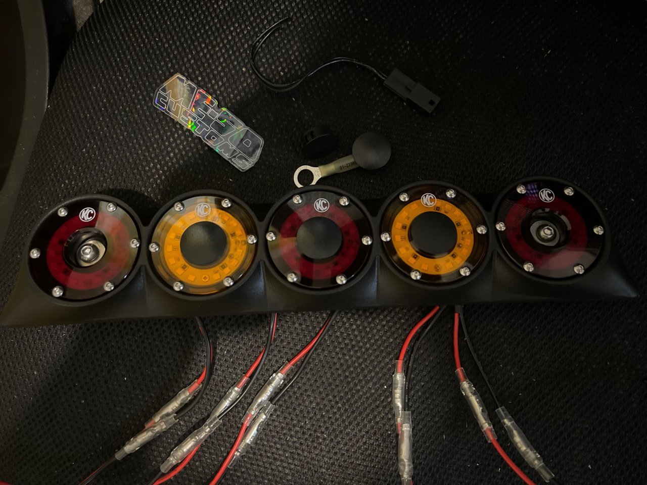

    Is this what you are looking for?
  20. Jul 23, 2021 at 10:04 PM
    #3380
    Age315
    Age315 Well-Known Member
    Mar 9, 2016
    #180757
    999
    AJ
    Castle Rock, CO
    2016 BBP Yeti Mobile
    TRD Baja Kit with JBA UCA's 1/2 inch spacer on top, Medium Dakars with BAMF hangars and super bumps all around. 285/75/16 Cooper Discoverer AT3 XLT's on graphite TRD faux beadlock wheels. Pro skid powder coated black with Pelfreybilt aluminum mid skid and aluminum gas tank skid.
    This is the one I have and was curious why it didn't have all 3 wires.
