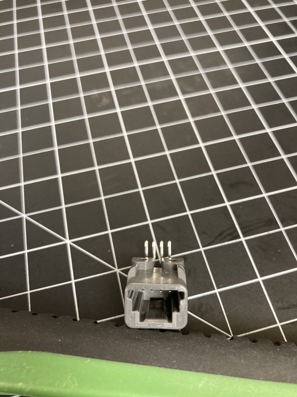

    Wow, he 3D printed his own connector? Badass.
    Doesn’t look like an exact match but I’m guessing it works well enough?
    I assume there is a good reason only 2 wires are tapped?

    Correct. The 2 wires coming off my plug are BRAKE and CAB LIGHT power. You will connect these directly to your new lights. The GROUND from the OEM connector is not used(as we have had issues of it back feeding/causing interference) so that is why it’s removed from myharness. What you will do is tie all the
    ground wires from your new lights and crimp them into the yellow loop connector supplied in the kit. Slip the loop into one of the “c-clips” that are used to anchor down the light. I included instructions with all lights.. but I’m not the best user guide creator :oops:
    Nice little break out board! Looks like the ECT connector (which unfortunately is a diff shape). I searched high and low for the male connector that would plug into the factory overhead and never could locate it. It’s molded/integrated into the brake light housing which may have something to do with it. I ended up tooling my own mold and molding the custom connector so there’s no guessing on fitment.

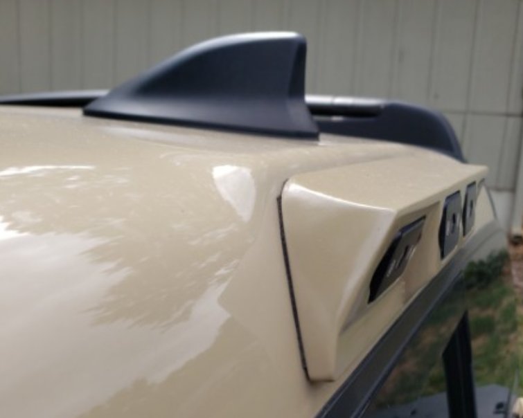

    I used the paint in the picture. Its nothing special, just some model car paint I had left over.

    As I recall, everyone was just using flat black, non-gloss spray paint… I’m sure krylon and the like. Some painted the whole thing and used a qtip and cleaner to wipe off the LEDs. Others (me included) just used small squares of mask tape to cover the LEDs and removed when it dried.

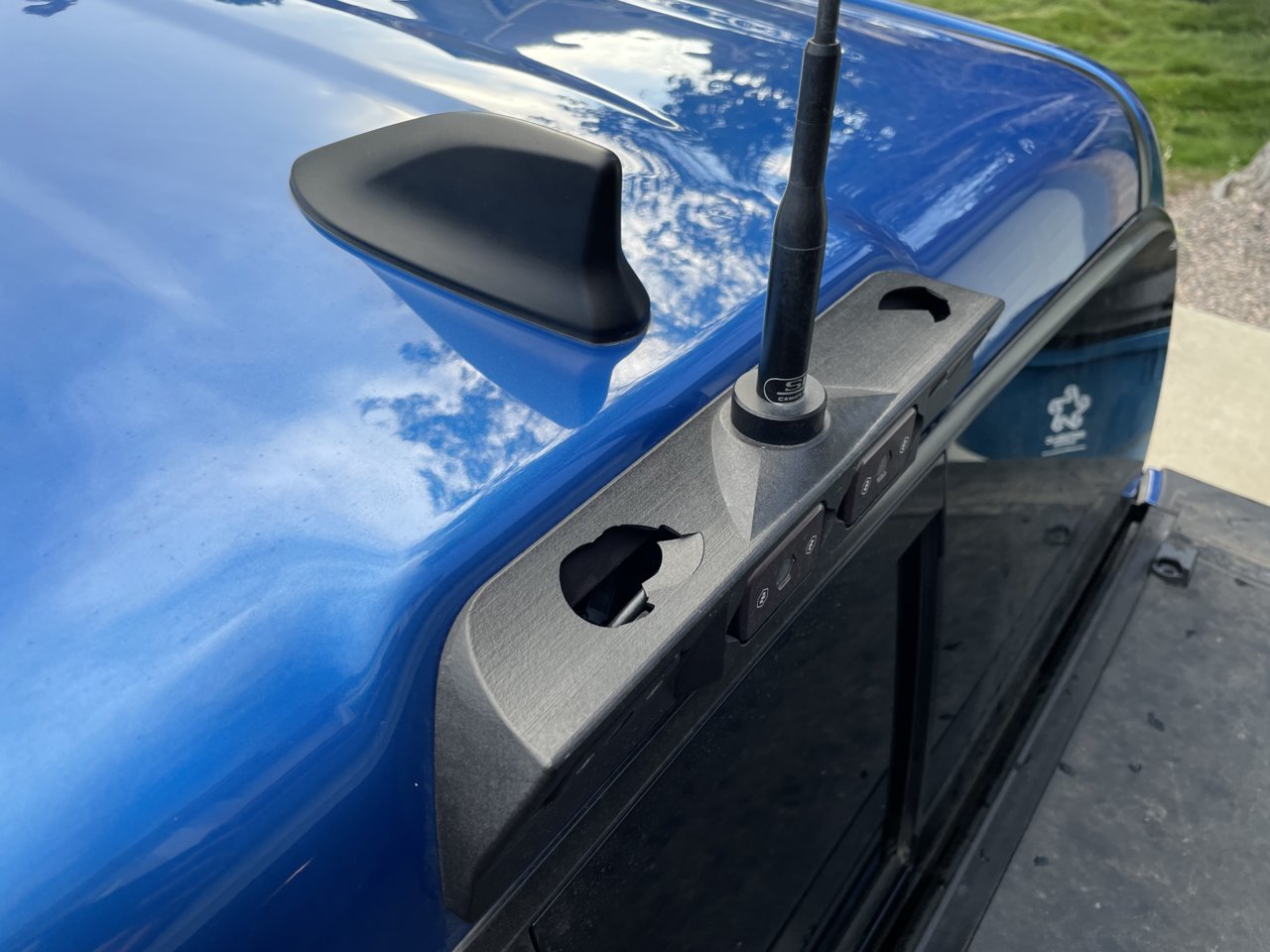

    MESO includes a round rubber gasket that creates a compression seal. I checked the length and glued the ends together to complete with no gap.

    really like the color match. not sure I would trust myself to get that completely sealed with just weather stripping

    Honestly, MESOs seal works fine. No need to silicone it to hell. It’s not a bathtub.
