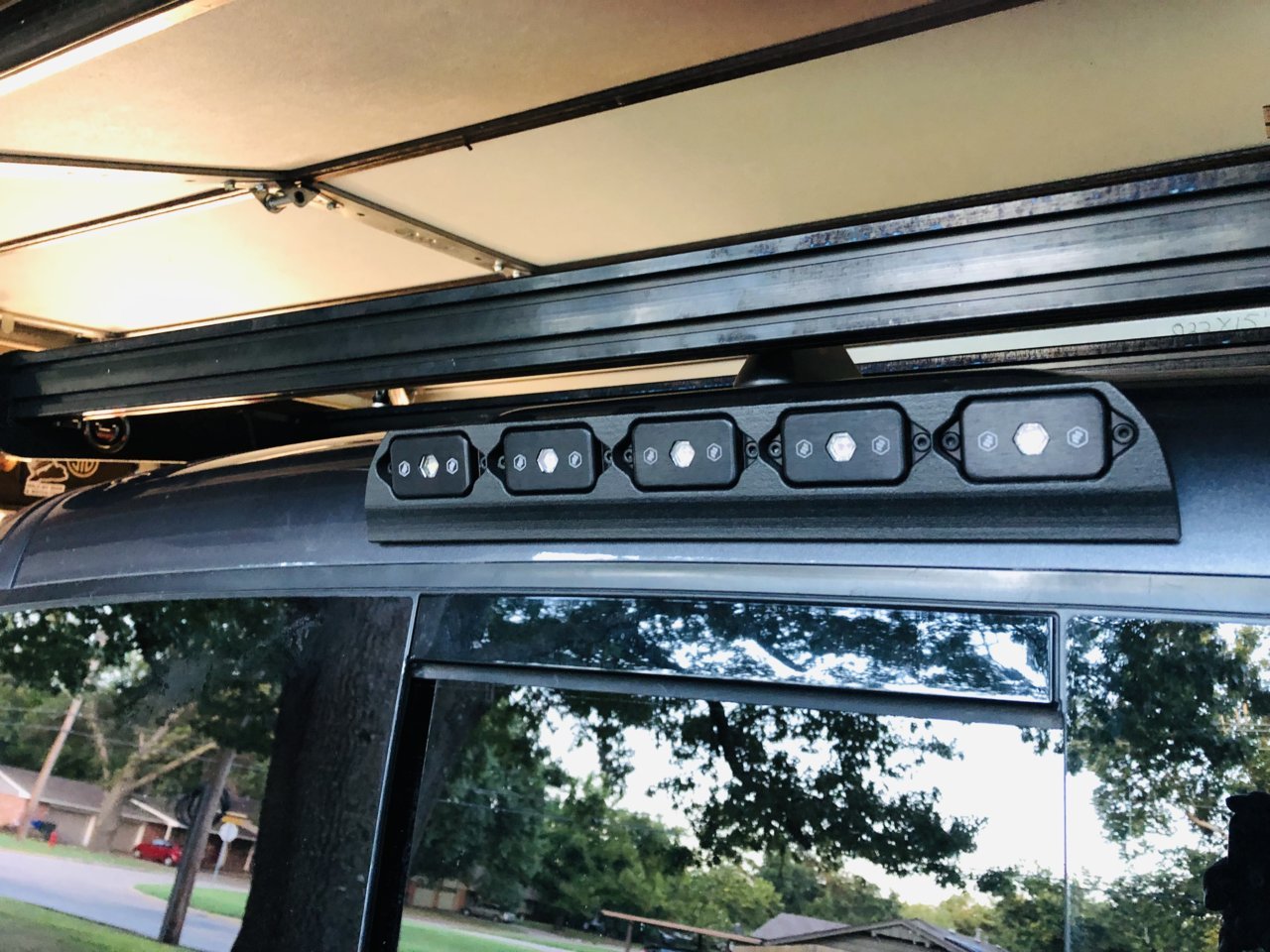

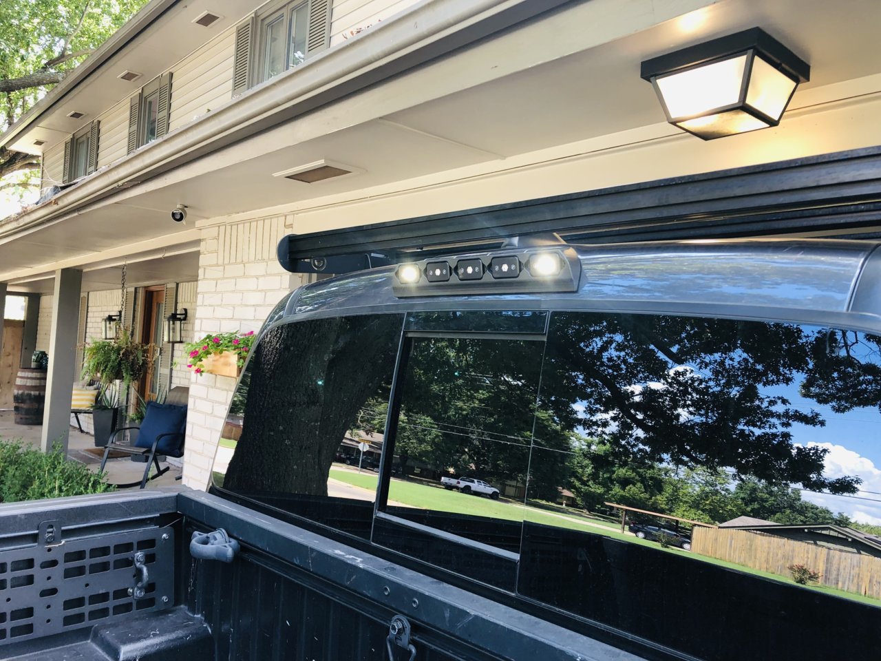

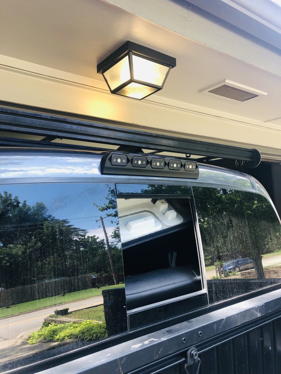

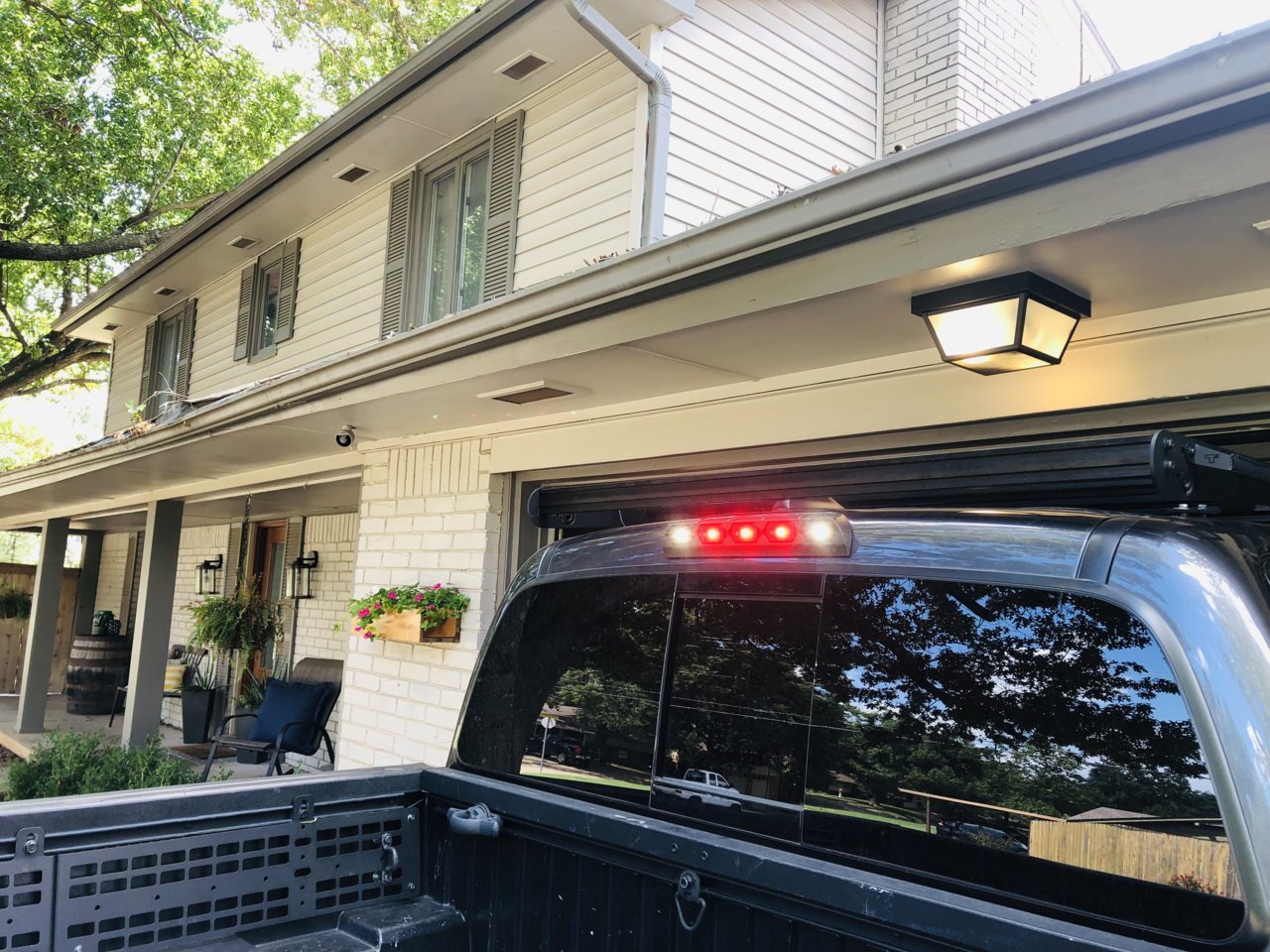

    Installed! @kmorgan3 made it plug n play and it took me all of 15 min!

    Yes but does not include putting it back haha. I actually put some Noico sound deadener on the roof while I had it down and messed with my molle racks. As you can see from the pic I did all this tinkering after posting. Also my OEM brake light basically fell off when I breathed on it (which was kinda alarming really). But it was about as easy as an install gets!
