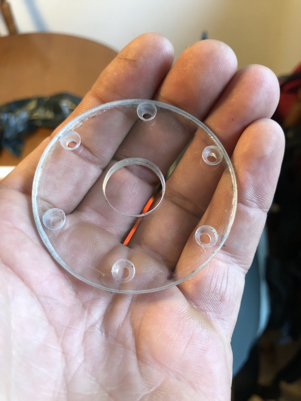

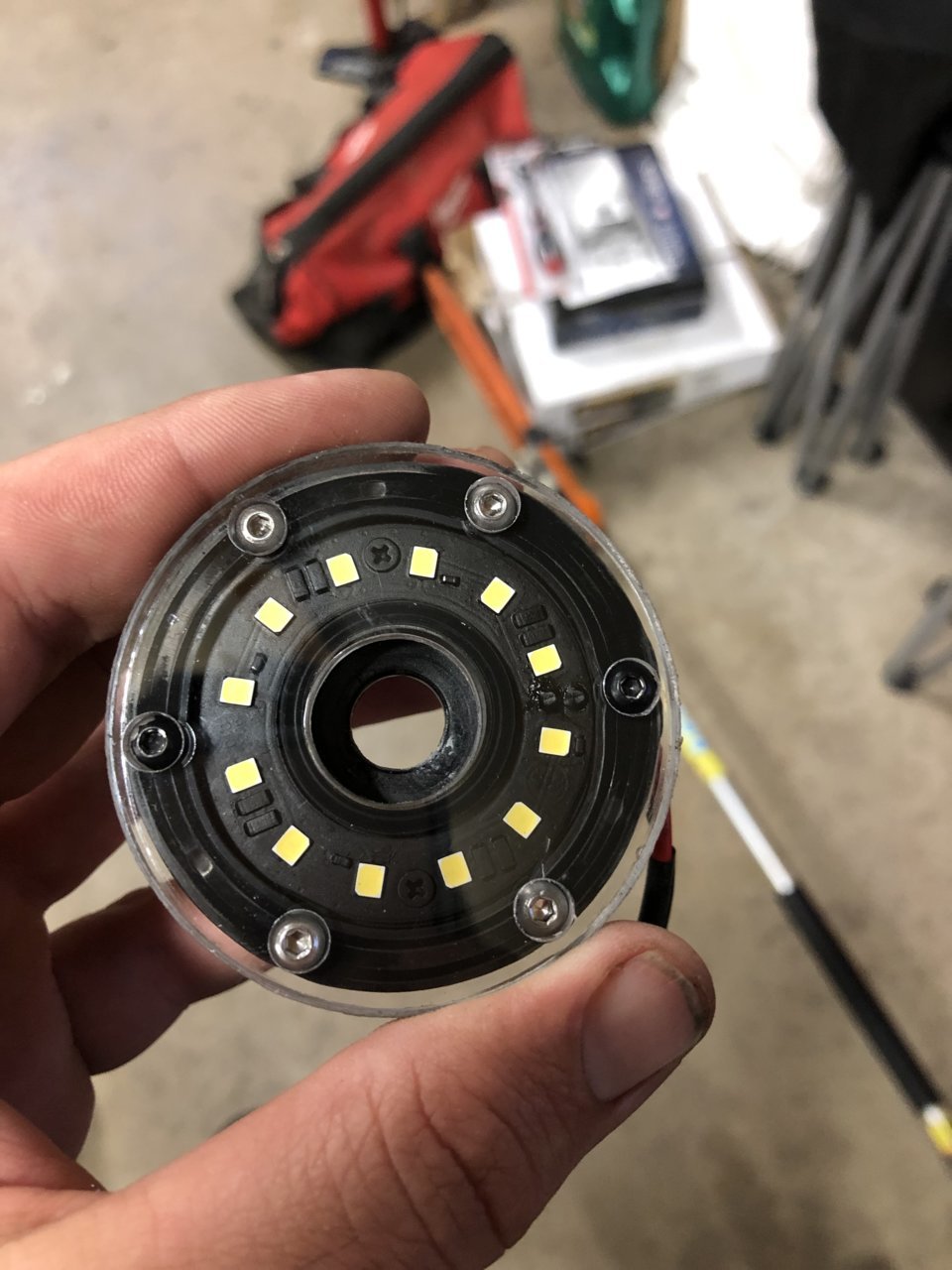

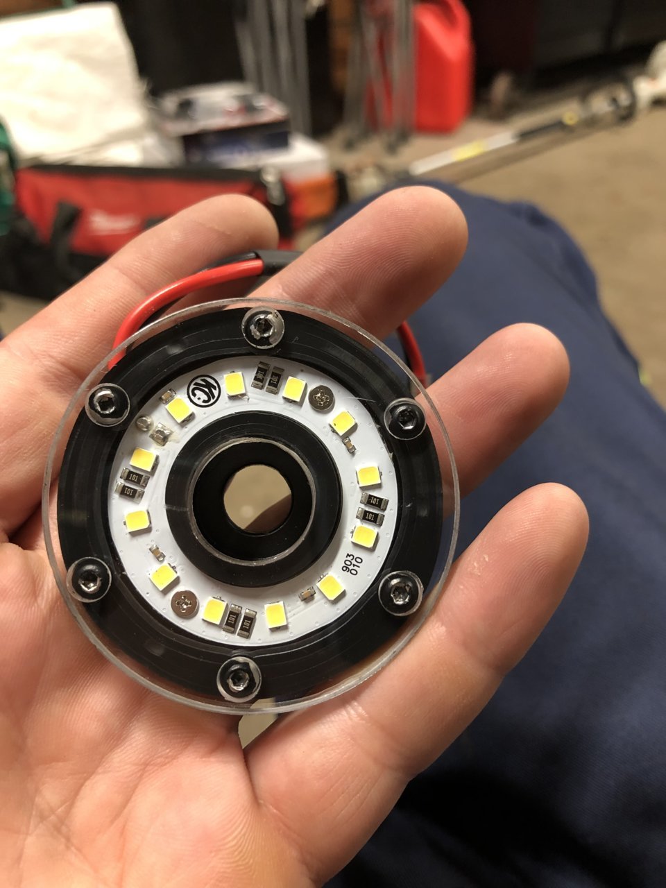

    Oh and I made my own damn lenses for the V1’s, they won’t fit in Meso’s KC5 housing but I’m just using all my old cyclone’s from my KC5 as rock lights now and replaced these ones with new V1’s for the KC5. I saved 3 out of 5 of my old ones before they got water damaged so a new lens and they’re good to go.
    Made these out of polycarbonate, it’s twice as thick as the original lens so I had to recess the holes to sink the screw heads but I can apply as much torque as I want now without worrying about cracking the lens.
    The level of precision was me free handing these with a 2.5 inch hole saw and a few drill bits, didn’t measure anything, just went by eye since they’re going under the truck and I was planning on sealing them with silicone anyways.
    and since I only had 3 old ones I used a brand new spare red one I had laying around and removed the lens for my home made lens.
    and now I have a set of trouble free clear rock lights.

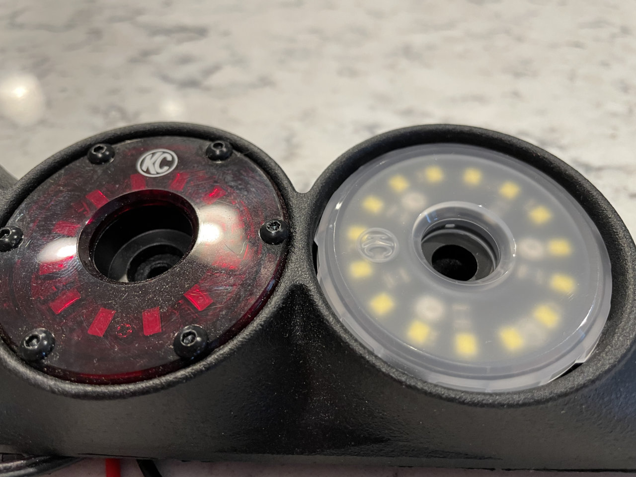

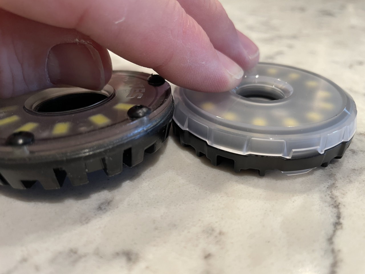

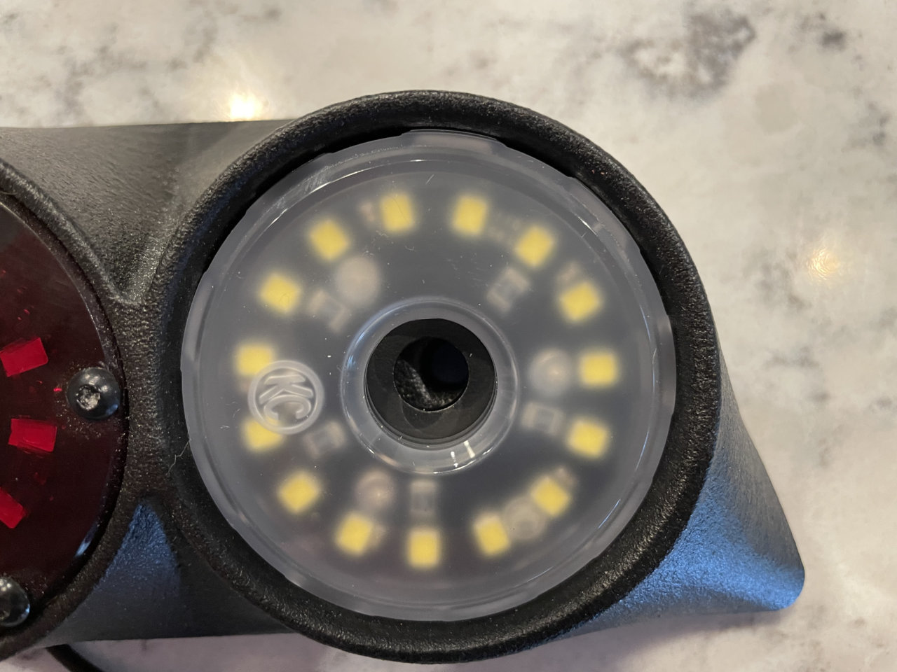

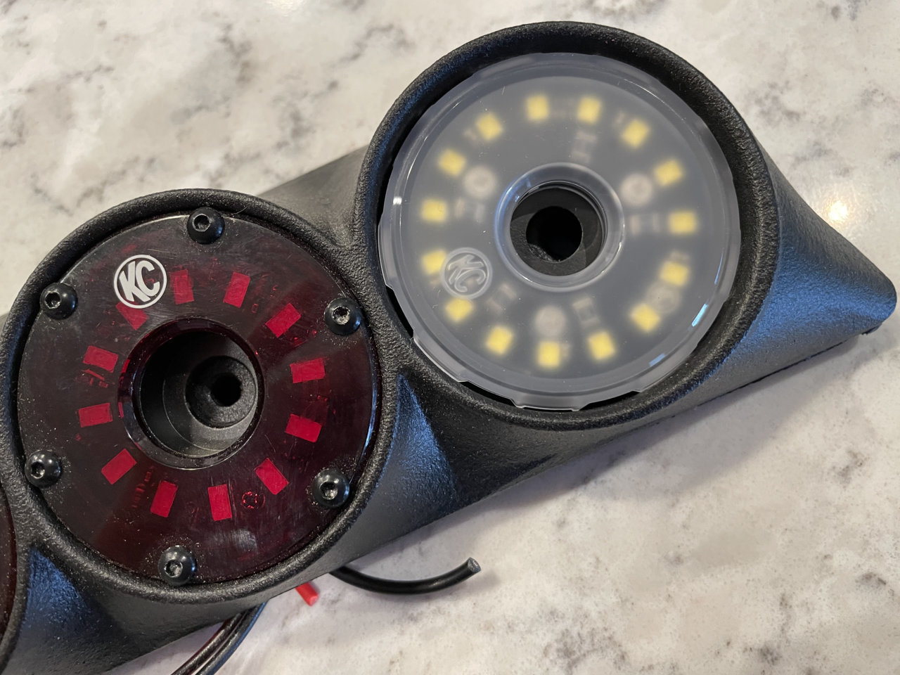

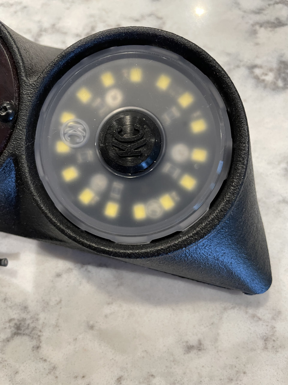

    @MESO

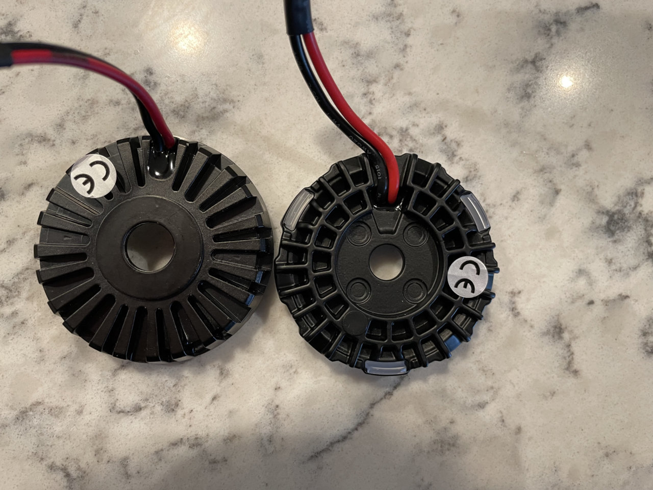

    so the new cyclones I ordered showed up today. deff a small amount more shallow. still fits in the 3rd brake light housing but not as tightly as before. will be fine once the bolts are installed. nice that they come with their own cap covers now. im glad these new ones are weather sealed I think the -50 winters aided in the failure of the ones currently on my truck.
    new one on the far right if you couldn't tell.

    Looks like KC finally took our input with the Blacked out PCB boards lol. The lens looks much nicer as well. Maybe I can tweak the KC 3rd brake light to make it more shallow so the lights don't sit as recessed. Also will help cut down the overall profile of the housing.

    The new cyclones clear lens looks cloudy/diffuse compared to the original clear lens cyclones.

    sorry. They was the diffuse lens

    One could simply install a Teflon washer in between his current KC5 and the new V2 cyclones to make up the gap.
