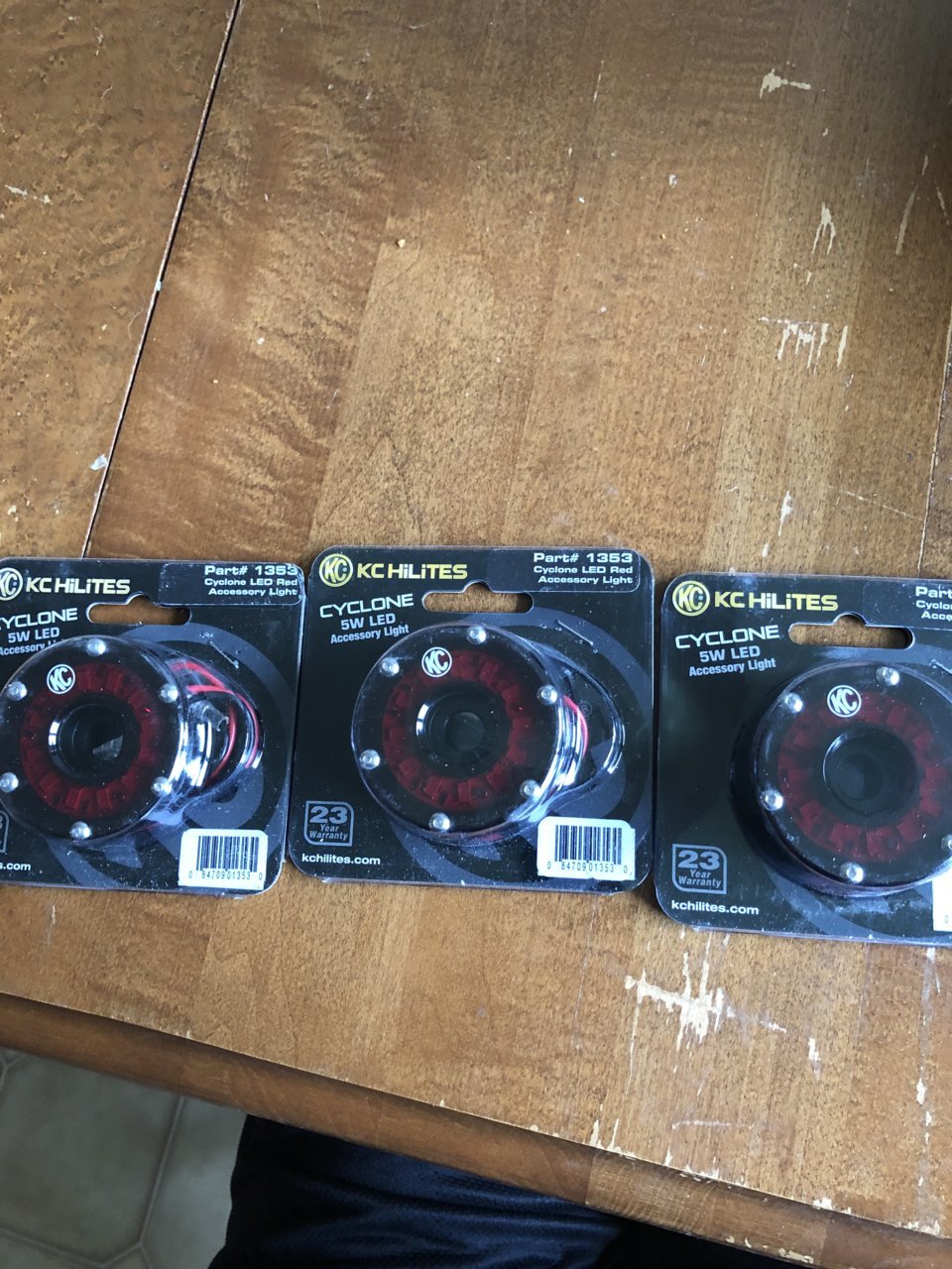

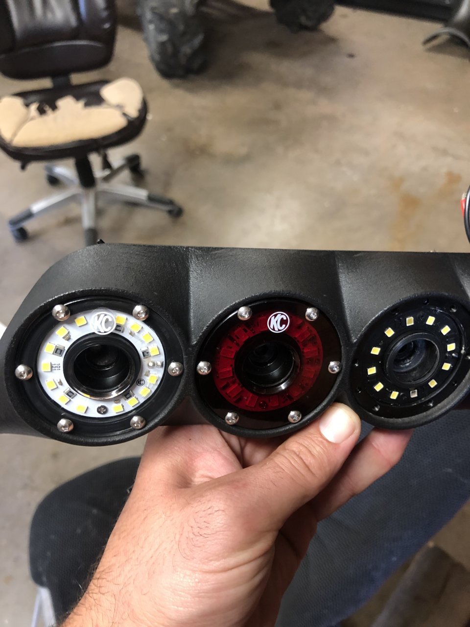

    Here we go again for the second time around, zero intentions on removing the lenses this time to paint the boards, therefor if these crack too and the warranty gets ignored again there won’t be a fool me 3 times, I’m just going to walk away from this mod. Unless of course the hex pods get released and are trouble AF free.
    Also just noticed out of the 11 cyclones I’ve bought over the years I have 3 different versions of the V1 cyclone.
    First 6 I bought 2+ years ago are all the same, the 2 clears I just bought off Amazon are different than them and the 3 red’s I just bought from performancelifts.com are different than both.
    from left to right we have the new Amazon clears, the new reds from PL, and one of the original 6 with a painted board and the lens removed.
