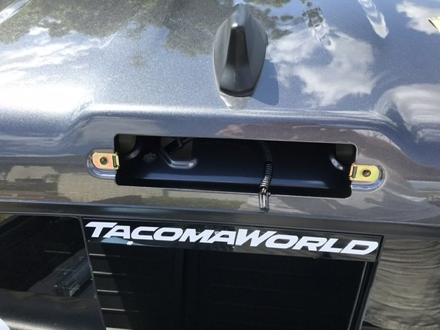

    Once you get the OEM light off, you can reach in through the hole and remove the OEM nuts and bolts.

    Thanks dude. So you did the outside method then. I think this probably makes more sense. Appreciate it

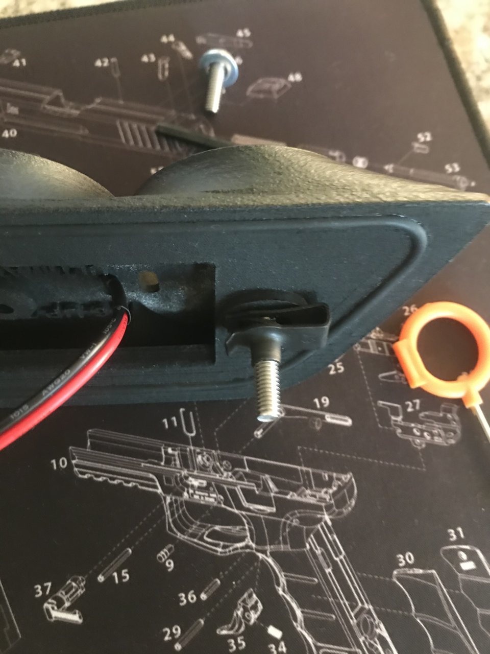

    It’s easier…. I did the original method and it’s more work. The difference is a destroyed OEM brake light (the gasket is ruined either way). When you open the slider, you can reach in through and into the headliner for anything you need to accomplish. It’s no issue with the new part as the bolts go in from the outside.

    Correct. The housing is studs, the nuts are flange nuts. Since you’re putting clip nuts on the body, so the bolts go into them. This is what you have when doing the KC5…

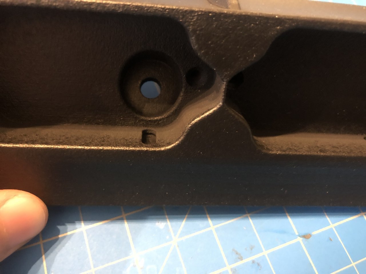

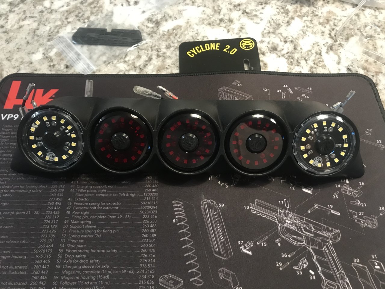

    Hey everyone (and @MESO included). I’ve pre-wired about 20 of these for different people, and I just came across a bracket where the holes weren’t drilled for wire management. Has anyone seen this before? All of the ones I’ve wired have had it all pre-drilled, but it looks like the printer didn’t do it on this one for all 5 slots:
    I’d really prefer not to go rogue on someone else’s stuff and start drilling at will. It kind of looks like the wire management hole placement itself is kind of off in this bracket too compared to the others I’ve wired. The two end holes are directly in line with the integrated gasket. The 3 other holes are all in the exact same clock spot, whereas other ones I’ve wired have had the holes more strategically placed so the wires run neatly. Come to think of it, the ones on the ends that are in-line with the gasket are going to prevent the customer from mounting this (even if I drill through) because there will be a wire smashed against the cab instead of inside of the mounting location. I guess that’s why the other brackets have had the holes clocked differently.
    Was there a design change?

  12. Feb 28, 2022 at 10:23 AM
    #3492
    NoOne
    NoOne El Taco Guapo
    Feb 6, 2018
    #243575
    6,136
    Ø ©
    Gulf South
    2022 Tacoma DCLB OR (AT) - BC
    2018 SR5 - (Sold) 2018 OR - RIPieces 2022 OR - BluCrush
    I do recall in the early days, @MESO did a 2nds and OOPS sale. There were various pieces/parts and this may be one of them. Since you have a reference, I’d consider drilling the correct location and just fill those to prevent nuisance collection.

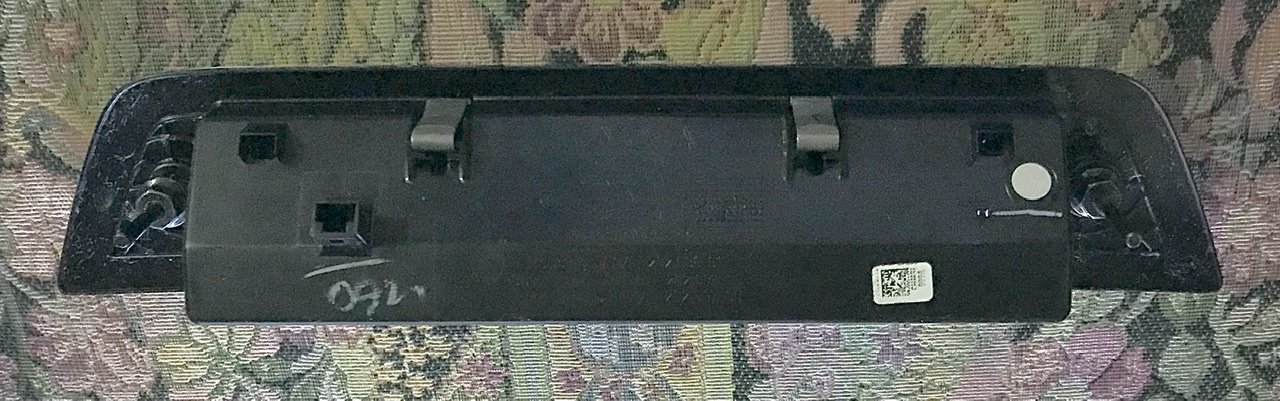

    EDIT: I’m adding a picture of the OEM assembly with the flange nuts on the studs to assist others with what they are looking at in there.
  13. Feb 28, 2022 at 10:36 AM
    #3493
    kmorgan3
    kmorgan3 Redside Electric, LLC | VLEDS
    Aug 22, 2019
    #302994
    1,952
    Kyle
    PNW
    2020 4Runner SR5 Premium | RAM 1500
    Good to know. Since this is an oops I figure it'll just get replaced; they didn't purchase it as a factory second. I'll have the customer contact MESO's support.

  14. Feb 28, 2022 at 10:48 AM
    #3494
    MESO
    MESO [OP] Major Modder Vendor
    Feb 16, 2015
    #148809
    16,292
    State of Jefferson
    2016 DCLB TRD HELLCAT SWAP
    No design change. Looks like you have a BD5 from the pics. This housing does have all the wire slots, but the BD5 is a little tougher to route. I just tested one in the shop. I suggest using thin wire to snake though first, then attach the BD wire to it and pull it through. You may encounter some residue powder when fishing the wires through.. just remnants of the print. Easy to blow out.
    Hope this helps!

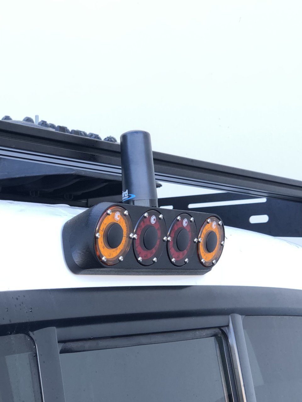

    Finally got around to installing :taco:48DFF6D0-57C4-401F-83CC-9968A1F87A67.jpg

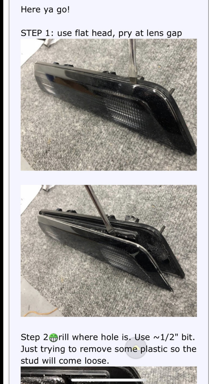

    Thanks for the awesome post. I’m going to reference it when I do the install. Hopefully within a month now that it’s warmer. Question when you are talking about drilling a little bit You’re talking about the holes on the truck right?

    He probably is. I had to file mine to add a little more width as the left bolt was under a little inboard tension forcing the bolt to go at an angle.
