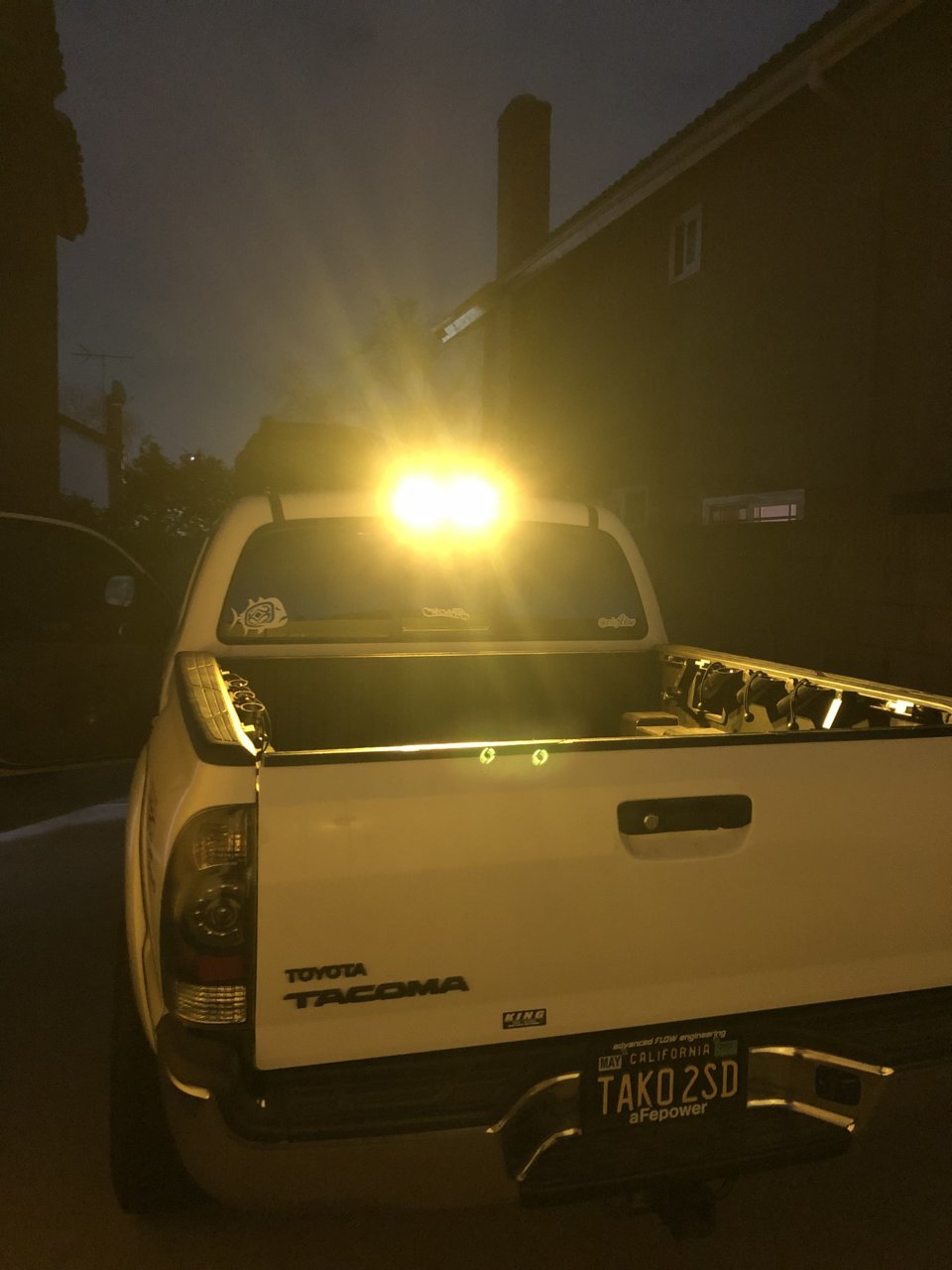

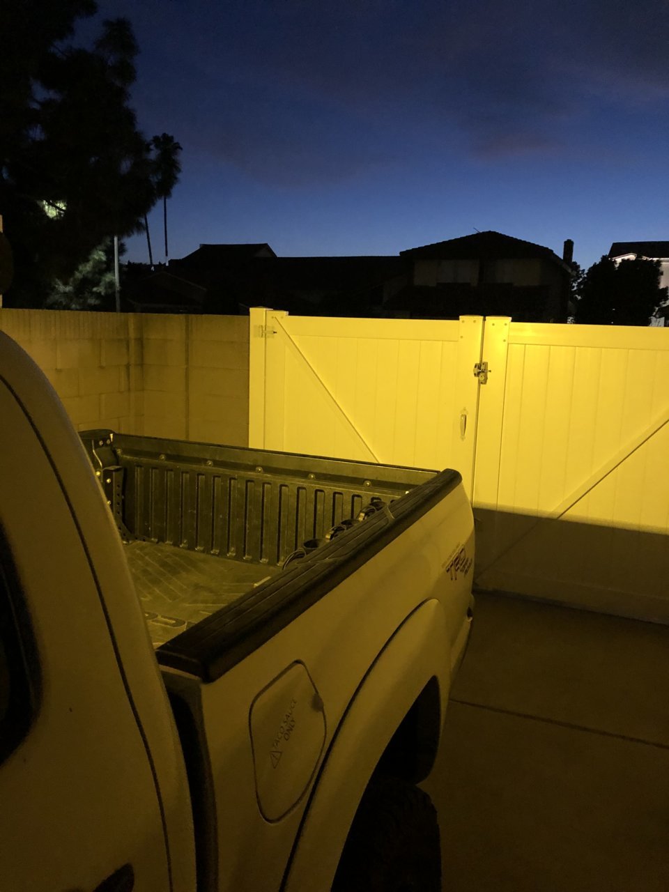

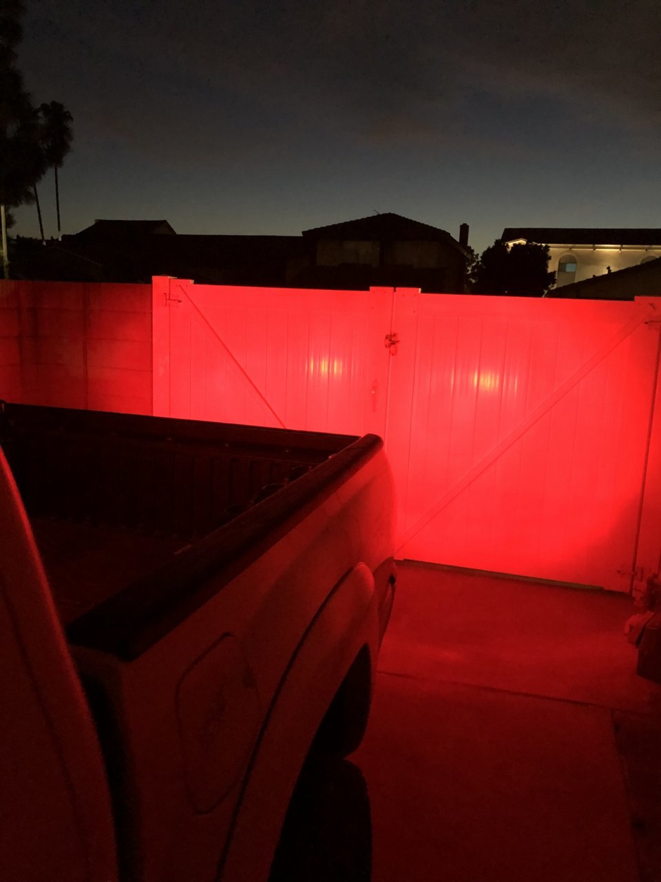

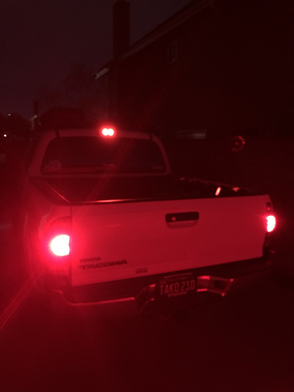

    Kinda want to do this mainly for some yellow chase lights if these things are bright enough, dont really wany any lights hanging off the bed or rear bumper. Got a night shot of em?
  18. Apr 6, 2022 at 9:30 AM
    #3518
    brickflair
    brickflair Well-Known Member
    Sep 10, 2019
    #304860
    116
    Cerritos, CA
    '08 White TRD Offroad MT
    WeatherTech Mats +55hp
    You won’t be disappointed. The ambers are 10 times brighter than the red brake lights.
