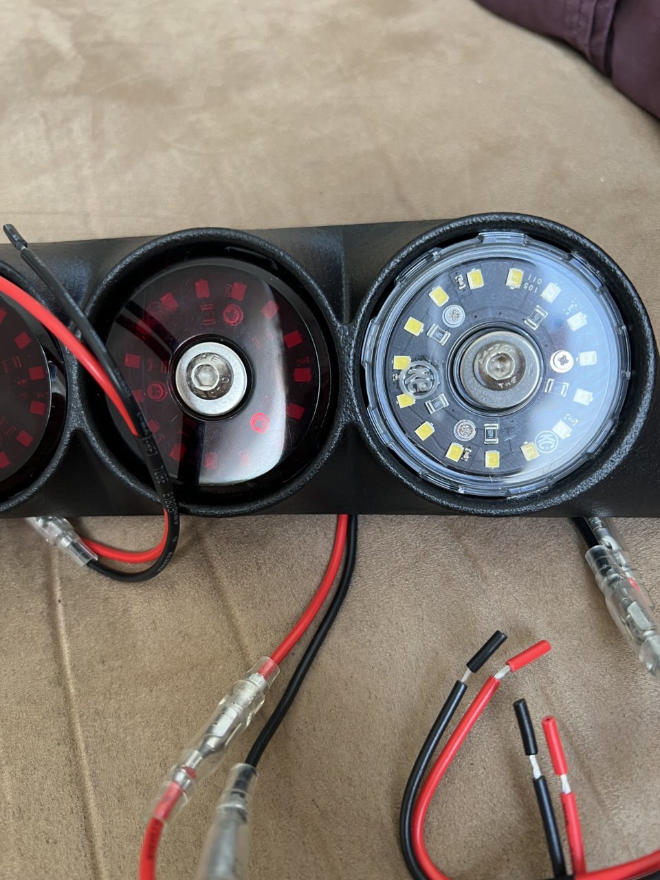

    Quick question, my outer holes are crooked when I screwed them in. I also aligned the KC v2 so the wire comes straight out of the light into the hole(to the side so the logos are crooked, idc about that). The lights themselves fit perfect. I thought I read about people slotting holes and assumed they were talking about the truck. Is the fix to just slot the outer holes a little? I’m siliconing them before install anyway so it really shouldn’t matter, right?

    the covers on the V2s can be popped off and put back on so the logo is upright. they are a pain to get off though.
    yes people are widening the bolt hole opening on the body of the truck.

    It’s really hard to see in the picture but I meant the kc logo on the board itself. I was thinking if it was oval in any way it would need to be a certain positioning. But it was a long shot on that one.

    ahhh yeah its stuck like that. I can't even see it on the diffused ones I have. The right bolt hold on the body is a little oblonged but it still needs to be widened a little

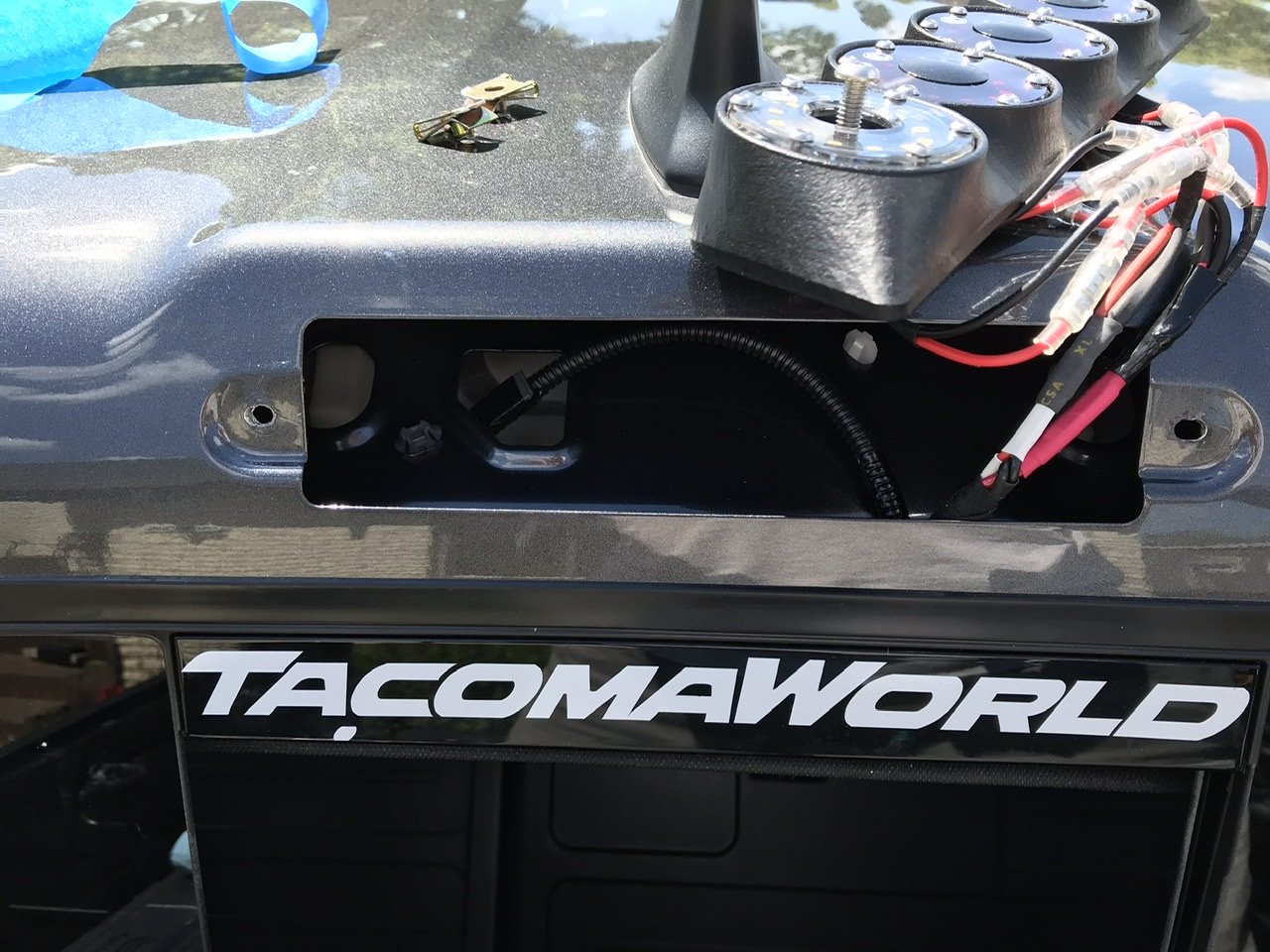

    I widened the left with a round file…. Potato = Potato

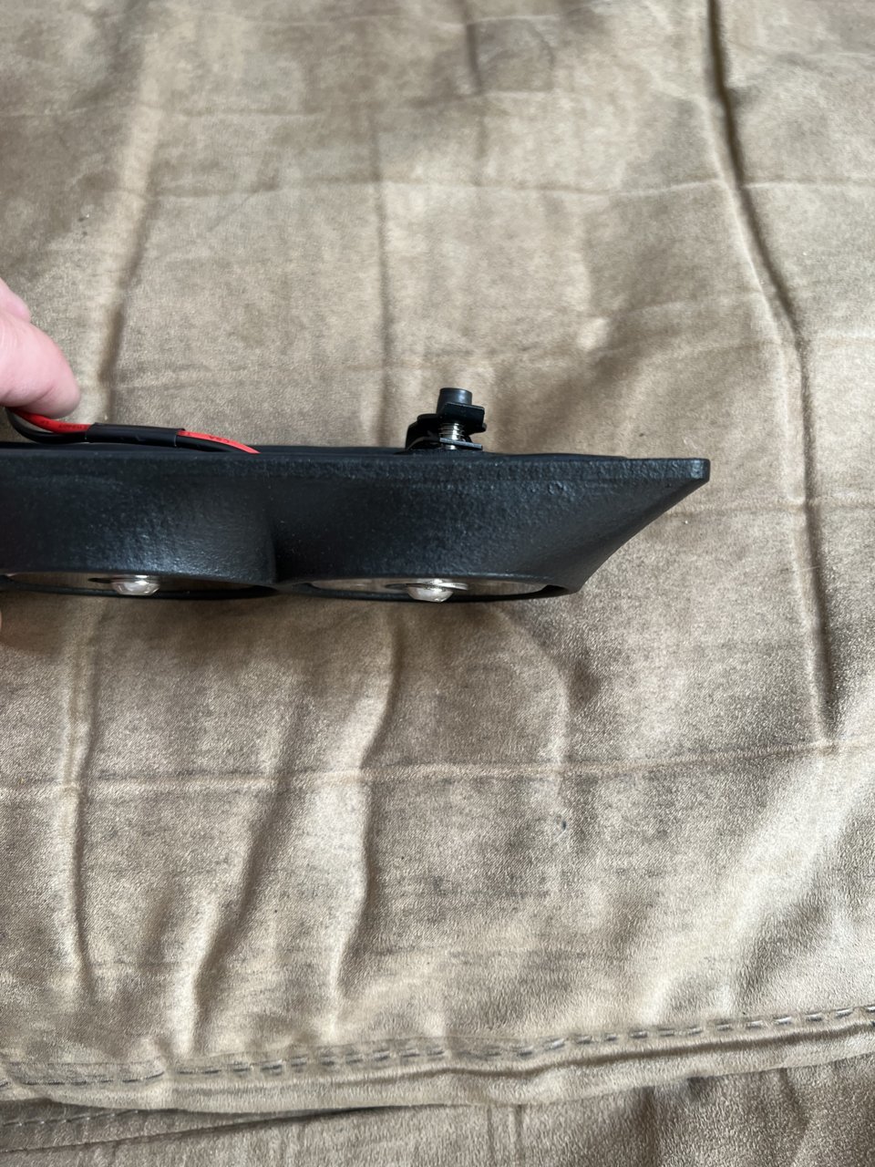

    It wasn’t a whole lot, but there isn’t enough room between the bolts at their furthest points. Since the hole is elongated on the right side, it made sense to elongate outward on the left side.
    With the bolts/covers I can’t speak for v2, but I put a small rubber washer behind the KC to seal at the bolt as well as airgap for cooling (the heat vanes are on the back). I also used one under a washer on the front side. If I didn’t have the caps, I would have just painted the screw/washer satin black.

    Found this photo that may help… I used the bolt in free state to mark what I needed…

    thanks for the picture man. So to make sure I’m understanding you fully. You first filed the left hole a bit and then lined up the light without the clips inserted on the left and right. You aligned the bolt from the the light to the fully exposed cab holes to see how much more if any you had to file?

    Bingo. You can see the curve to the left side of the left hole, where the bolt cut the paint, telling me how far I needed to go. When I first started to install, the assembly started to bow out, which told me the bolts/nut were too close together. That’s when I took it back apart and started looking at what needed to be trimmed. I’m sure every truck is somewhat different, but the same.

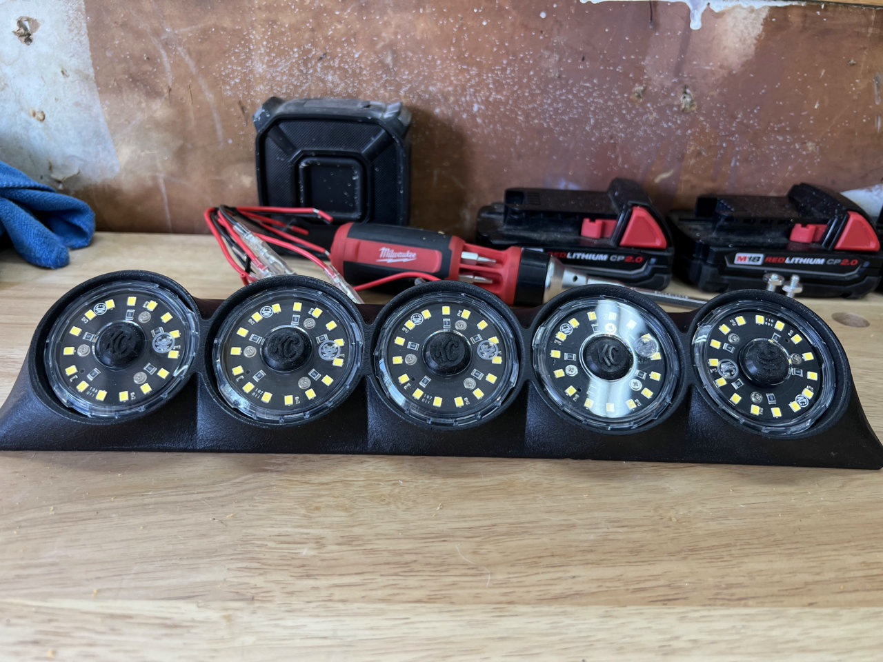

    I believe the harness plug has a common ground for the stock fixture and you simply use that to ground all the KC's.
    I have 5 powers and 5 grounds and will separate the power for the brake light and chase light pods while combining the grounds.
    I already made my sub-harnesses:
    Just waiting on the red lenses to arrive.
