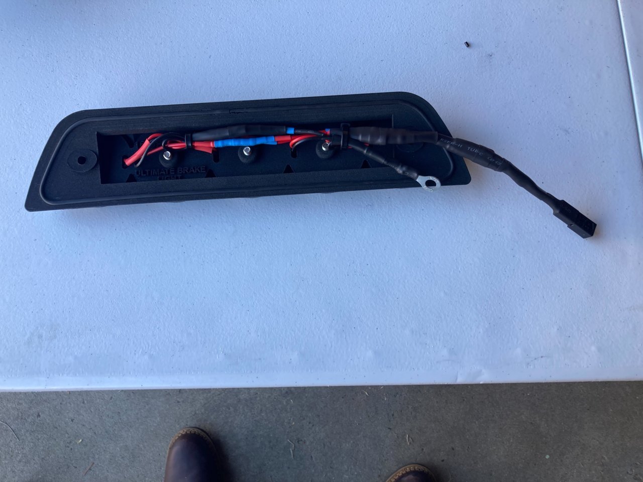

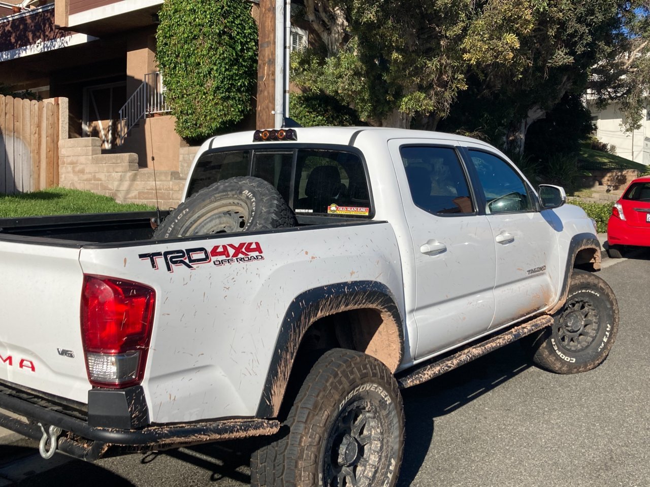

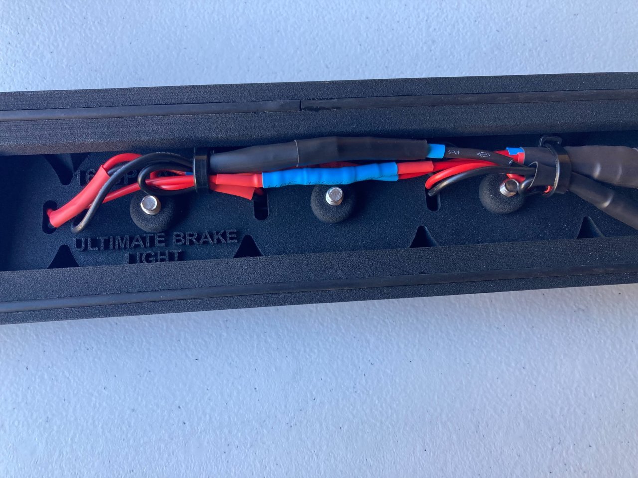

    IMG_2271.jpg IMG_2272 (002).jpg IMG_2269.jpg IMG_2270.jpg I finally got to installing mine this weekend. it didn't go in as smoothly as I was hoping, but I got it in. The holes didn't line up so I drilled out the MESO light just enough to straighten out the bolts to line up with the truck holes.
    I was able to unbolt the factory light by only undoing part of the headliner, I just removed the two hanger clips and that gave me enough room to stick a deep 10mm and a ratchet in the gap. Also V2 cyclones fit the mount fine.
