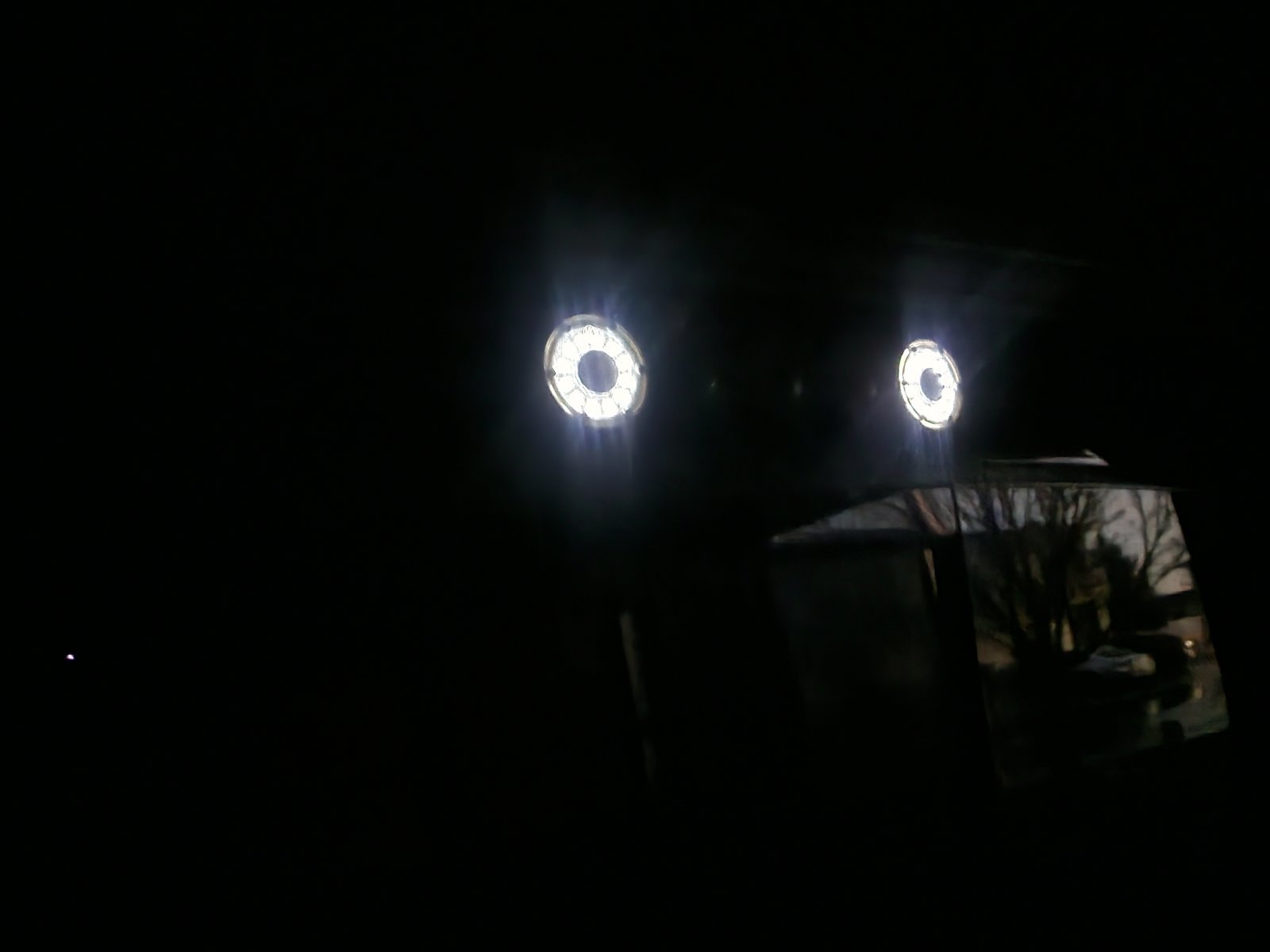

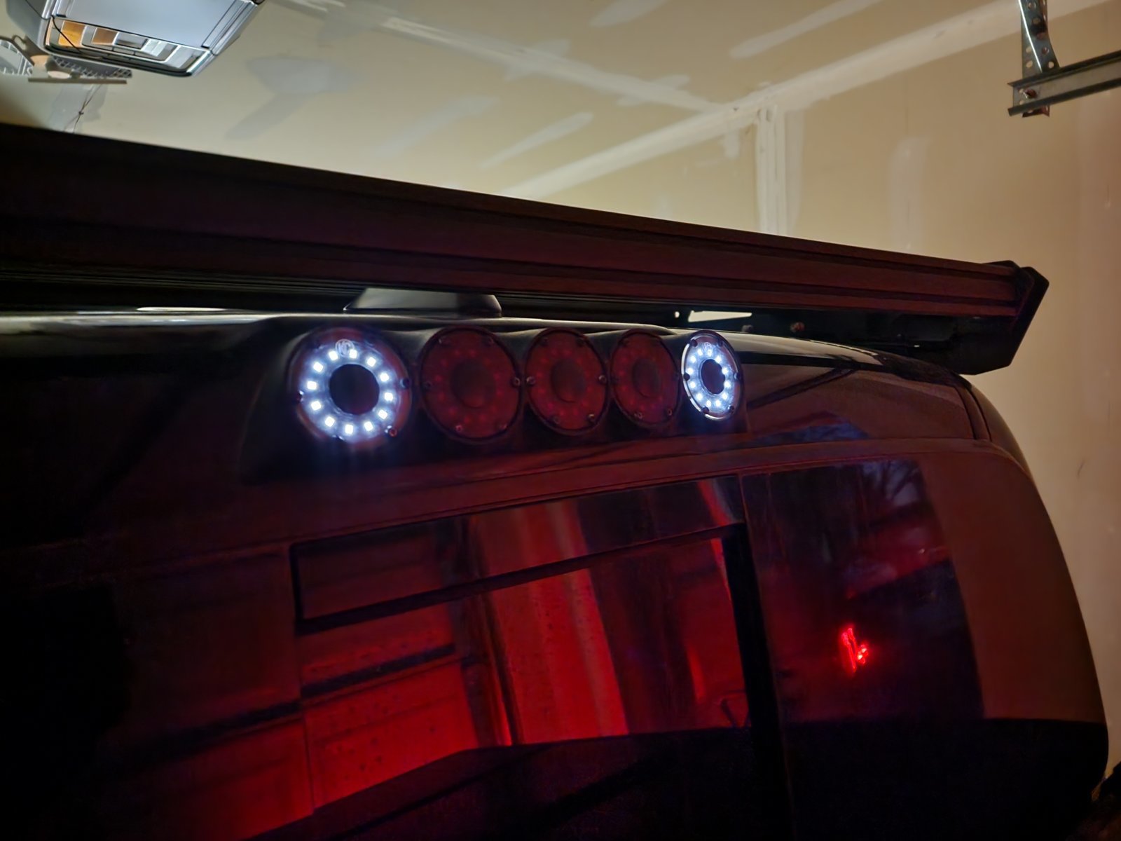

    I read the thread. The link you had provided. My switch may have gone bad. My switch door and on position functions as it suppose to, but the off position only dims the light and not completely turns it off. So I will get another switch and see if that solves the problem.

    I'd also had disconnected the switch and the result was the cargo lights stayed on dim.

    Makes me think it may be a grounding problem?

    I don't know...it could be a grounding problem, but I never had this problem before and I had this mod for years now. I'd checked the seal around the housing and it still looks solid.
    Not sure where to check the ground for the cargo lights.

    Ohh no...if it's a grounding issue, the negative wires for all 5 KC lights are tied together and are connected to the oem ground wire which is all behind the lights.

    I do not have a VLED bed light kit installed on my truck. But good news is, after I had gotten off work I had reinstalled the fuse for the cargo lights in the cab and it looks like everything is back to normal. I'll have to double when it gets dark to make sure the cargo lights aren't on dim. But as of right now it doesn't appear to be on with the switch set in the off position.

    I'd checked last night and early this morning and the cargo lights remained off while the truck off and the switch was in the off position. Everything had returned back to normal. I'm hoping it doesn't happen again for the next 3+ years, but I'll keep a watchful eye on it in the mean time.
