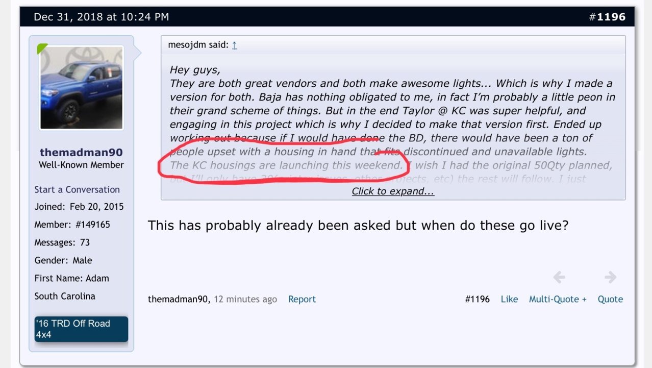

    This has probably already been asked but when do these go live?

    I was kinda hoping more for specific time and date so i can set an alarm...

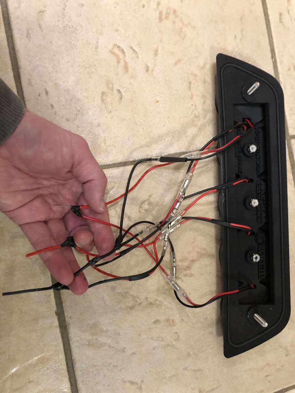

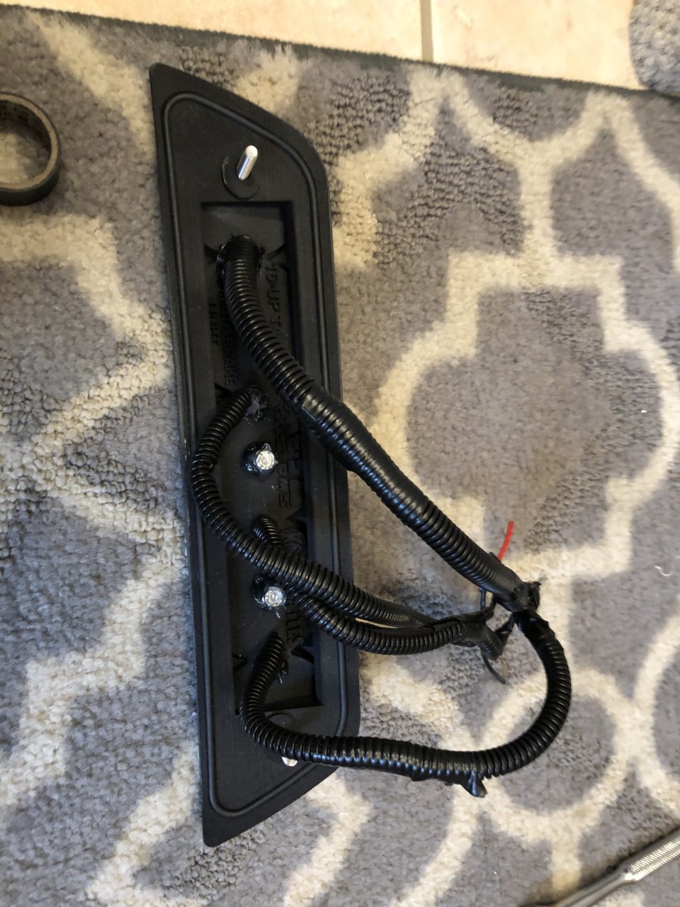

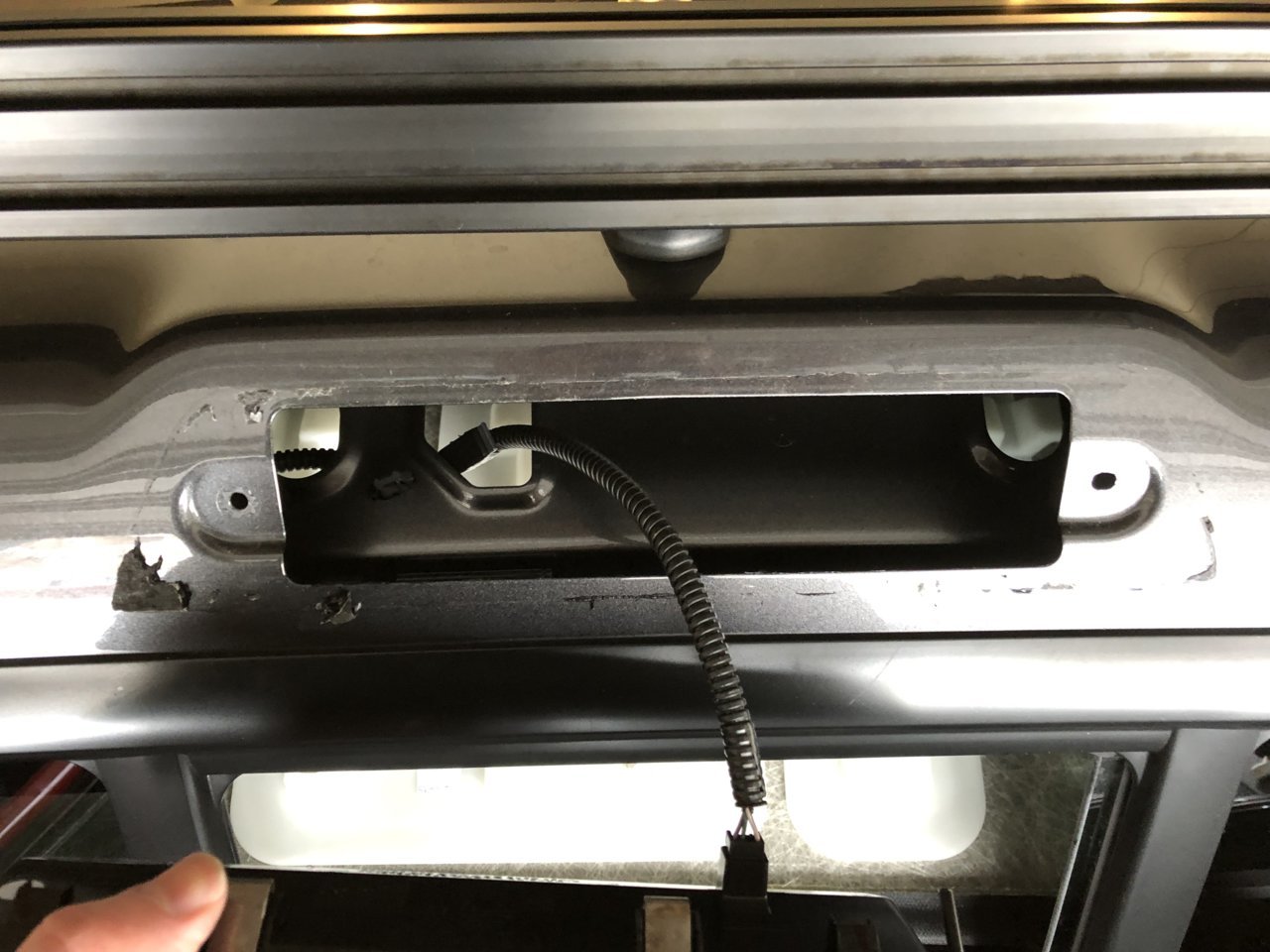

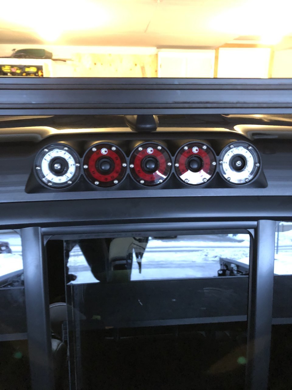

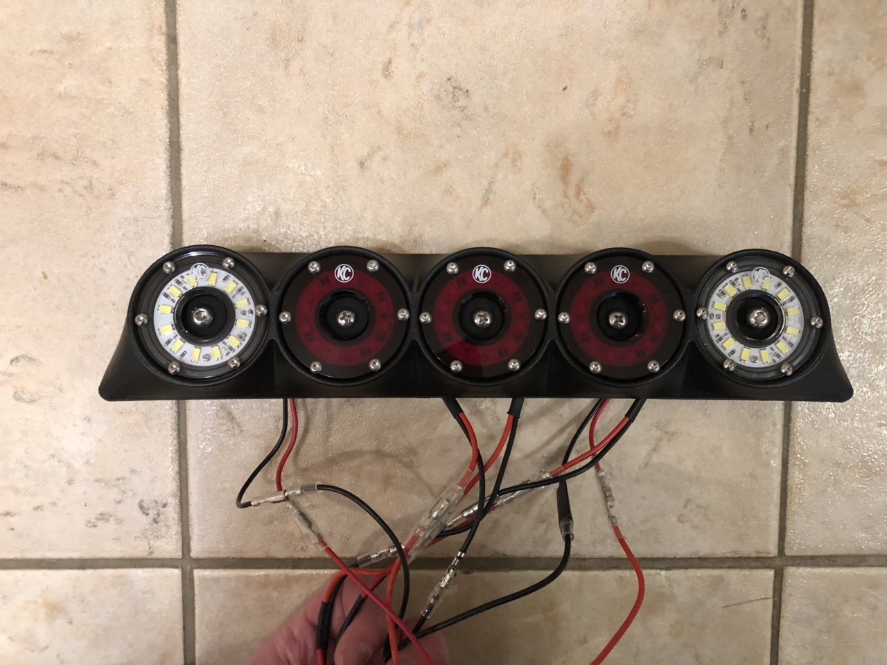

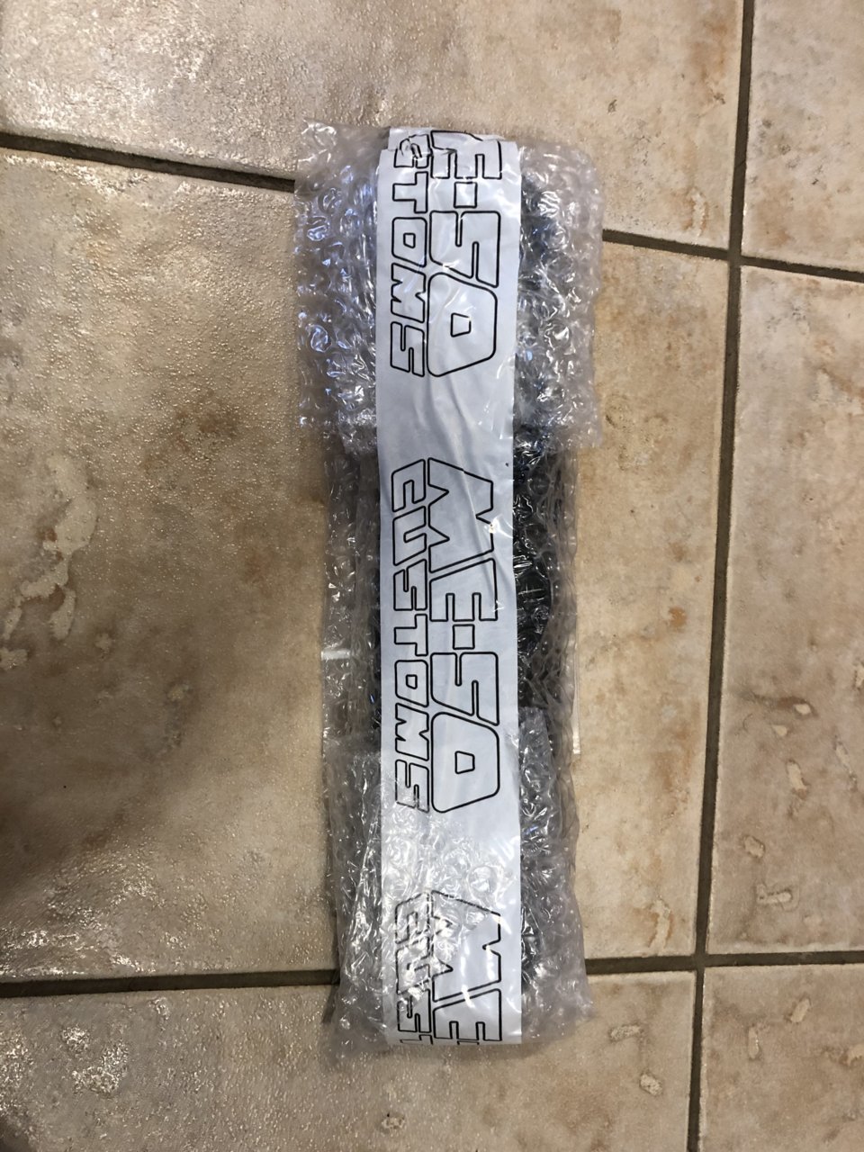

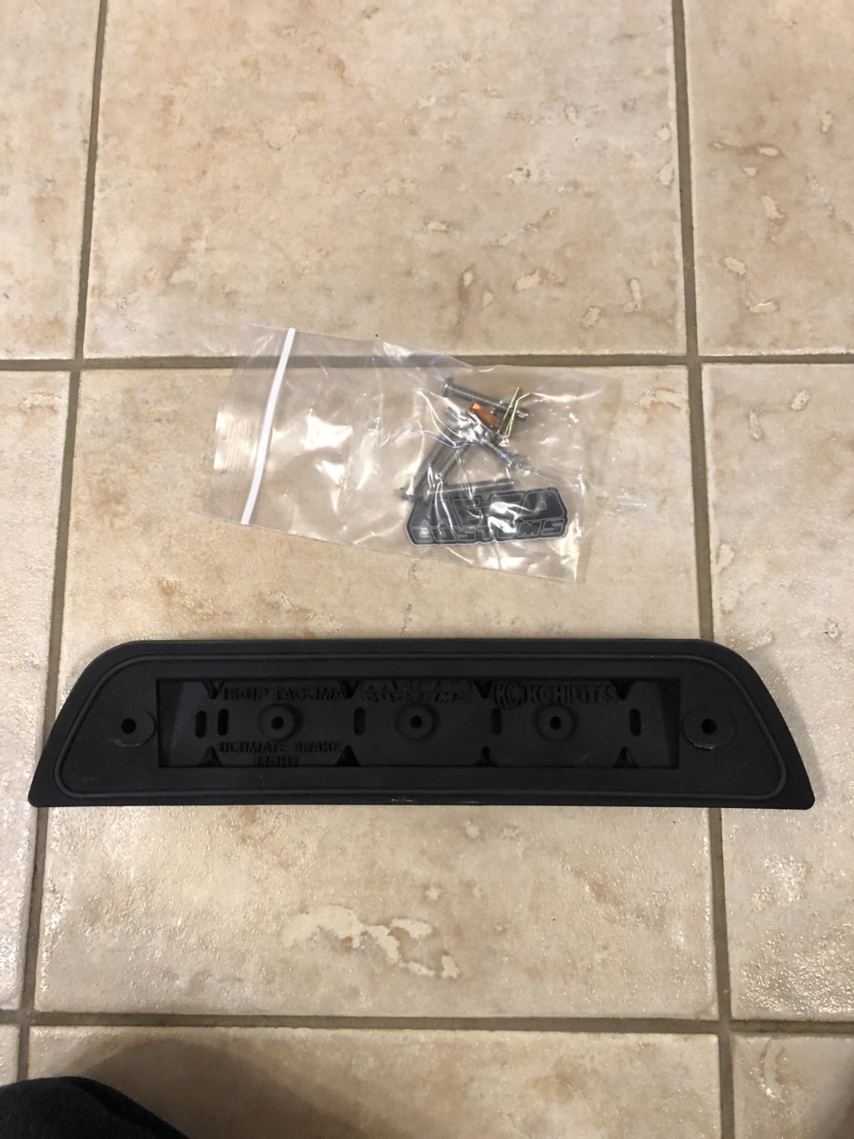

    Hi all, I thought I would share my install and thoughts on the MESO KC 3rd brake light. This has been one of my most anticipated MESO mods! To say I was excited was a huge understatement. I had to sit on it for a few days due to the holidays (sorry MESO). Fit, finish and design on this is flawless! Housing fits perfectly to the contour of the truck and the built in gasket seals up TIGHT! I went with three center brake lights and two outer cargo lights. I work pretty slow and carefully so it took me three hours to drop the headliner, install and wire up the finished housing and put headliner back up. I believe just about anyone should be able to do this with the right tools and research. Any questions feel free to ask. Like all MESO mods this is a BUY BUY BUY now! Perfection!
    1. Housing pics as it arrived
    2. Hardware necessary to mount the lights.
    I had to hit up Home Depot for some screws, washers, rubber washers, lock nuts for the three center lights. More on this later. I also bought black screw caps to hide the stainless screws.
    3. Wiring and sealing up the housing.
    I wired all the grounds up to one wire and it connects to the white/black wire. The positive from the inner brake lights connects to the purple factory wire. The positive wires from the outer cargo lights connects to green. I also sealed up everything well with silicone.

    First time doing this for me so I was learning as I go. I did a little reading up on this. A few tricks like counter clockwise turn to get the sunvisor plastic holder out. As well to get the dome light housing out you have to pinch two tabs. For the most part any second Gen Tacoma headliner removal should be close. I guess this can be optional? I dropped it and it was great for access.
    5. Factory brake light removal
    10mm wrench and two nuts removed from the inside then pulling it off and breaking the sticky gasket. Be sure to clean any residue off for a good seal!
    6. Install of wired up MESO light
    See above for how to wire to factory wiring. Outer two bolts and kit(provided) are needed here to mount housing. I used some more silicon here on the threads.
    7. Light output pics
    Light output is insane with the KC lights. Pics up shortly
