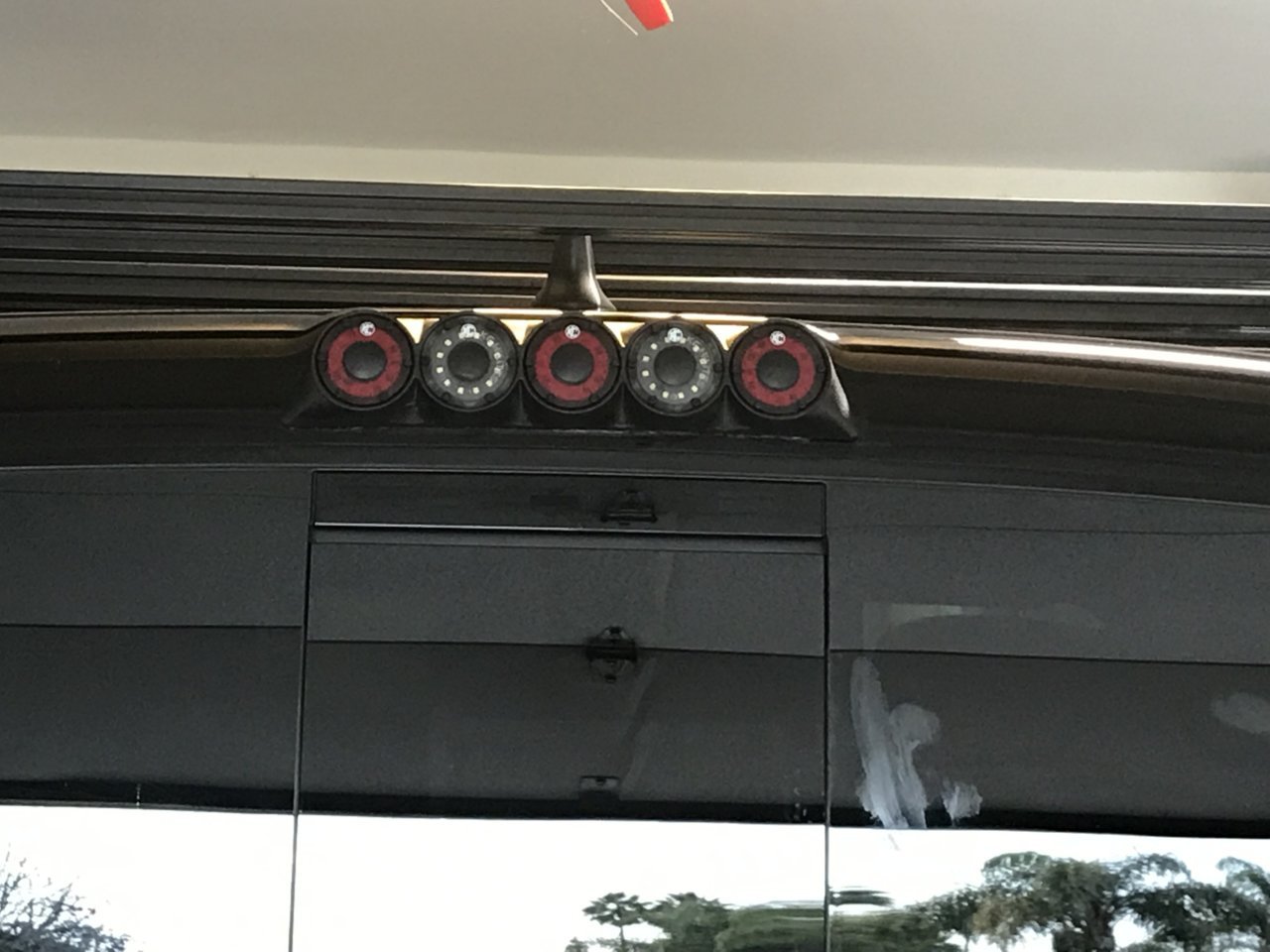

    Where did you get your black screws? And what size?

    Amazon M3 6mm

    https://www.mcmaster.com/91239a111
    I gotta give it up for McMater-Carr. They have everything, super fast shipping, and exceptional customer service.

    Not bad price at all but a 100. That’s a lot of extra.

    Plenty to replace the ones that will inevitably rust over time. Black oxide coated stuff doesn’t have great corrosion resistance.

    x2, black zinc coating will hold up much better long-term. But you're not going to find black-zinc-coated hardware just laying around the way you do with black oxide.

    You can make the screws black by heating them up to 570-750 F and drop them in olive oil, it will turn them black and give them a protective coating. (Little shop trick I learned)
