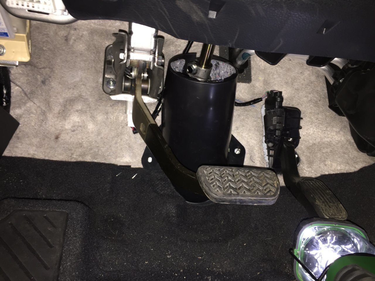

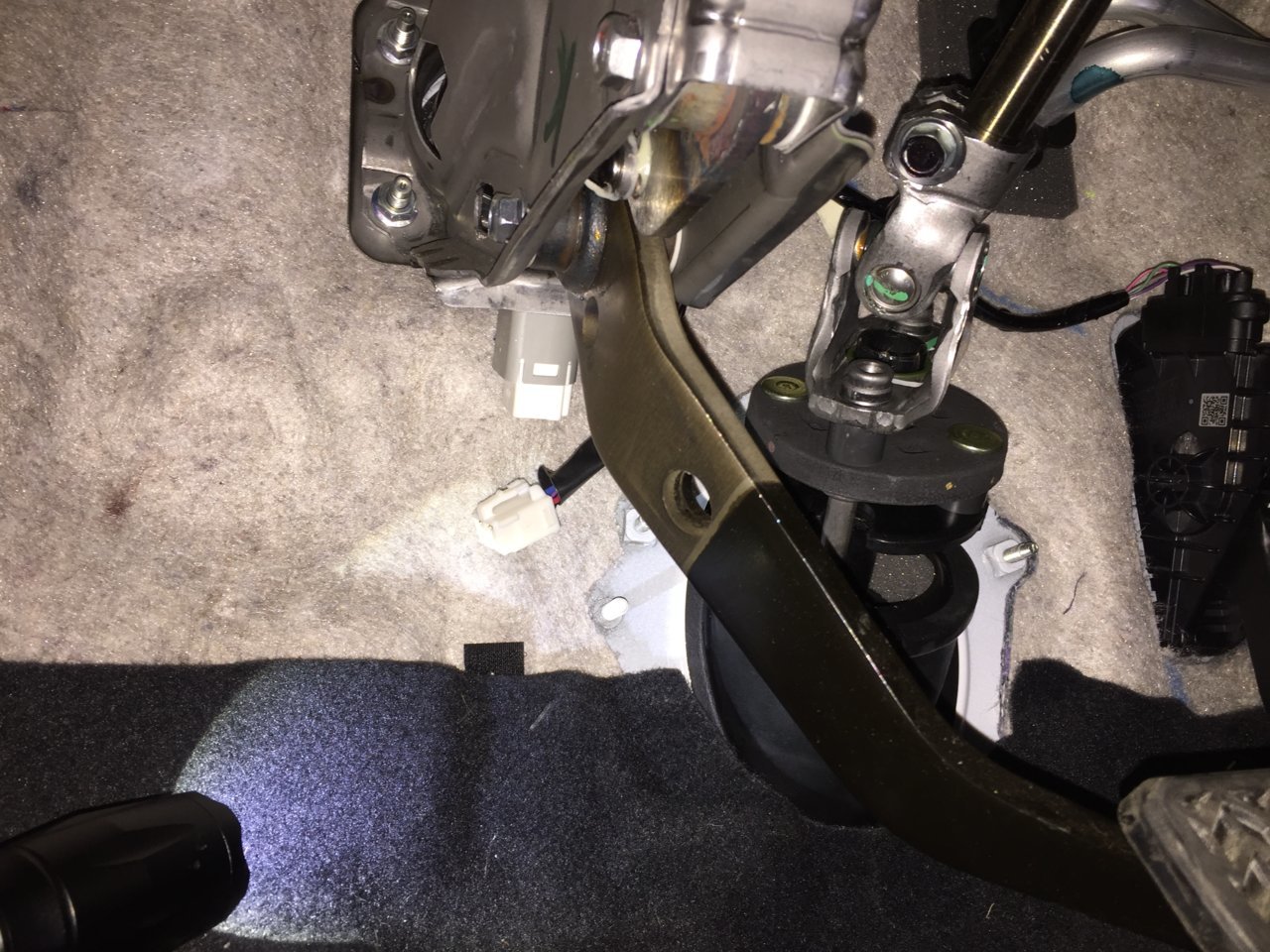

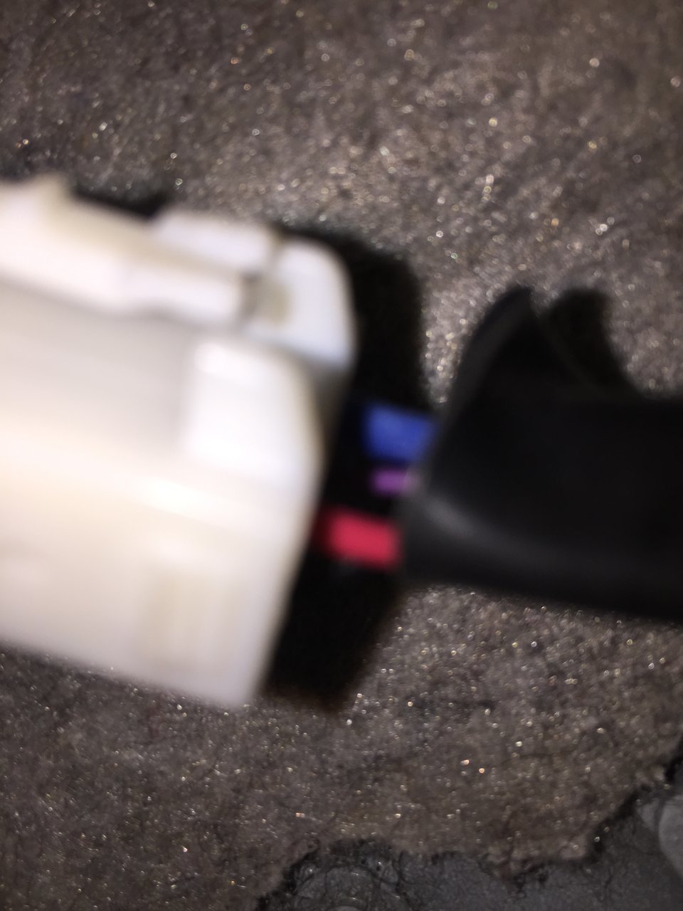

    Thanks I will. I am trying to connect it to the brake light switch harness. Off top of anyones head does anyone know which wire would be positive in this picture? Obvious choice would be red but just doubting myself and trying to avoid testing it with a Volt meter. It is real cramped down there.

    Curious why you are trying to connect it at the brake pedal and not at the harness in the roof?

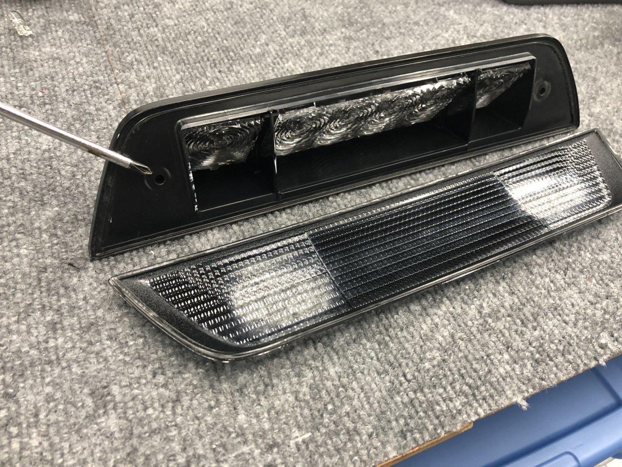

    My factory light is all stress cracked, sealed with silicone & not worth saving. @mesojdm, do I remember correctly you saying we could just sacfrice the old light and install everything from the outside?

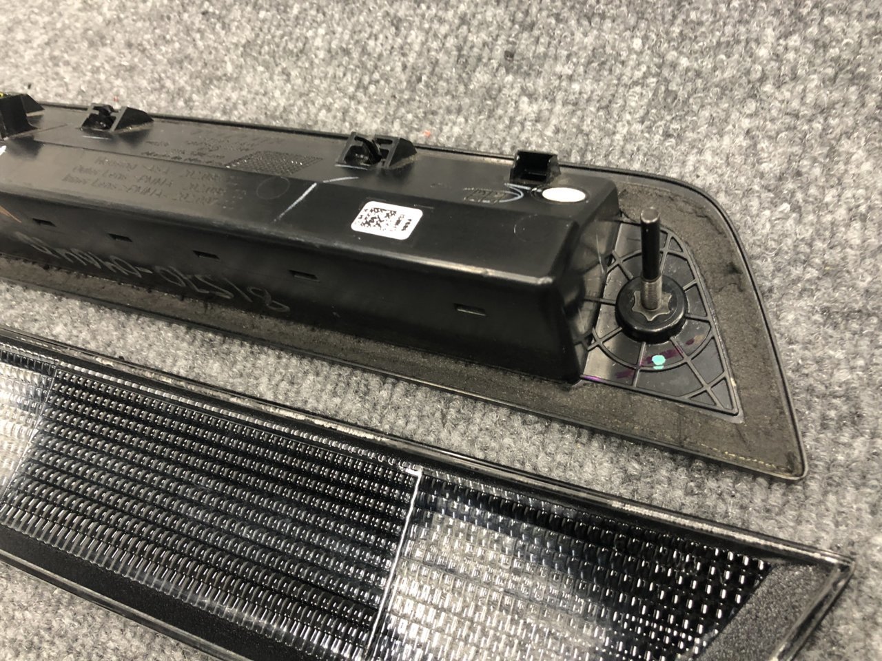

    Yup! If you don’t mind sacrificing the stock brake light it would make life much easier. If you are going to do it this way: Pry the stock lens off(screwdriver, flat blade, etc) it is epoxyed around the edge so it won’t give up too easy. After it’s off all you have to do is drill out these 2 holes. Go slow and check as you go. Right behind the plastic is the posts holding the stock light in. Once they are free the light can be removed and swapped out:) here’s some pics
