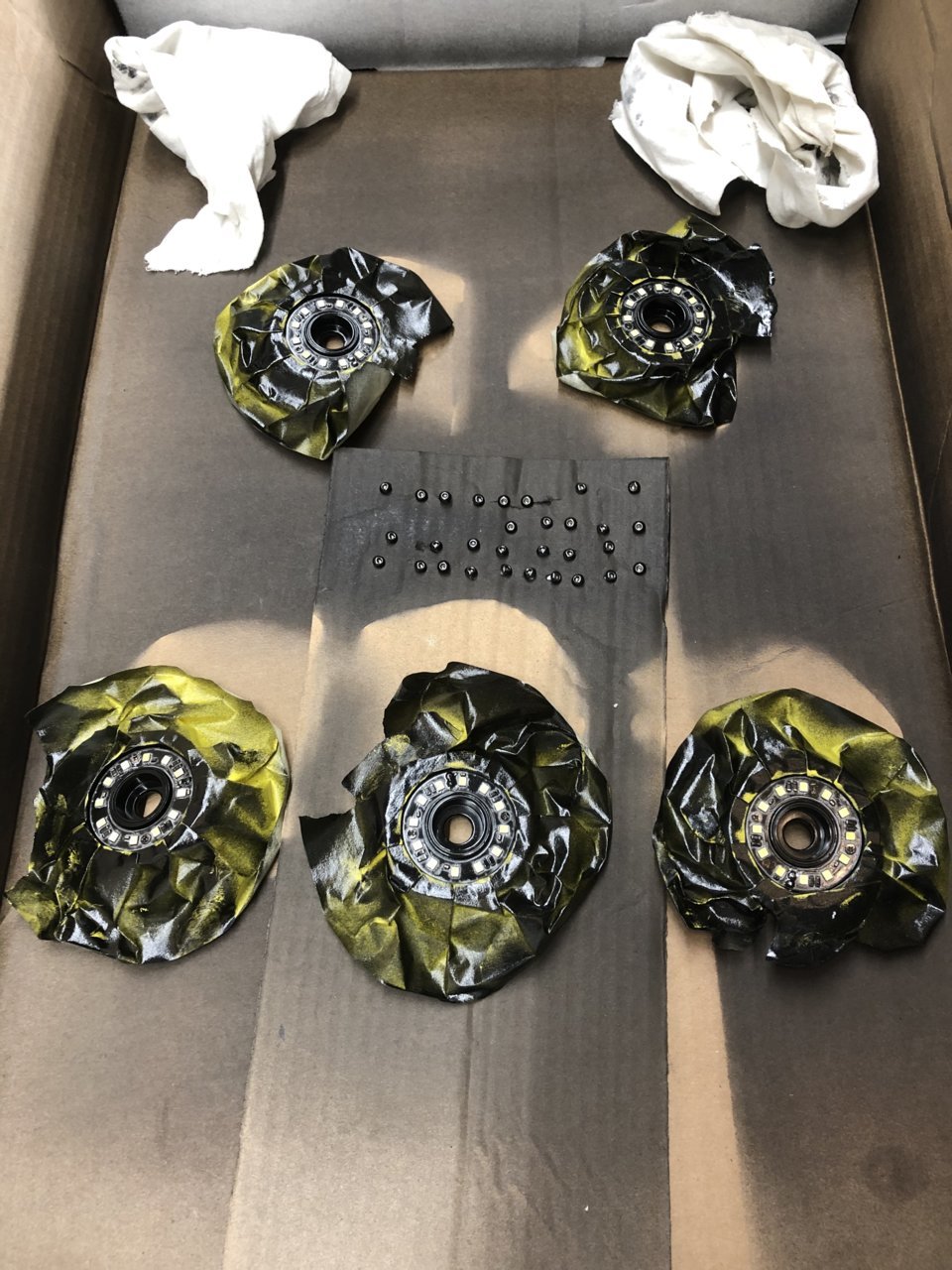

    What did you use to cover the individual led elements....little pieces of tape??
    Seems like it would take forever to do that but looks good!

    Spray paint the whole thing. Even over the LEDs. Then as the paint is wet, take a rag with paint thinner and wipe the top of each LED. Way quicker, and I've done this method multiple times with no side effects.

    I sprayed the entire board. Then used a rag soaked in acetone to wipe off the LEDs before the paint dried. They look a sight better blacked out.
